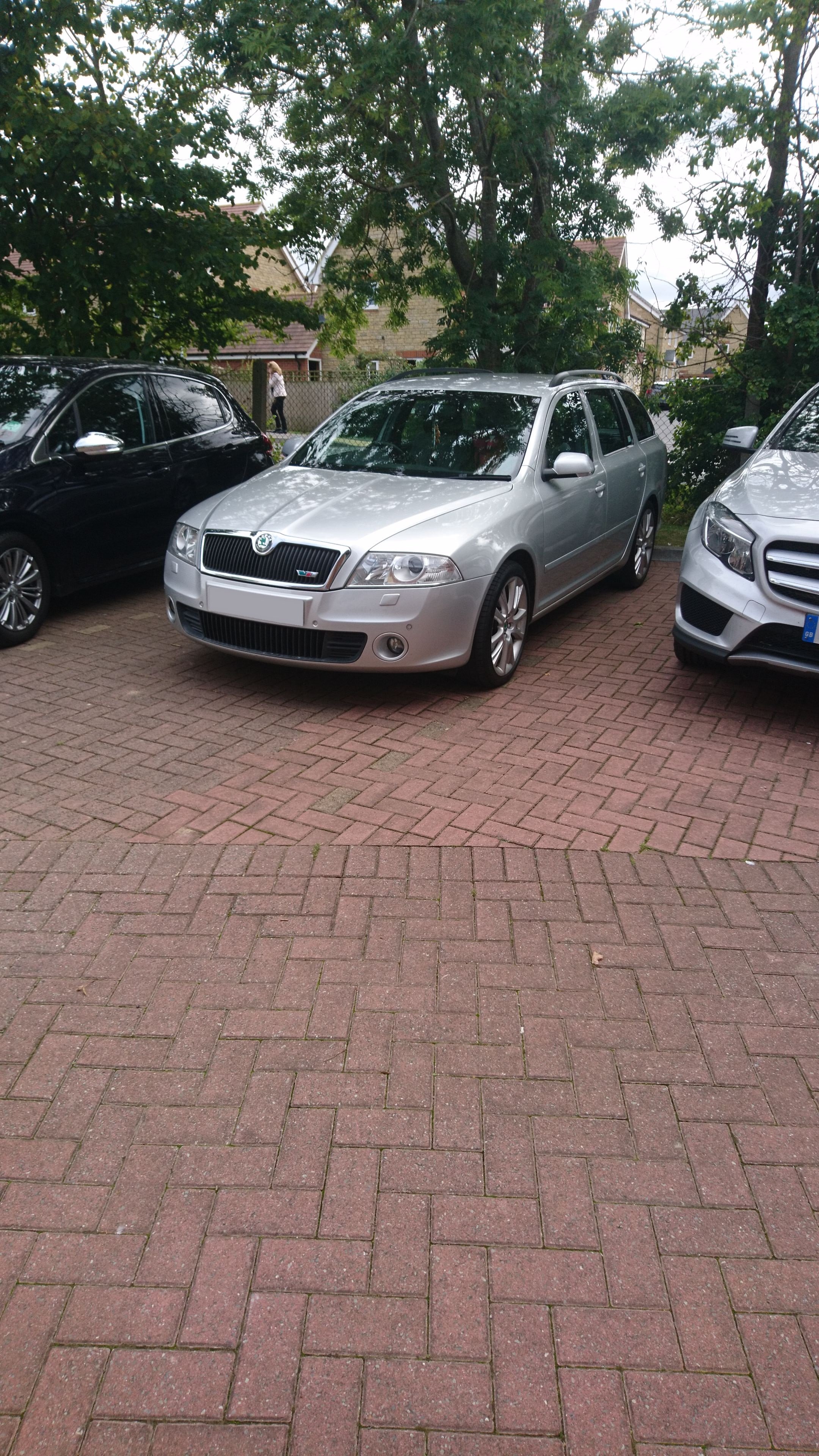

Evening all,
I am happy to report the VRS is back in my possession and running great.  A noticeable improvement, fingers crossed for plain sailing!  :happy:
