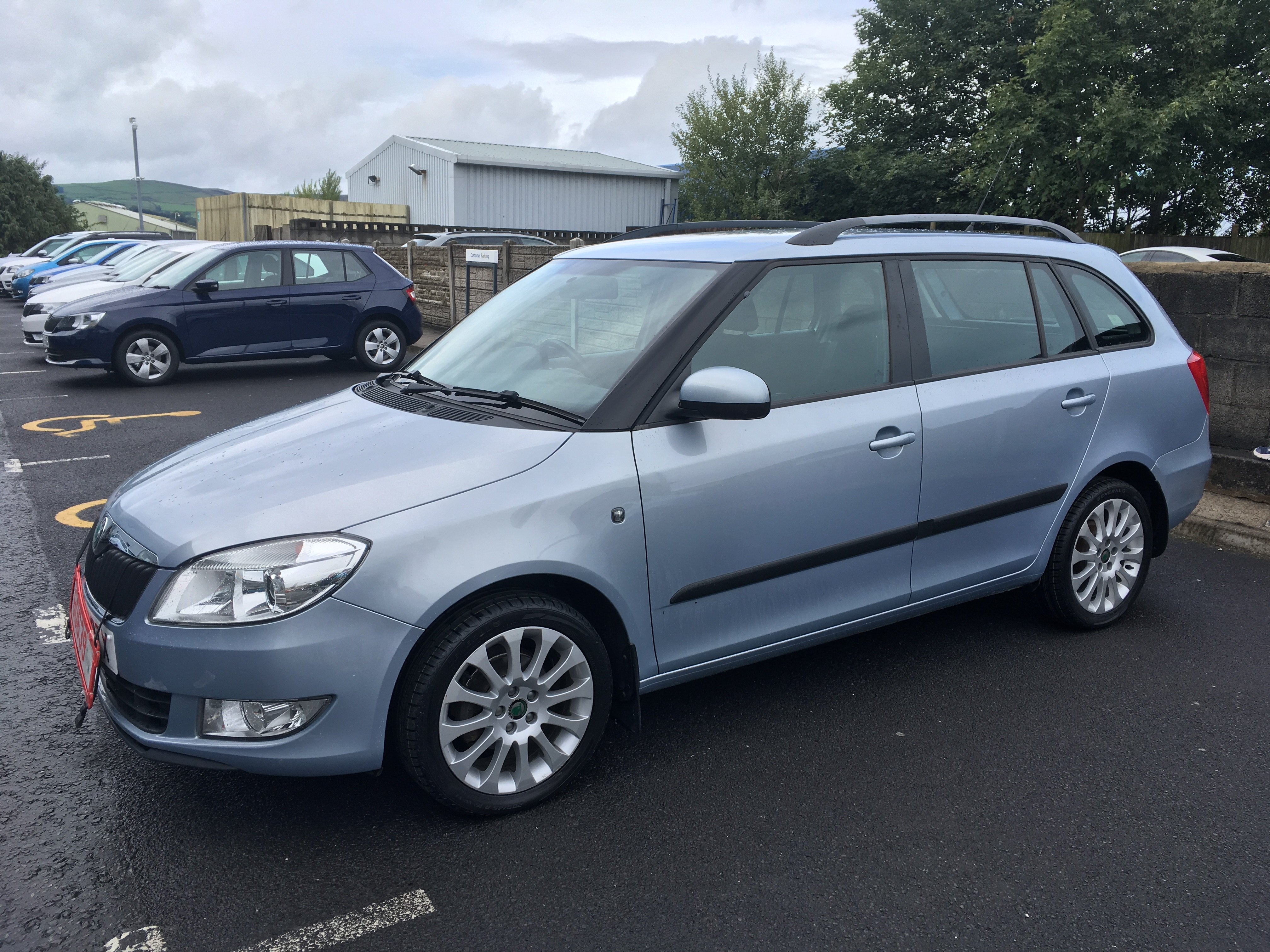

Drove a 12 plate 70bhp 1.2 HTP estate today and was pleasantly surprised by the engine.  Seemed to have enough poke around a few Sheffield hills I tried it up.
Won't be following up though.  Despite FSH it just seemed a little battered around the edges for me, maybe i'm expecting too much for something at 6 years old.
I'd like to try a 1.2 TSI though as I expect it to really have more oomph.  So will continue to keep an eye out.

After the acceptable, but not very exciting performance of the 1.2 HTP engine in the estate I drove last week I was smiling yesterday whilst test driving a 1.2 TSI.
This car was night and day from the HTP.  Everything about it was on a different level; engine, condition etc
I enjoyed driving it that much i'm taking delivery of said 11 plate 1.2 TSI Elegance in a week or so. Has main dealer FSH with everything at the right time (year/10k), 55k on the clock.
I took the advice of the board of buying based on condition and history.  It ticked the boxes on both fronts.  As well as being elegance and having those rear parking sensors etc.
