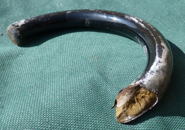

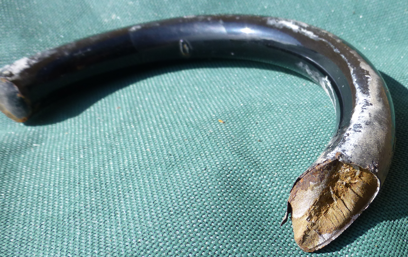

And right enough, another item to add to the extensive list of broken parts on my Superb - this time a coil spring (remains found on the ground shown below).
Which coil spring it is, is a mystery as examining all four coils shows no obvious damage and the car is not listing in any particular direction.

Found myself under the car this morning looking for carnage. Took me ages to spot anything wrong at all as all seemed OK, same number of coils per side and it drove fine. Clearly the snapped piece of spring is long gone but I felt one of the ends of a rear spring is "sharp and jagged" and the other has a machined smooth finish. Spring seems to be reasonably seated so OK to drive  - but I'll get fixed this week anyway.

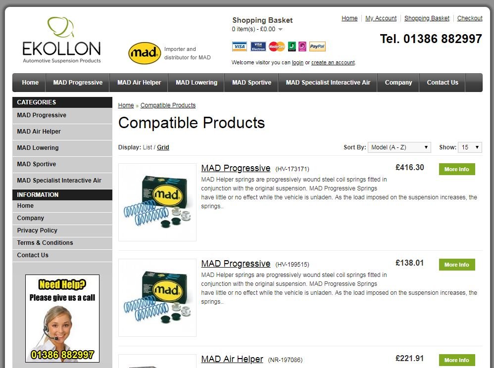

I've heard good things about these guys...
http://mad-suspension.co.uk/
A lot of Octavia owners have beefed up their rear suspension, especially those that tow. They offer components for the Superb too...
