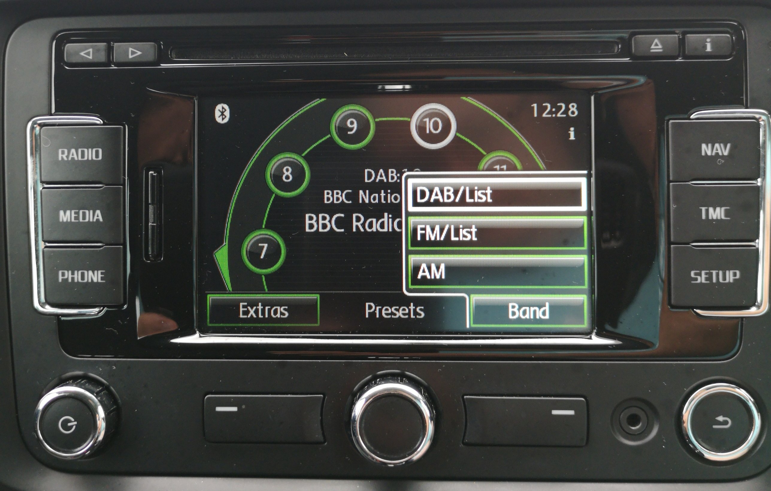

This is what's fitted to my car......
I ve had both the Amundsen and the Colombus and the the DAB was very good on both units

The unit in my earlier post was the original, fitted to my current car (2014 Yeti). I'd previously had an early (2009) Yeti, which came with the Bolero as standard.
I understand the unit in my car is an Amundsen (? RNS 315). It has DAB, Bluetoothand, sat-nav and interfaces well with the maxi-dot (display between the dash clocks). The screen is pretty small by modern standards, but I've found it to work well over the years.
I've never removed the stereo from a Yeti, but understand you clip off the black plastic surround and this reveals the screws, removal of which enables the unit to be removed.
