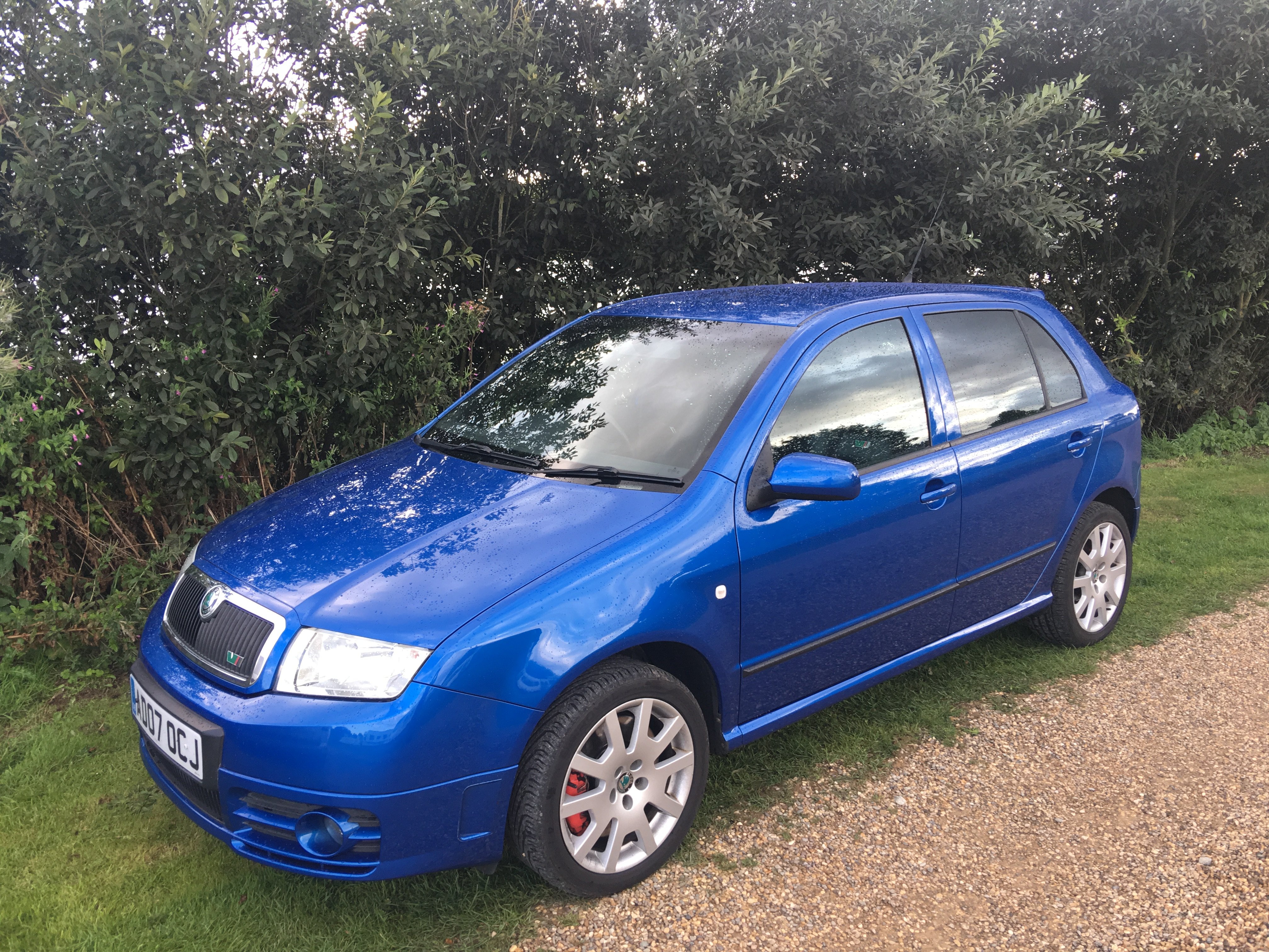

I’ve just bought a Fabia Vrs SE I just wanted to know what the best mods are to start with to get power up thanks
What sort of power are you after? Stage 1 map will take it to 170-180Bhp with no other mods.
Do I need to anything else to it to get it to 180
Basically NO
But to keep the sooty boot at bay and help better air fuel mix, a PD160 intake with wider connection hose from cone to airbox along with a panel filter will help.
Taking the BHP to 180 would strongly recommend front dIsc brake upgrade - the 312mm from a mk1 Octy vrs fits straight on.
