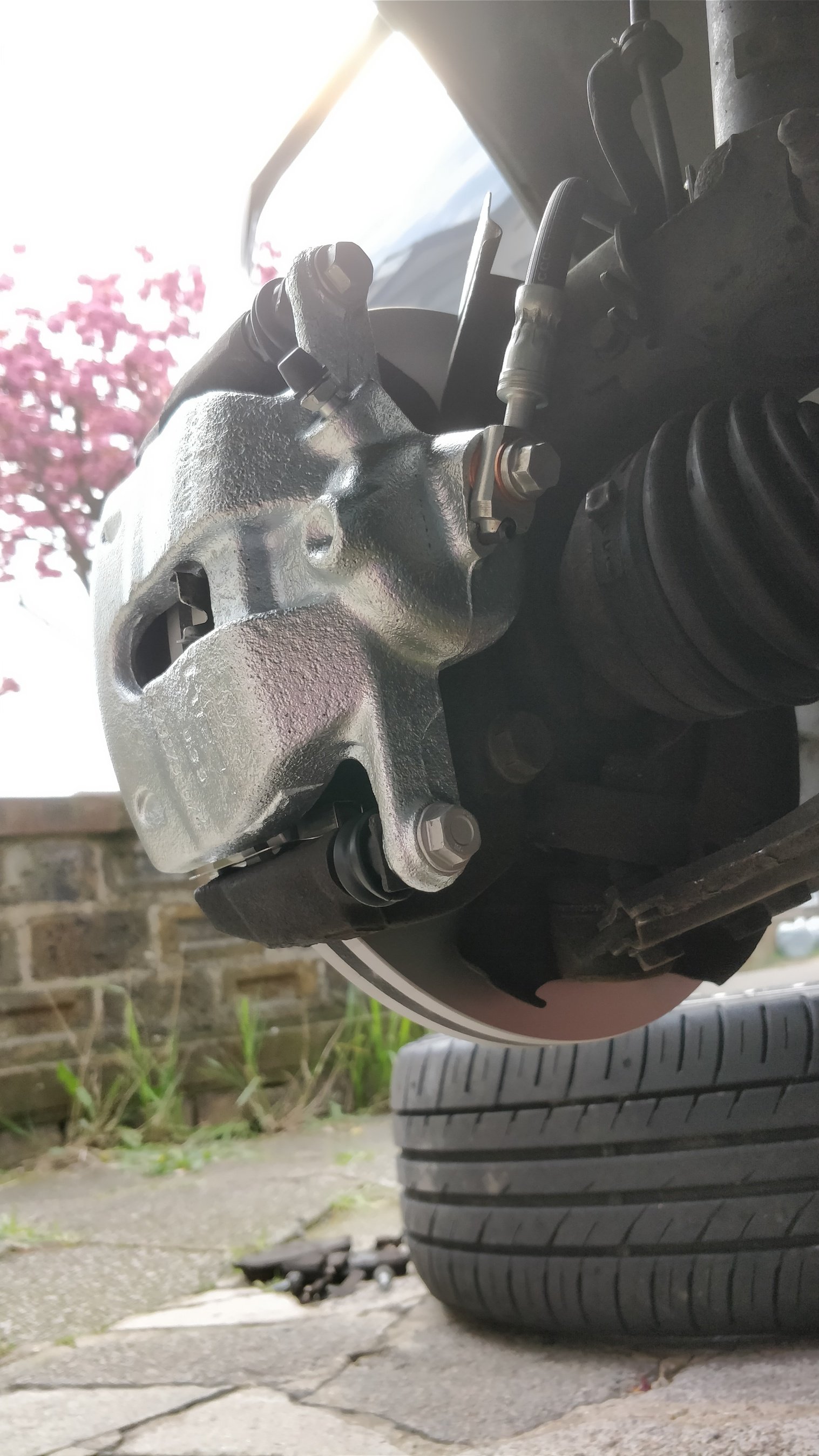

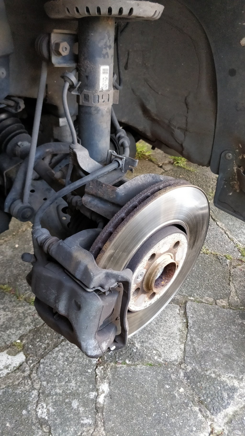

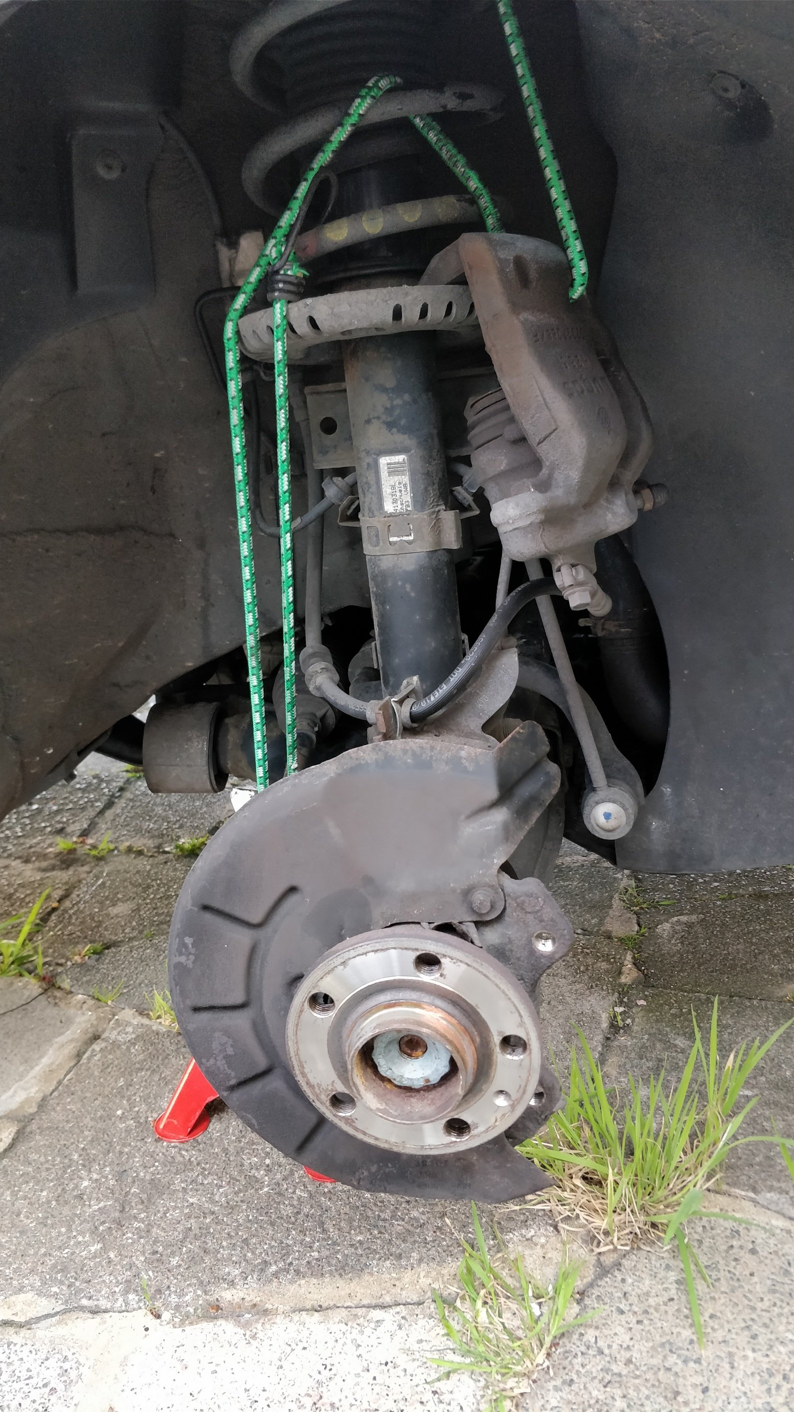

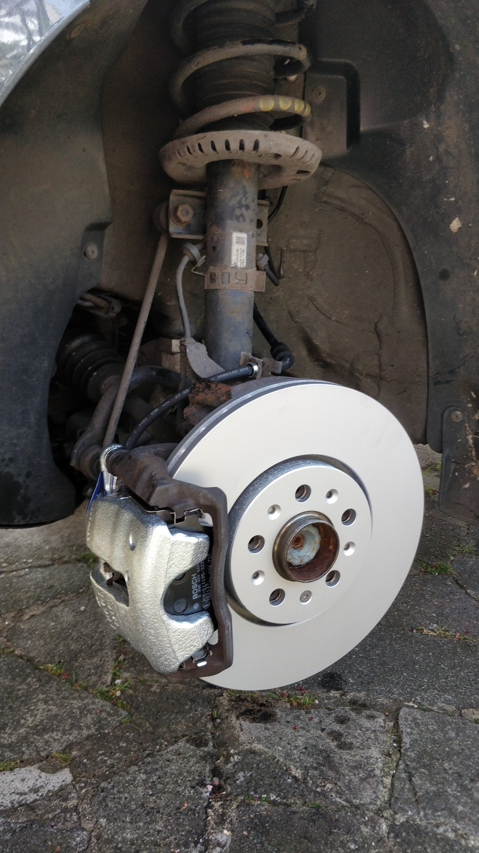

Changed my front discs and callipers on a 288mm lucas setup. Got them from Eurocarparts. I used Bosch disc, I like the fact they have a silver covering and not oil that needs wiping off. It means no rust forms on the still covered rest of the disc.
I changed both front hoses at the same time. The copper washer on the brake hose is not meant to be reused, but they don't remove from the vw hoses. So I solved that issue with 2 new hoses. I bet you could just bolt the old hose back on or cut the old washer off and find washers to fit. But 2 hoses are so cheap I took that route.
No problems in the complete swap, but one bleeds with an 11mm and the other 10mm spanner. Didn't make much difference, but still odd I now have this one 10mm bleed nipple.
