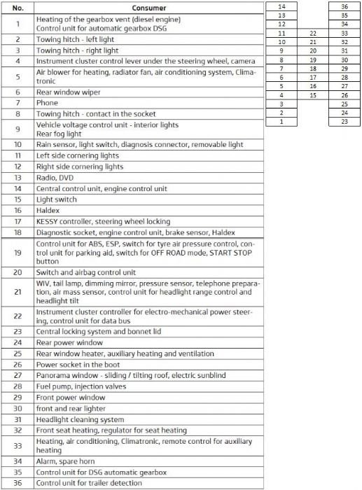

Does anybody know which fuse would have to be blown to stop the keyfobs working as I am not familiar with the Yeti model?
Also where is the OBDII port and the fuseboxes on a Yeti?
Fuse box can be seen on the A pillar when drivers door is open, slot at bottom to get a key or screwdriver in to pry the cover off.
OBD port is in front of your right knee.
This is the correct orientation of the fuses, they are upside-down in the manual.
Edited by Urrell
Thanks for the info Urrell. I will wait and see what VCDS reports tomorrow.
