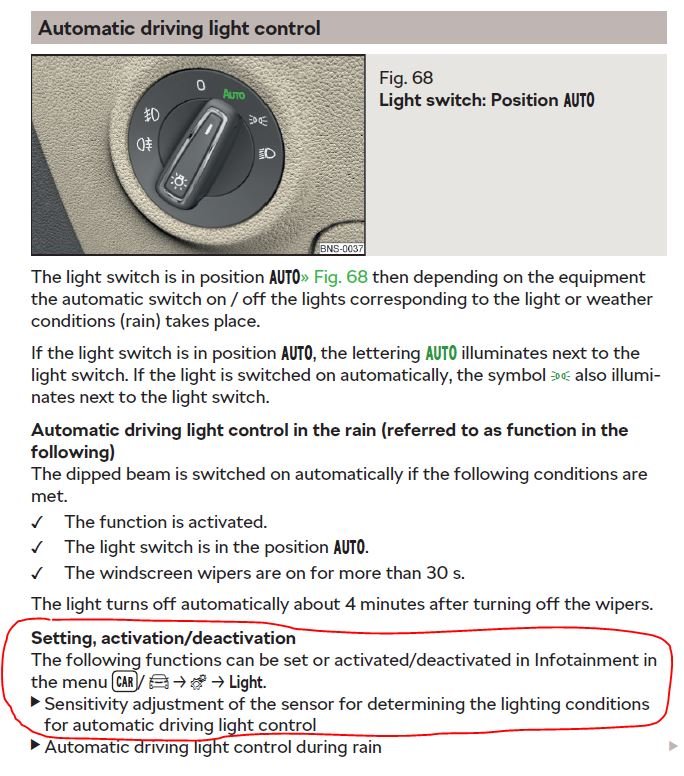

In the infotainment unit, under Car > Settings > Lights, you can change a setting that supposedly does what you want... to some small extent. It can be set to normal (by default), or 'early' (turn the lights on sooner, i.e. when it's only a bit darker), or 'later' (i.e. when it's a lot darker).

I haven’t got high beam assist but I do have the early, normal, late menu option and it changes how soon or late the headlights switch on when selected to auto on mine. When I checked mine after collection it was selected to early.

Well I've selected late so I'll see if it makes a difference on my way home later. Can't say I noticed a difference with the auto main beam this morning.
It doesn't affect the 'auto main beam', only the dipped headlights in Auto mode.
