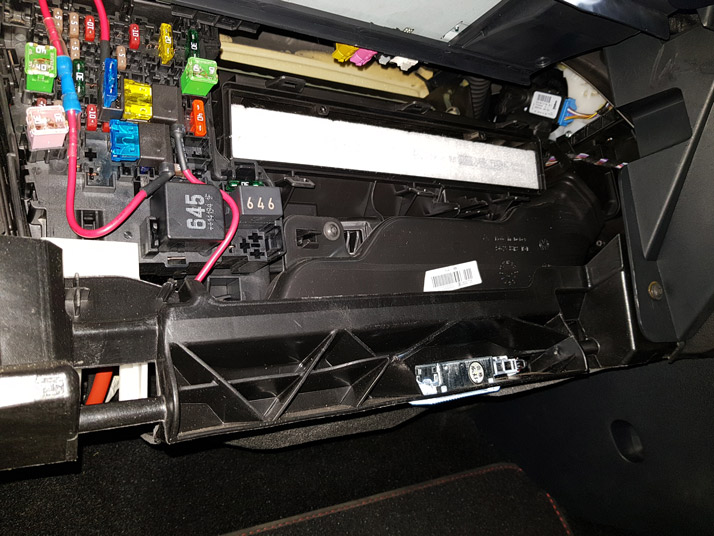

JohnnyType2 which fuses you used for wires as im aware there is two live needed for magic pro!?Permanent live (red wire)which fuse you used for that and (yellow wire)can be used as Black sheep advise from rear wiper!?Thanks

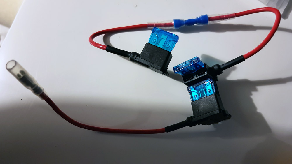

I cant remember the exact location but i have combines the 12v lighter mod to have the sockets switched and also connected the tail to the PMP supply. I used piggy backs which allow the installation of another source and give an extra output.
i think it was position 40 and 48, you can use a multi meter to test any empty fuse plug in the fuse box and use those.
the tail from the Yellow piggyback is running to the PMP as the permanent source.

40 and 48 are the locations for switched and permanent live
