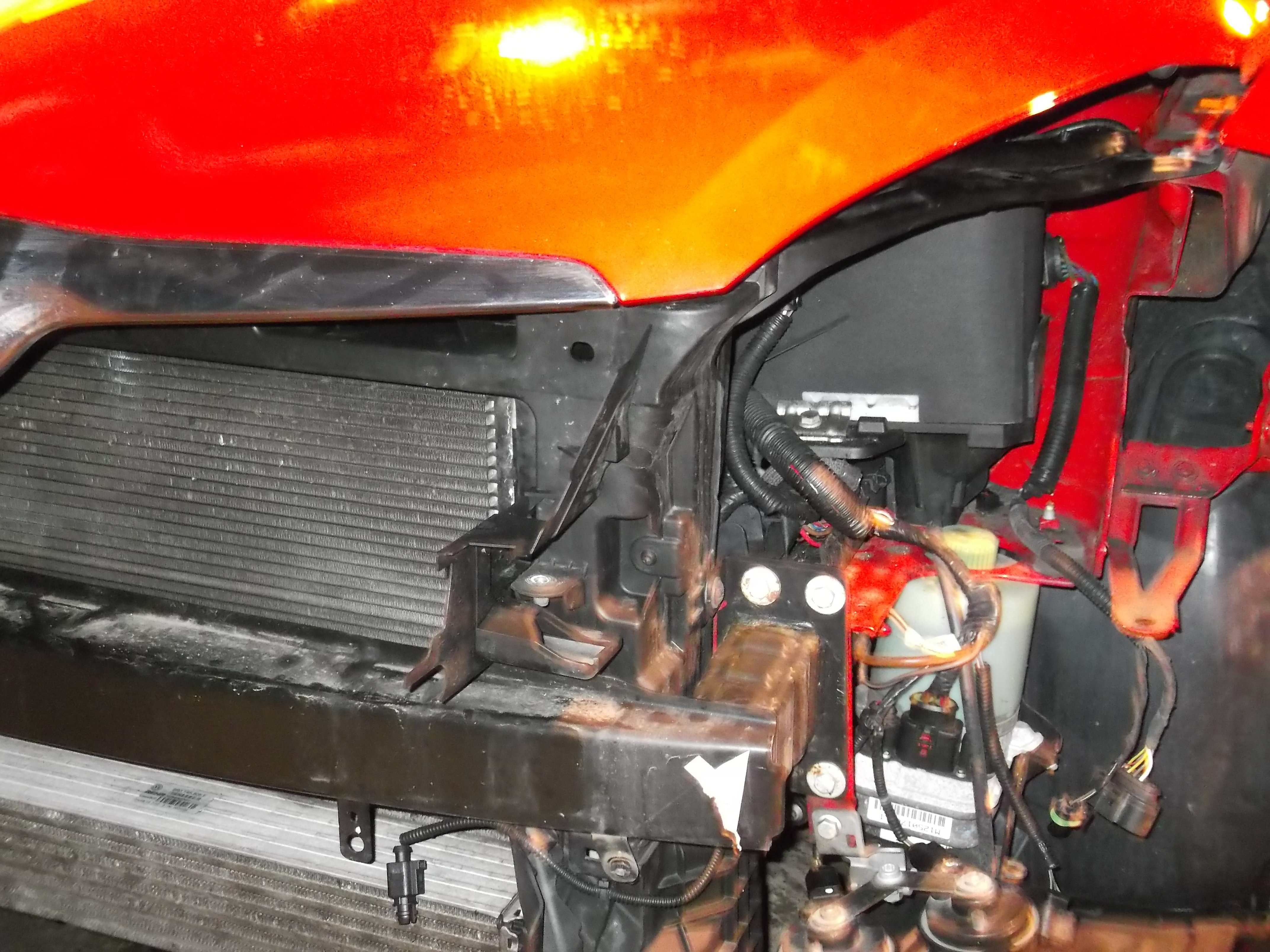

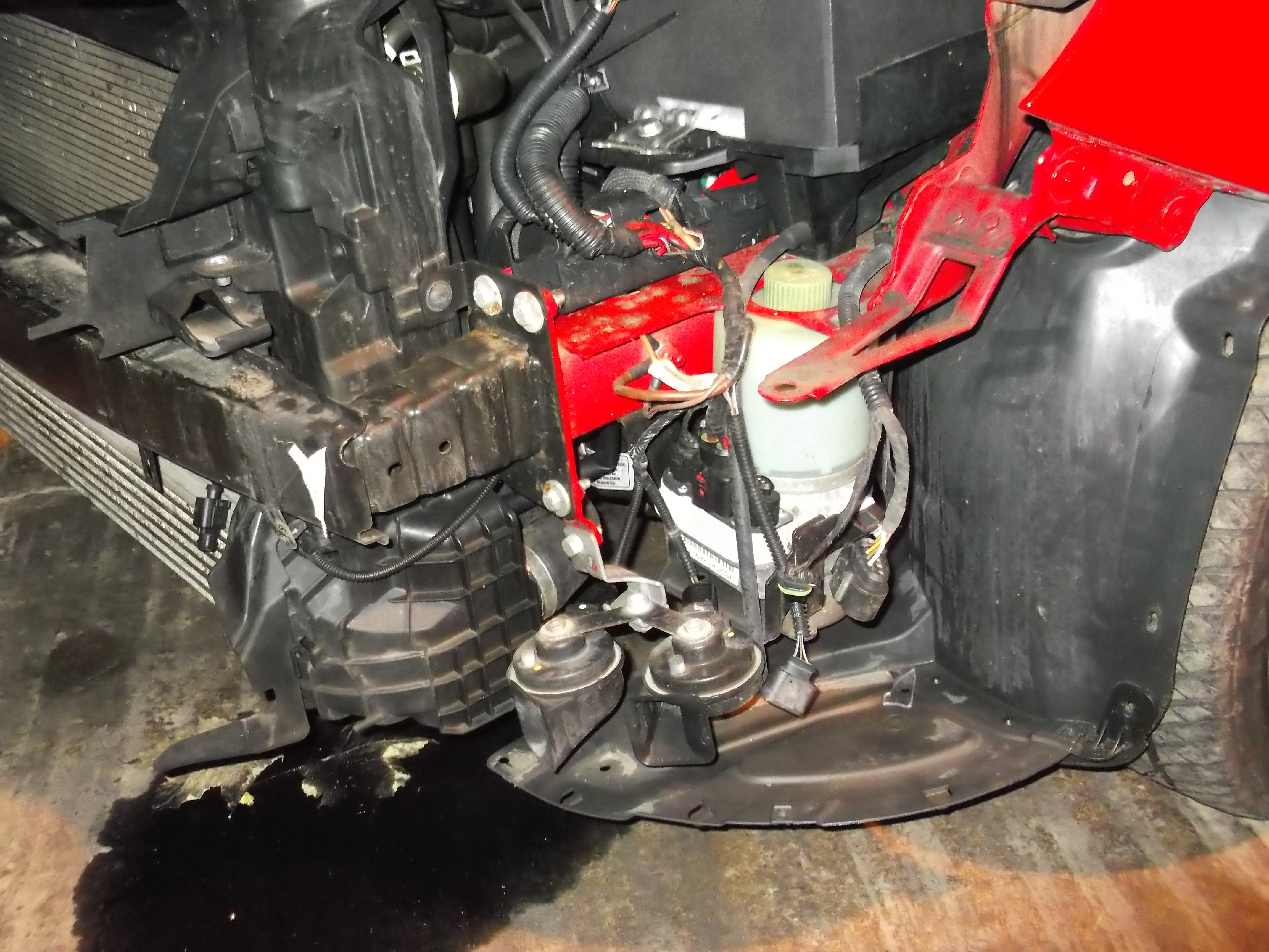

This was at about 5-10 mph and minor external damage across the front, until stripped. See the front legs, and cross member that you will be replacing.
Edited by Offski
