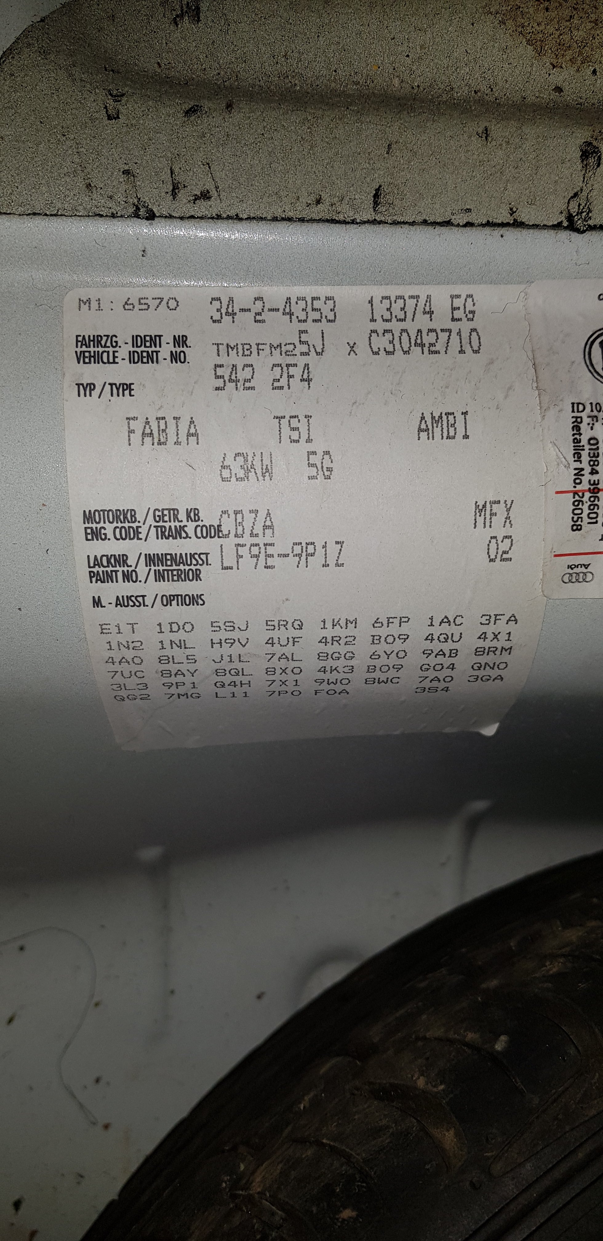

CBZ 505235

5 hours ago, Tech1e said:
Should say
CBZA
CBZB
CBZC
On the engine timing chain cover.
13 minutes ago, conorhayes13 said:
Never mind... answered my own question lol
Yeah that’s the lowest power.
63 kilowatts (86 PS; 84 bhp) @ 4,800 rpm; 160 newton metres (118 lbf⋅ft) @ 1,500-3,500 rpm — CBZA
66 kilowatts (90 PS; 89 bhp) @ 4,500 rpm; 160 newton metres (118 lbf⋅ft) @ 1,500-3,500 rpm — CBZC
77 kilowatts (105 PS; 103 bhp) @ 5,000 rpm; 175 newton metres (129 lbf⋅ft) @ 1,550-4,100 rpm — CBZB
