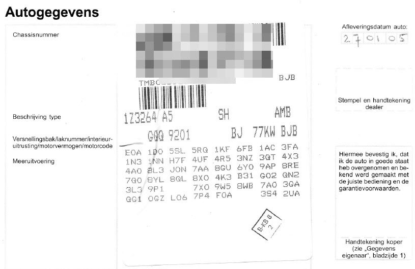

On 17/09/2018 at 11:07, xman said:
Afaik 1.9 TDI never had long life/variable regime. Earliest were the 2.0tdi.
My 2005 1.9 TDI O2 has a long life interval. ( QG1 is listed on the options list), thus requires 507.00 oil.
Maybe there is a difference between mainland Europe (LHD) and UK models?
Edited by DJSmiley
