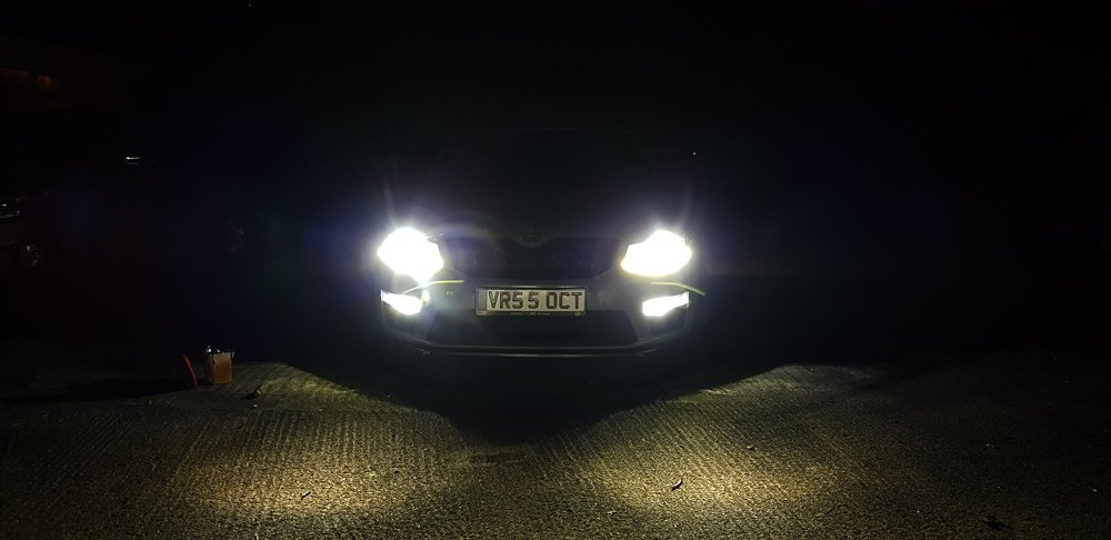

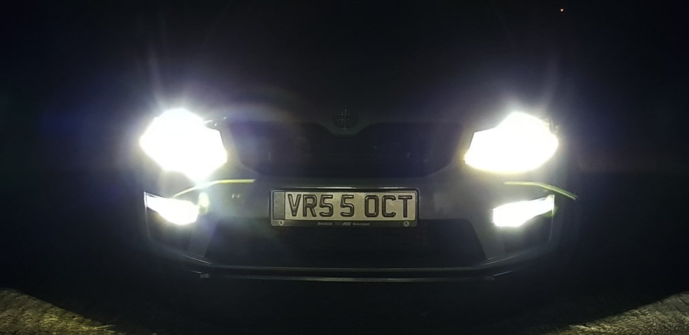

ive tested the bulbs ive bought which are 4300K and 4500K, the 4300K are the same colour temp as normal halogens and the 4500K ones match the DRL and HIDs

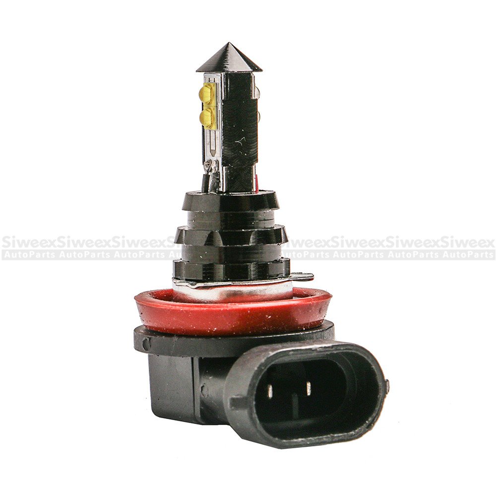

this one was the best colour match for the vRS these are a straight swap no modification needed, H11 will fit H16 snuggly,  The LEDs are at the same height as the filament in the original bulb. the warmer white was brighter as it has the projector but the colour would be better suited to a car with halogens headlights. Ive got a few sets on ebay can be posted next day PM me for a link. No errors and there is a dimming function with these as they are designed to run as DRLs as well if you need them

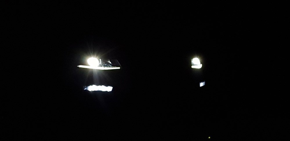

the image below ive turned contast up and brightness down so you can compare the colour to the headlight.
