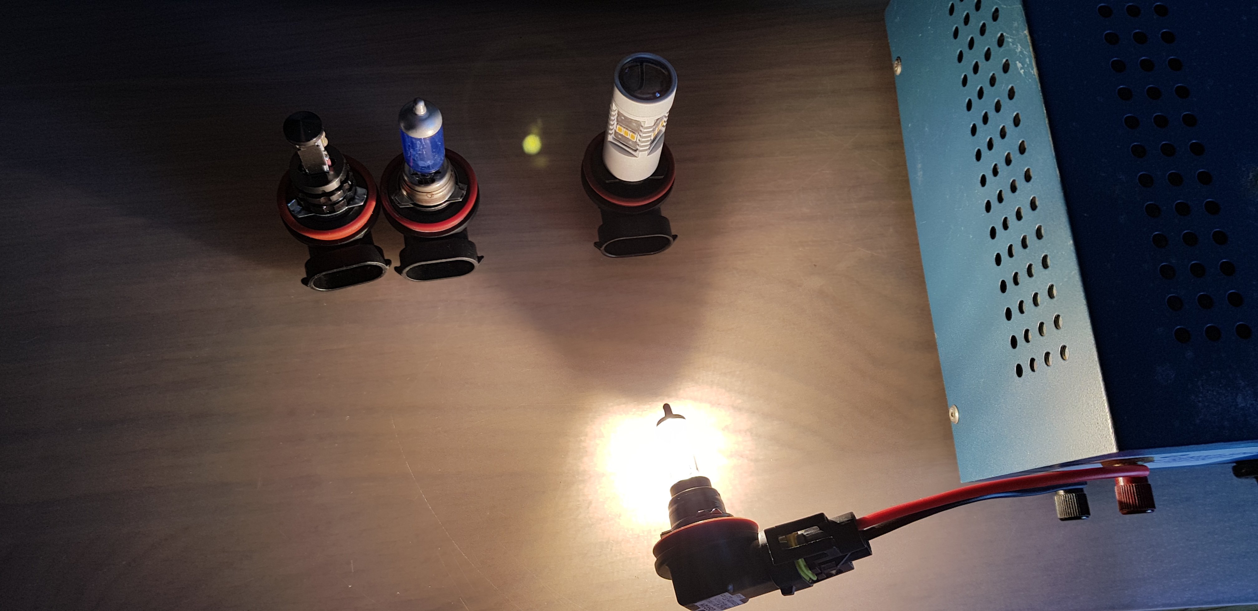

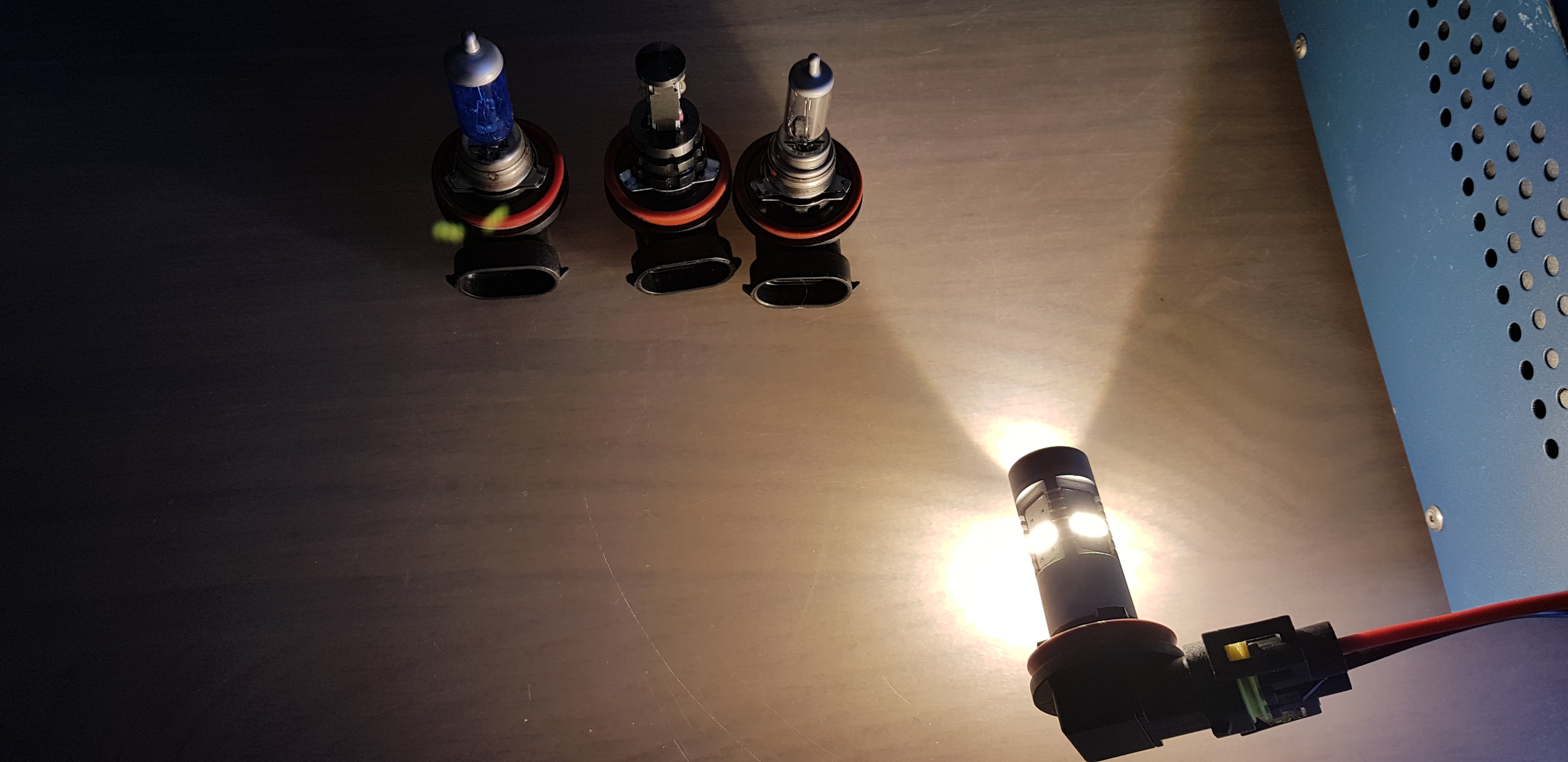

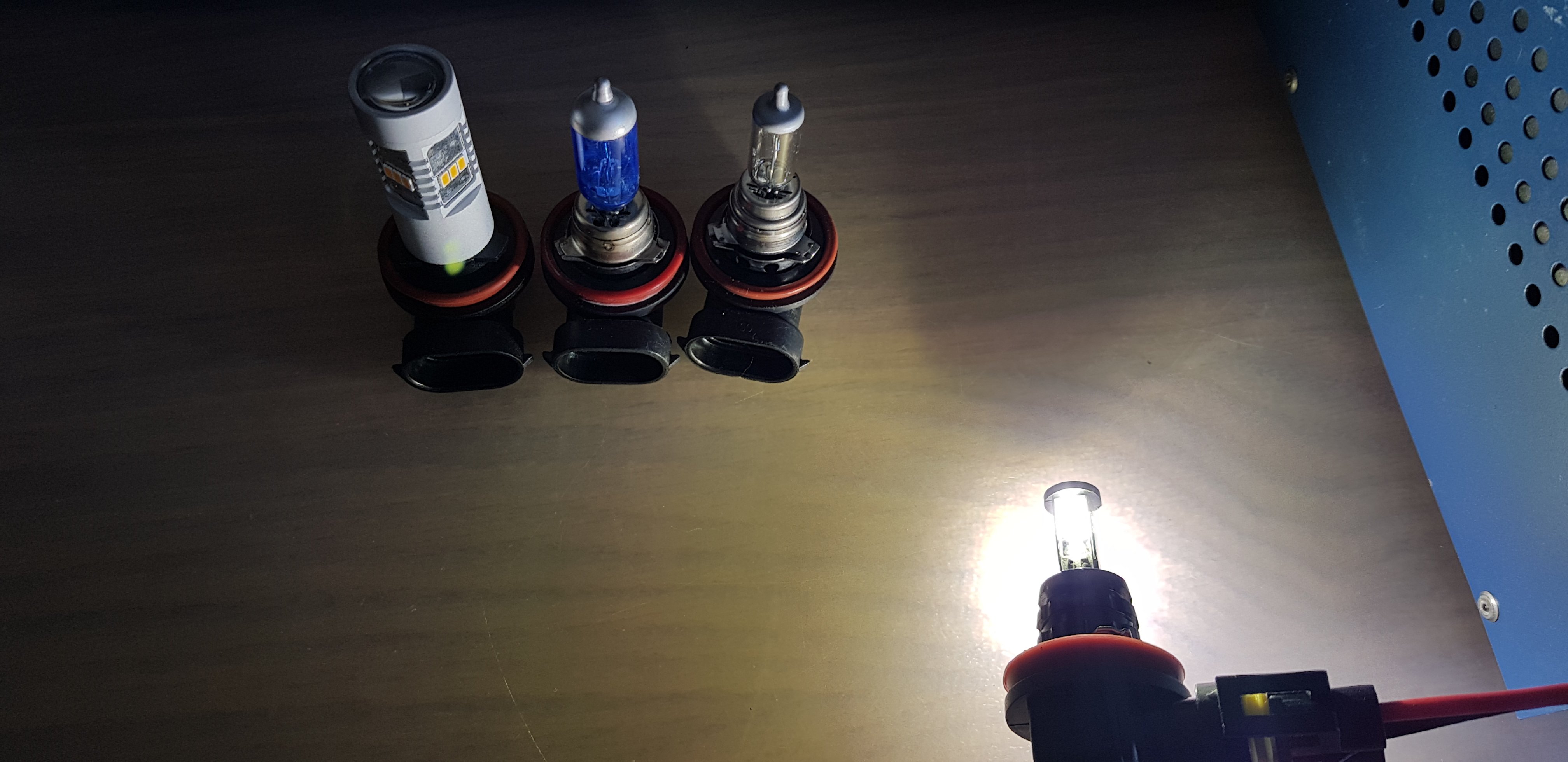

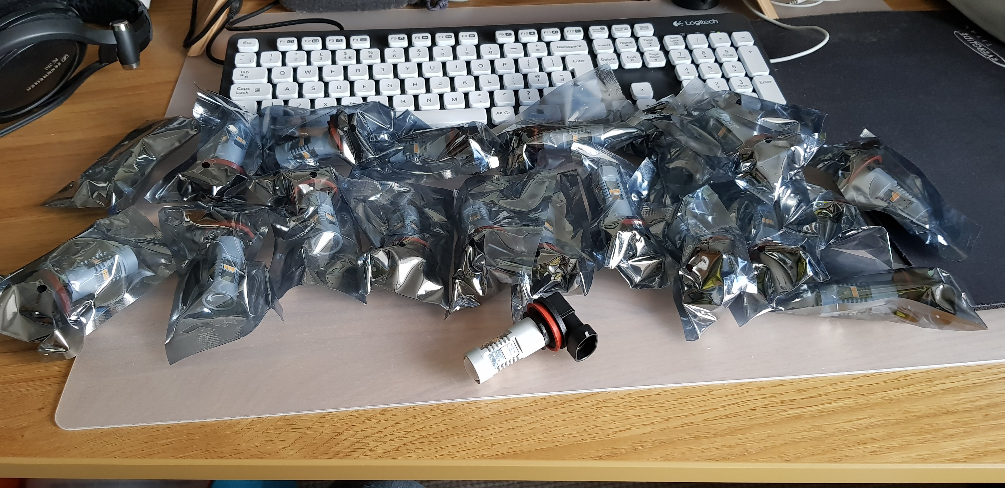

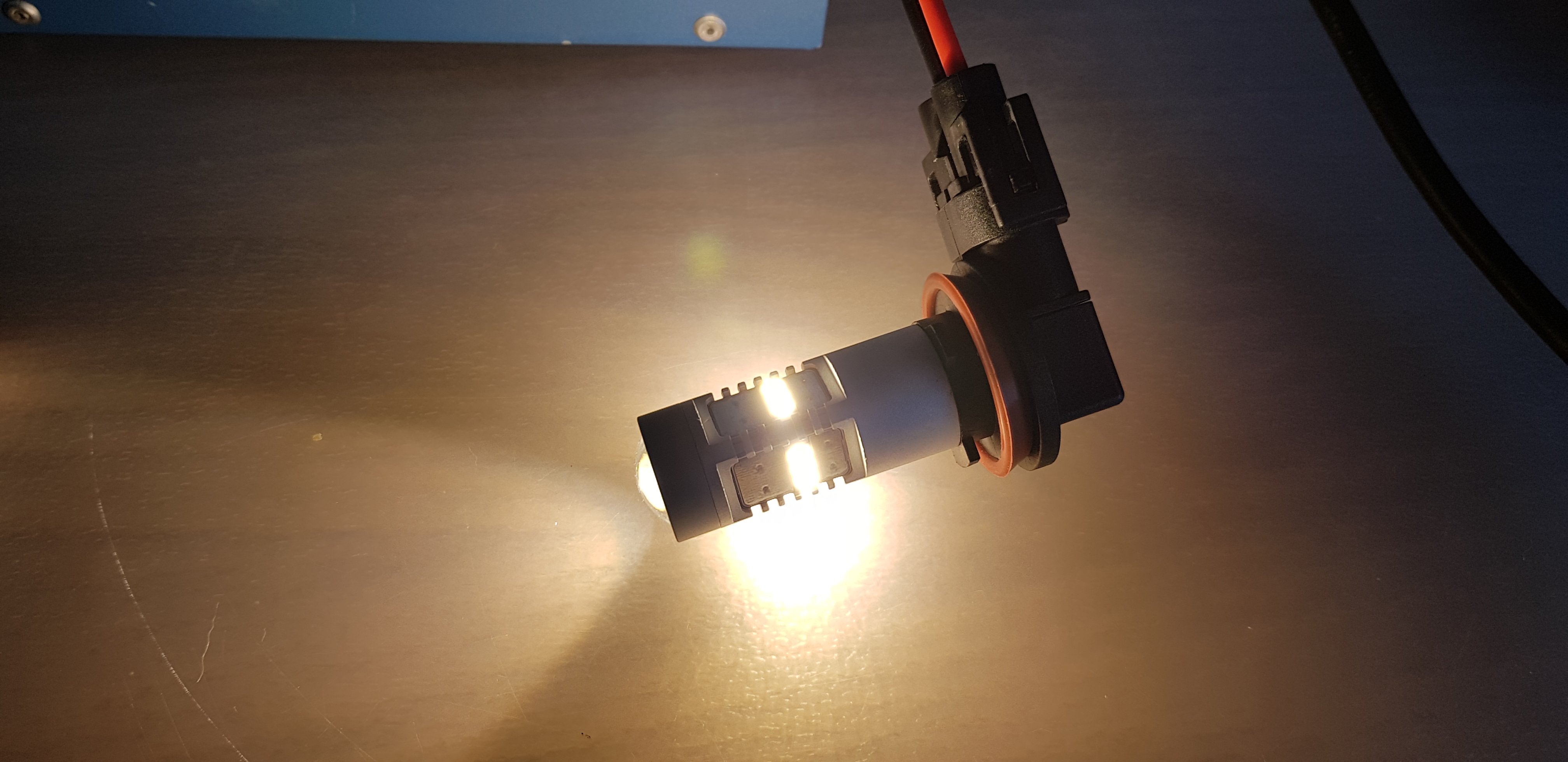

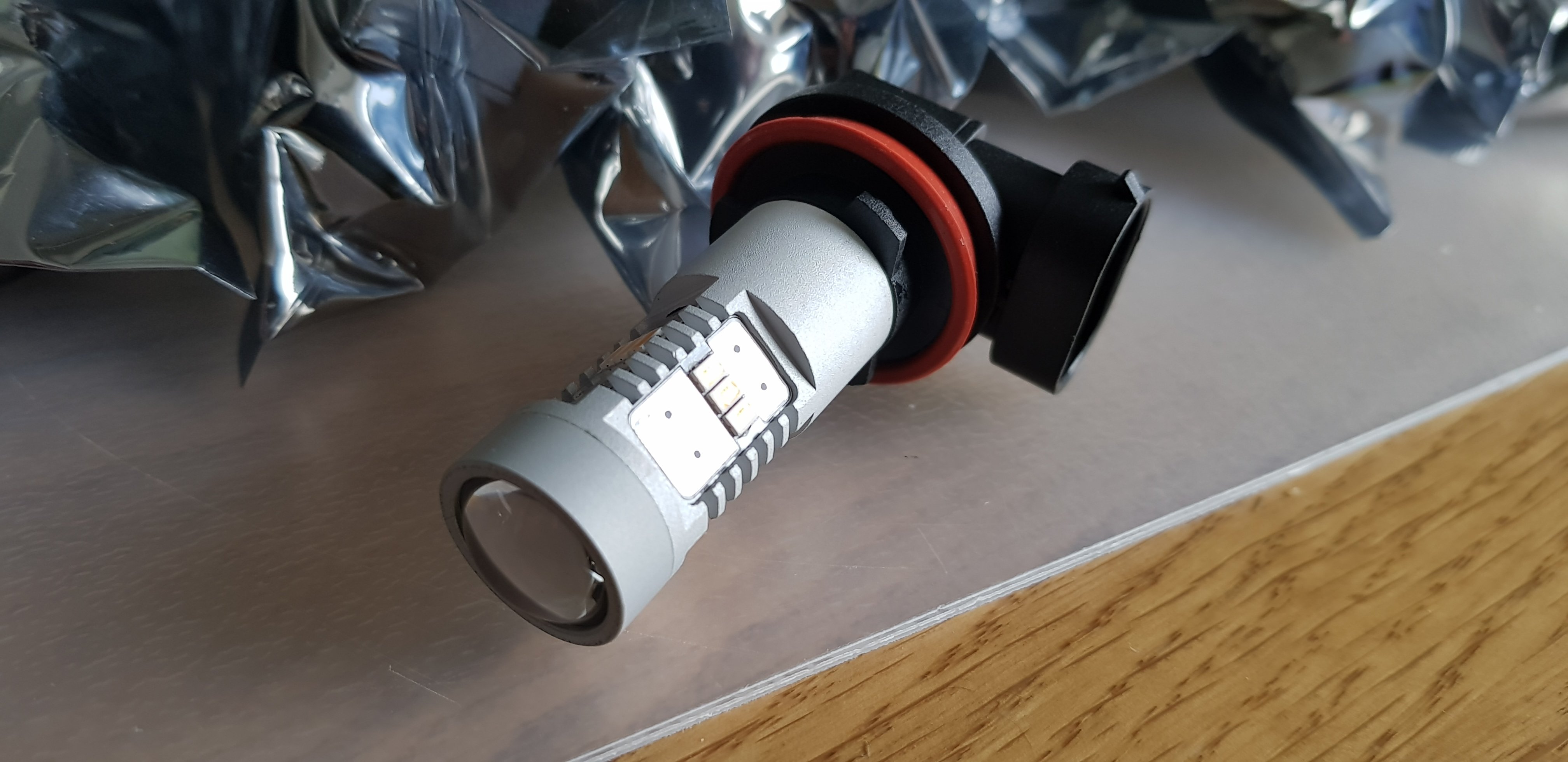

I've tested some different bulbs against each other... Here's the an H16 4300K super bright. There's are slightly more expensive. 20180921_101418.thumb.jpg.77981a6aebc3e58bf0f44c990f34c546.jpg20180921_101424.thumb.jpg.3d09994574974de17d0ab4b7f5ca0c7b.jpg20180921_101555.thumb.jpg.3115e6d1902fd1966d1ebf02dd697154.jpg20180921_101543.thumb.jpg.5d387fcd55b28faed1887479c65673c2.jpg20180921_115045.thumb.jpg.b4aa2cfa7d92bd5720267432ffcb6ea7.jpg

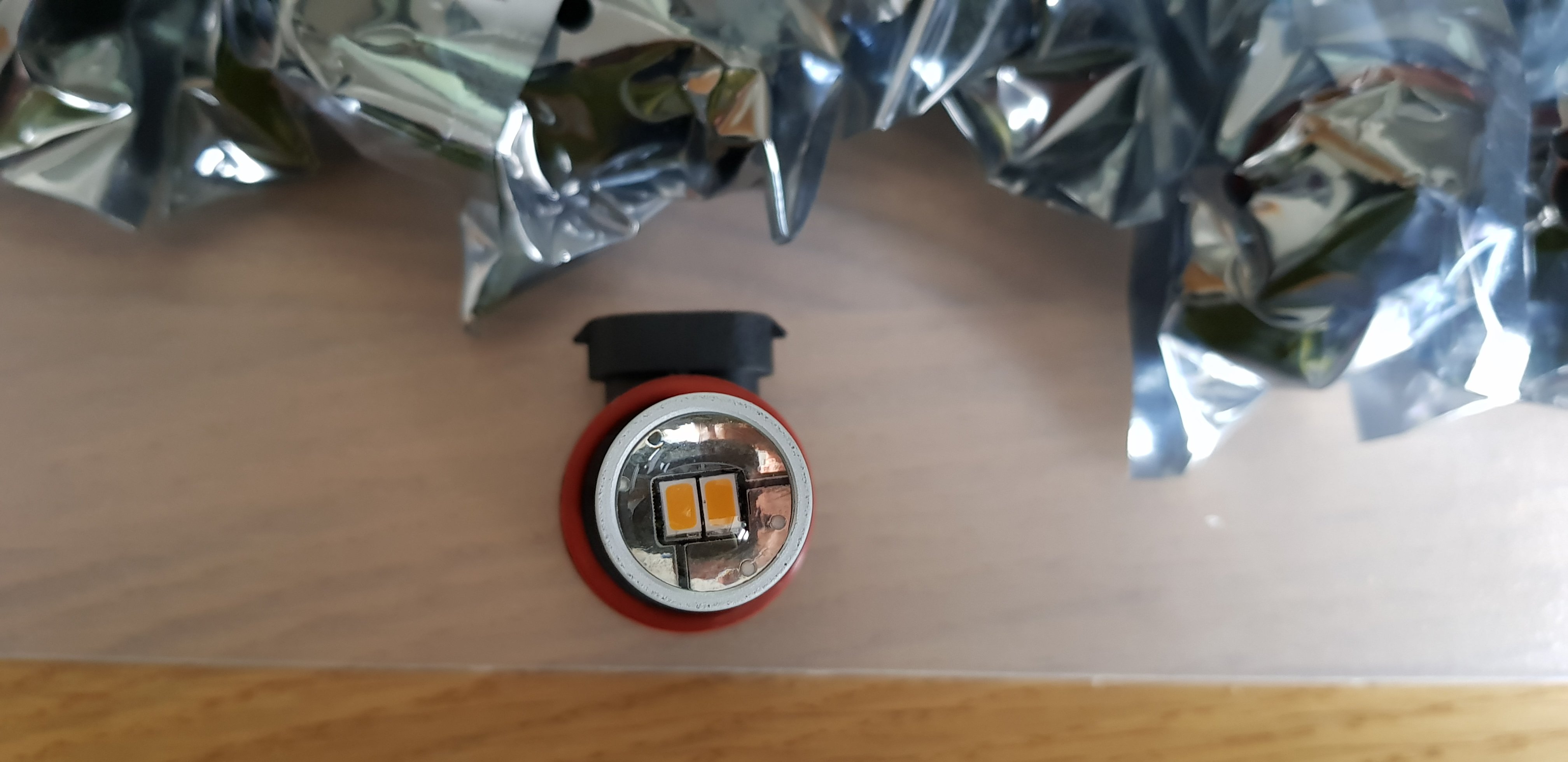

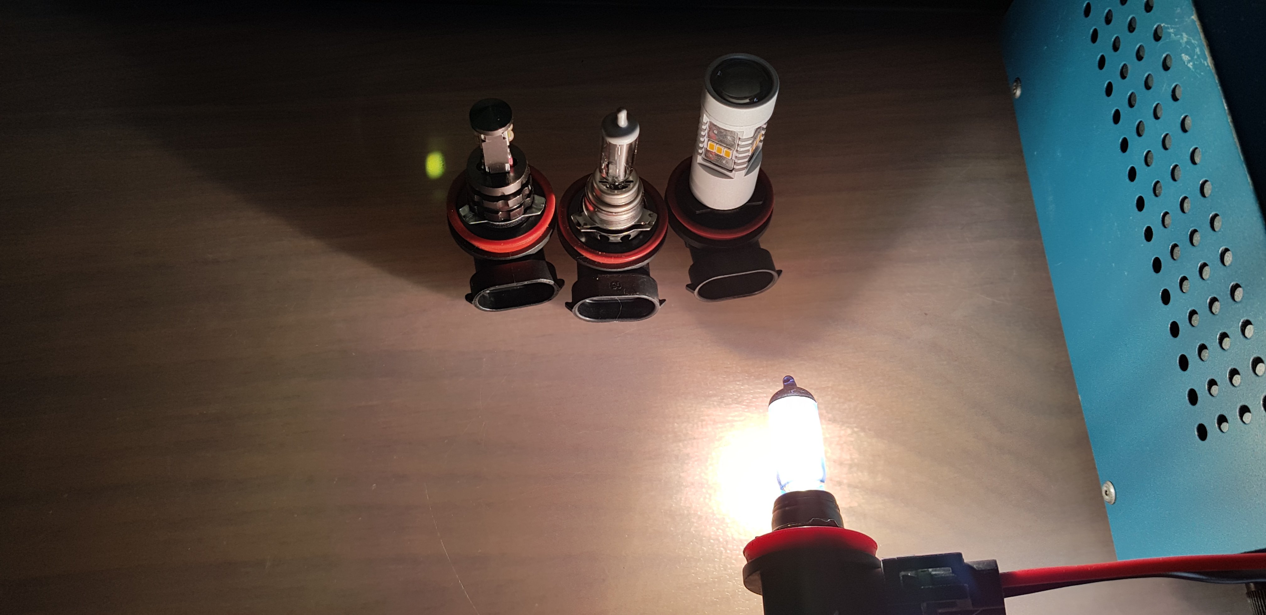

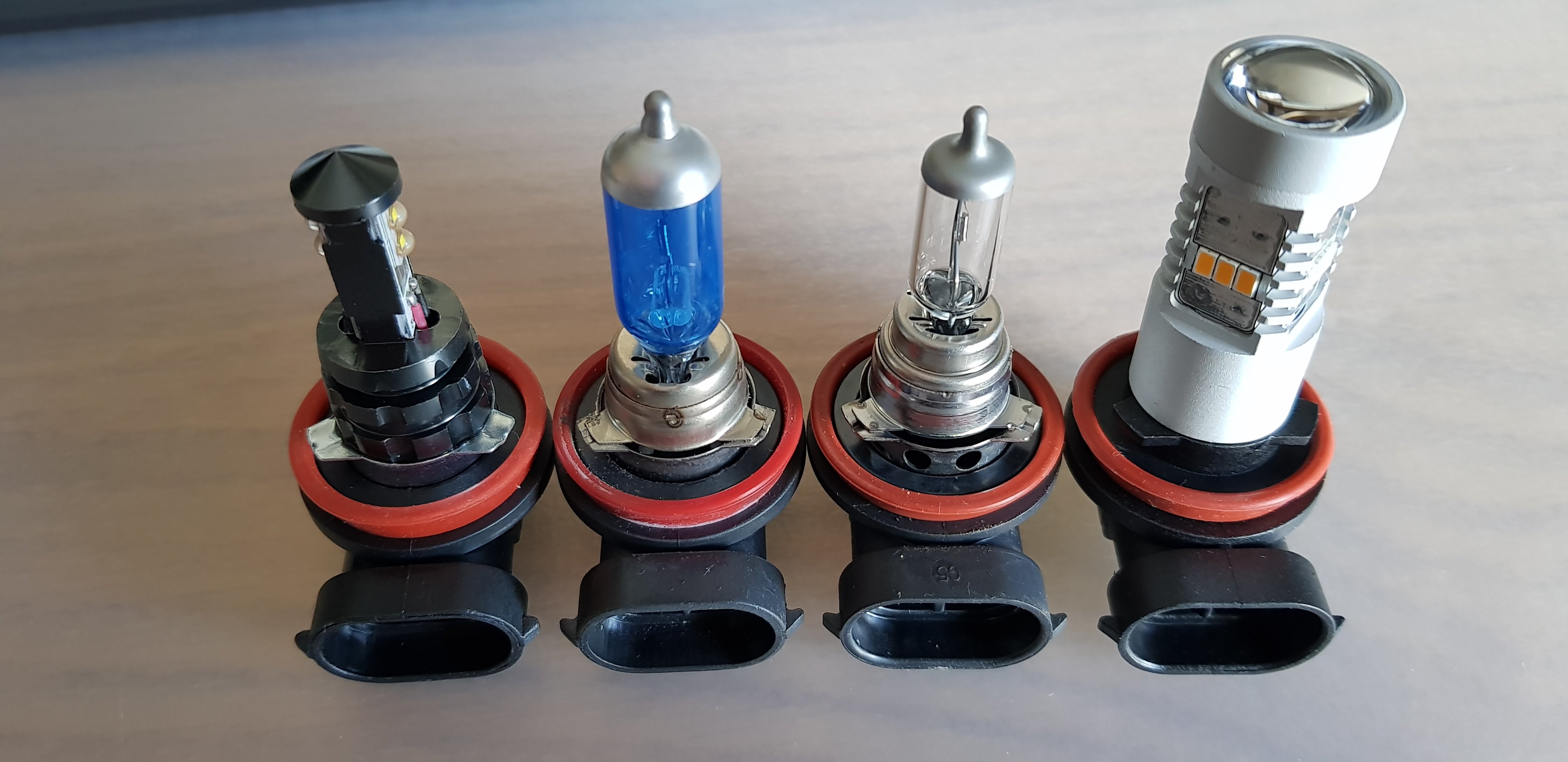

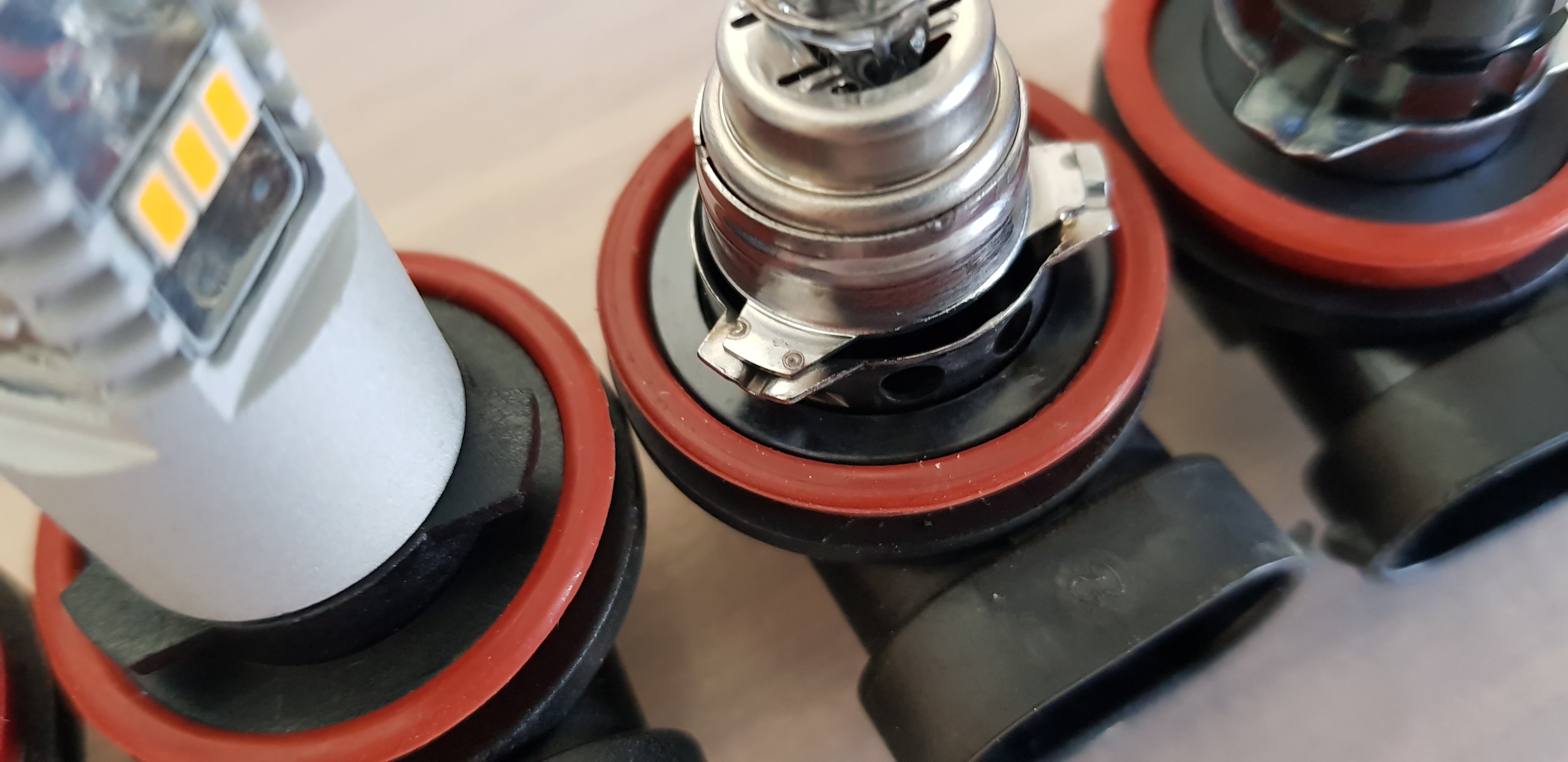

Four different bulbs including the original, from left to right. COB LED H8 4500k, high quailty halogen H16 4500k, original H16 4000k, and super bright 4300k LED20180921_114916.thumb.jpg.94ff3561d1dced2f2d3a6700becd7da8.jpg
20180921_114951.thumb.jpg.6467953b15fba88725a5bec4e0a4181c.jpg20180921_115107.thumb.jpg.6ddf2777a63ea679dca377c43da3ba01.jpg

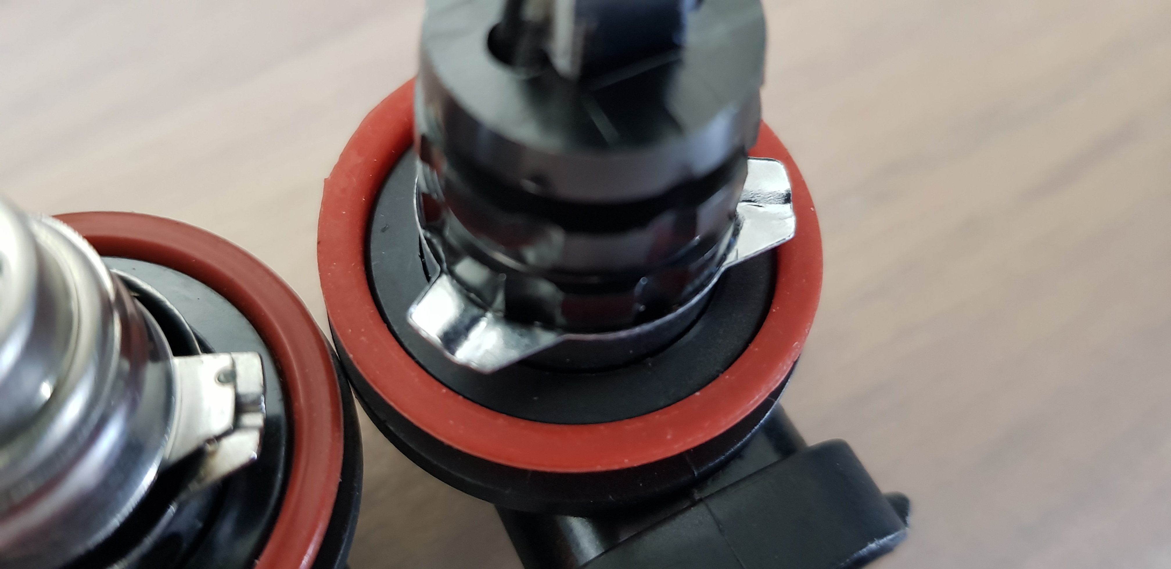

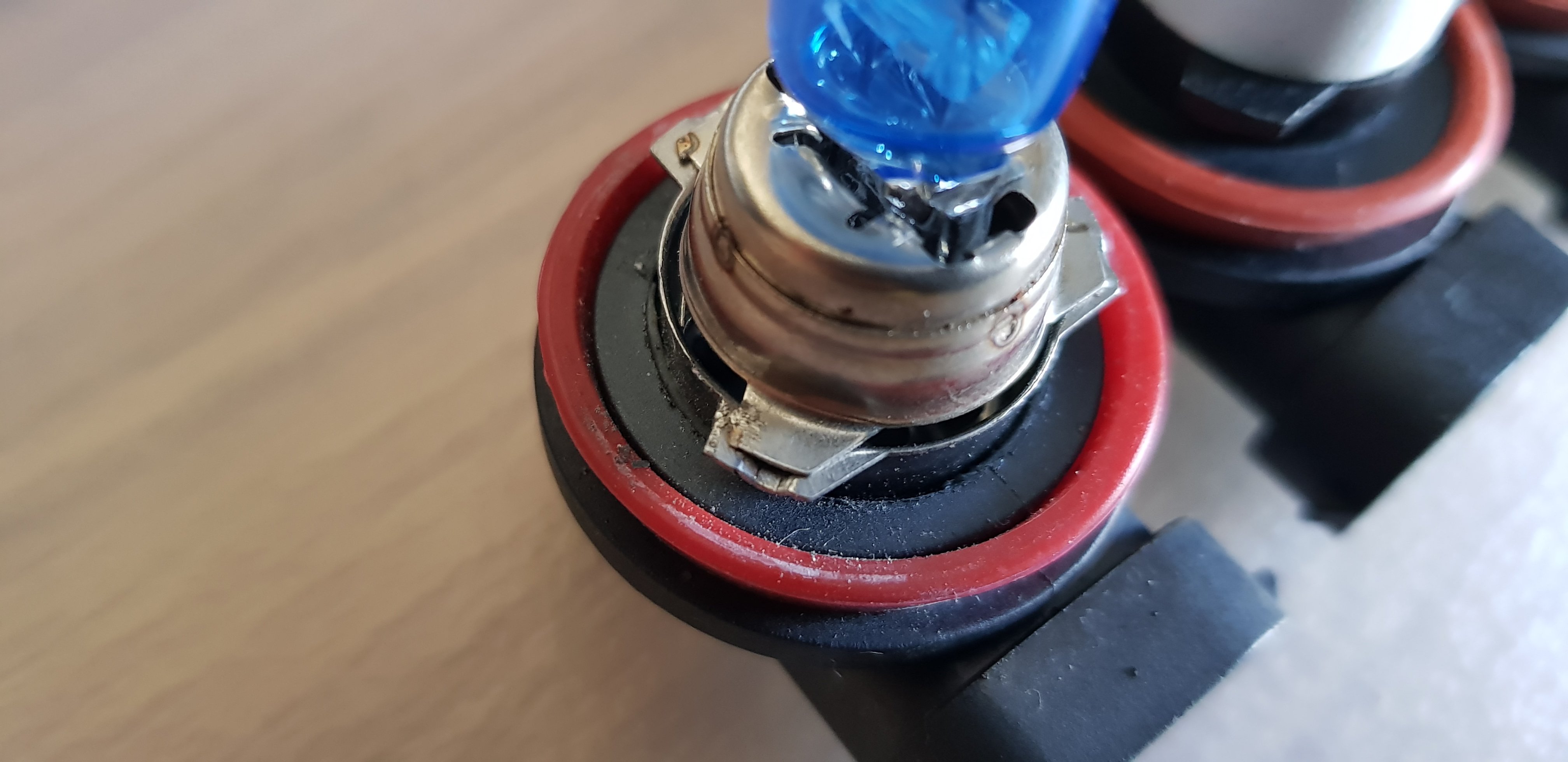

The lug sizes are similar, H8 has about 1mm more on the lug at 8 o'clock. Easy to modify with a dremmel.
Modified H8 to fit H16
H16 COB LED, if you are buying make sure it's JP and not 5202, the latter is an Audi fitment.
Original Halogen Osram H16s

It's not clear from your images, but with the LED bulbs does the position of the LED chips line up with the filament in the halogen bulbs when side by side?
This is key for the light to be usable and not ruin the beam pattern when installed in reflector units. The Osram and Philips LED fog bulbs are crazy expensive, but they do line up with the halogen variant so the beam pattern should be similar.
yes the COB Led one on the left is the exact same height, the one on the right is 4 mm lower but has an extra LED projector on the end. I'll test them in the evening in-situ if it doesnt rain tomorrow.

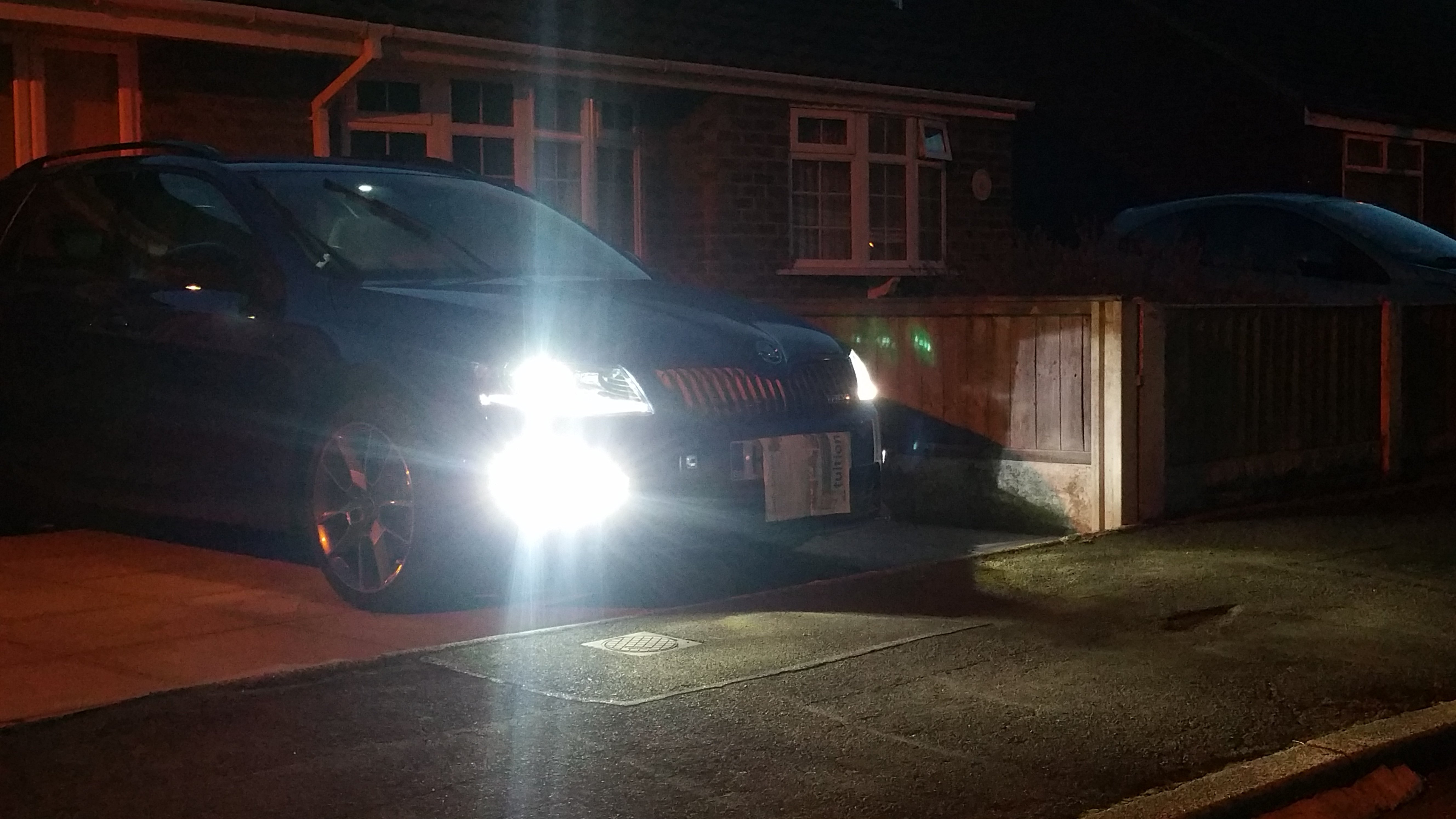

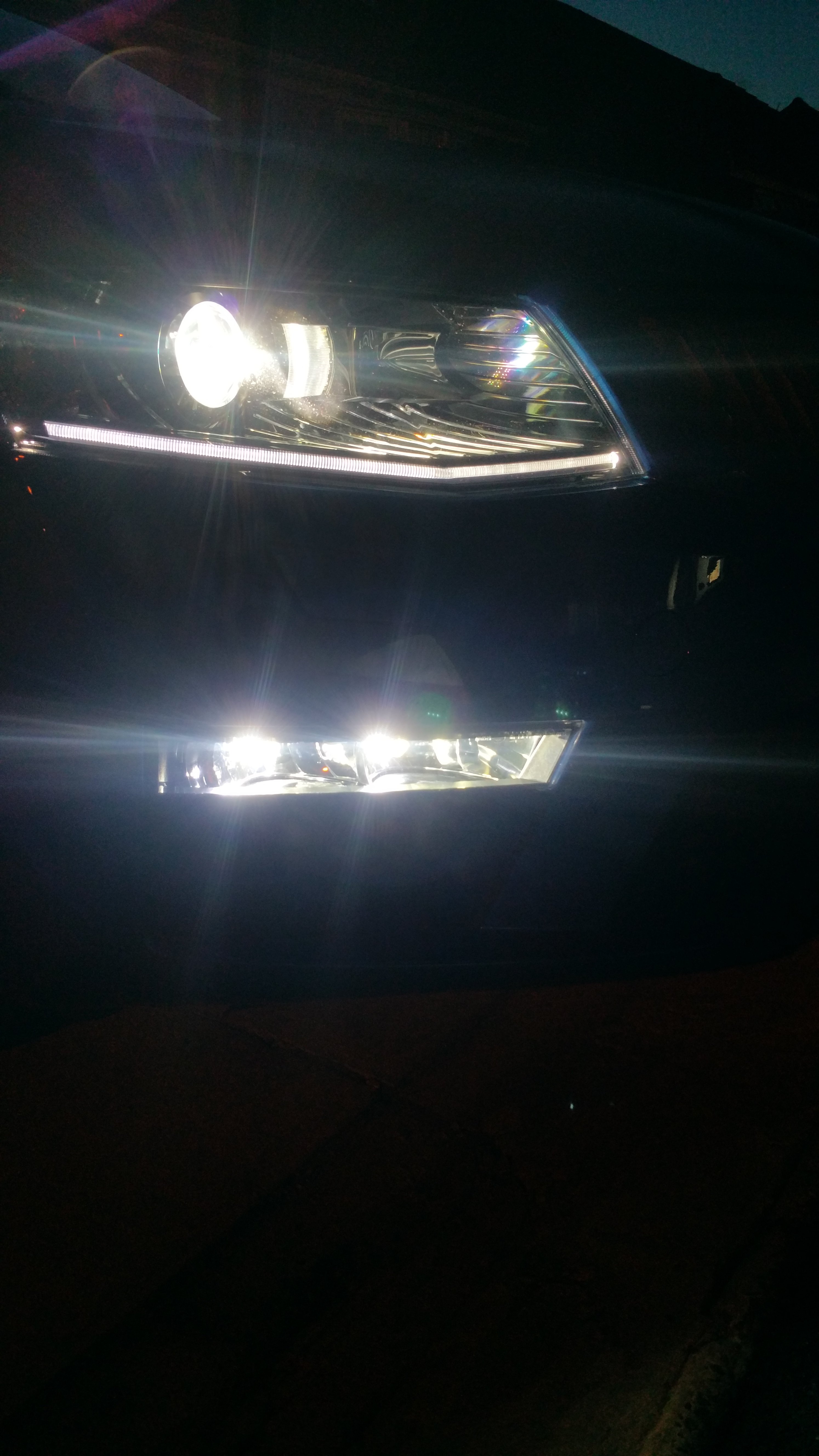

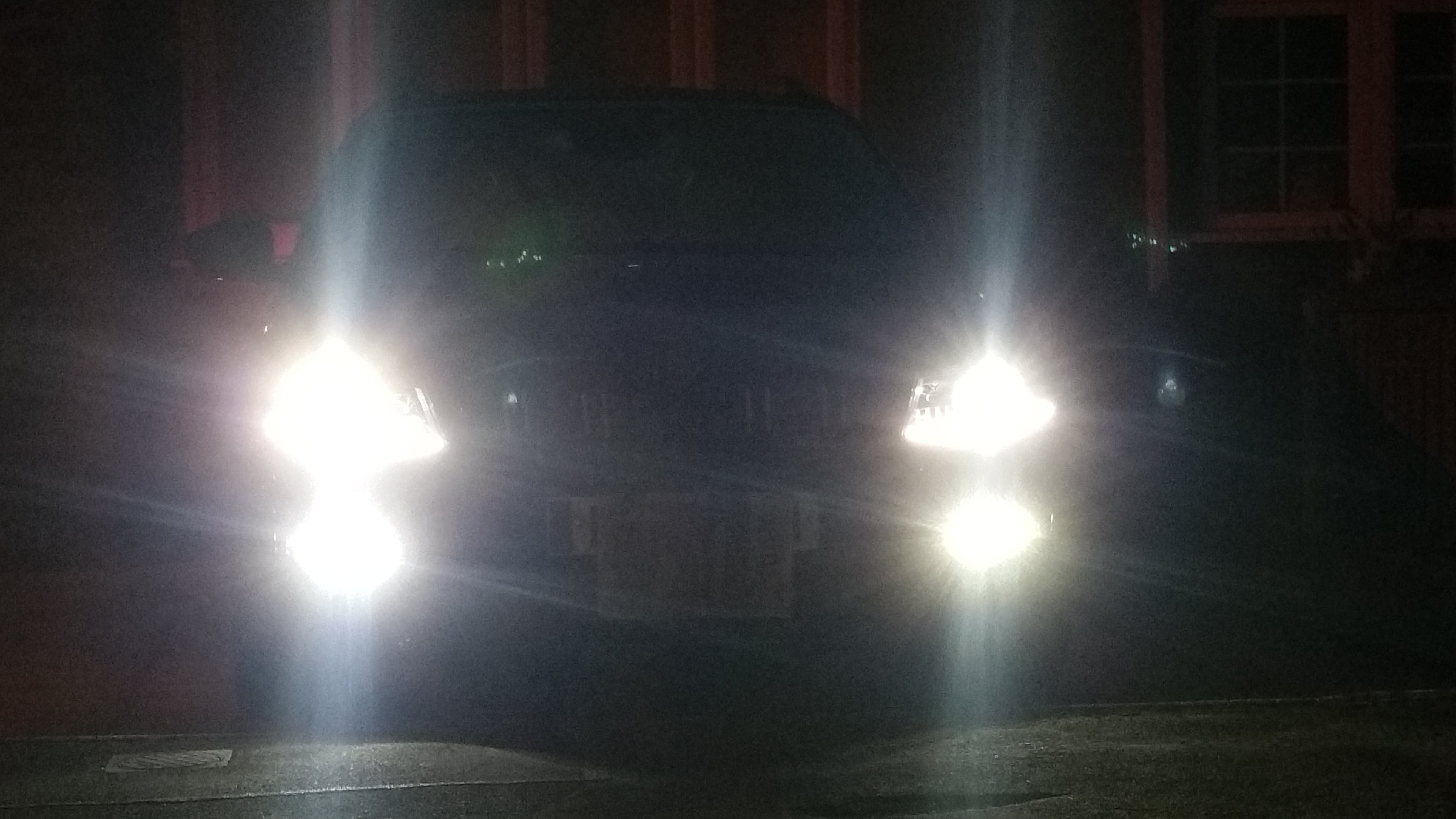

As promised, a few photos of my led fogs. Hard to try and not get a glare from them, as they are quite bright.
From the close up one, you can see it's marginally bluer, however it's a vast improvement over having halogens.
Edited by tunedude
Look good - is that an H8 bub then?

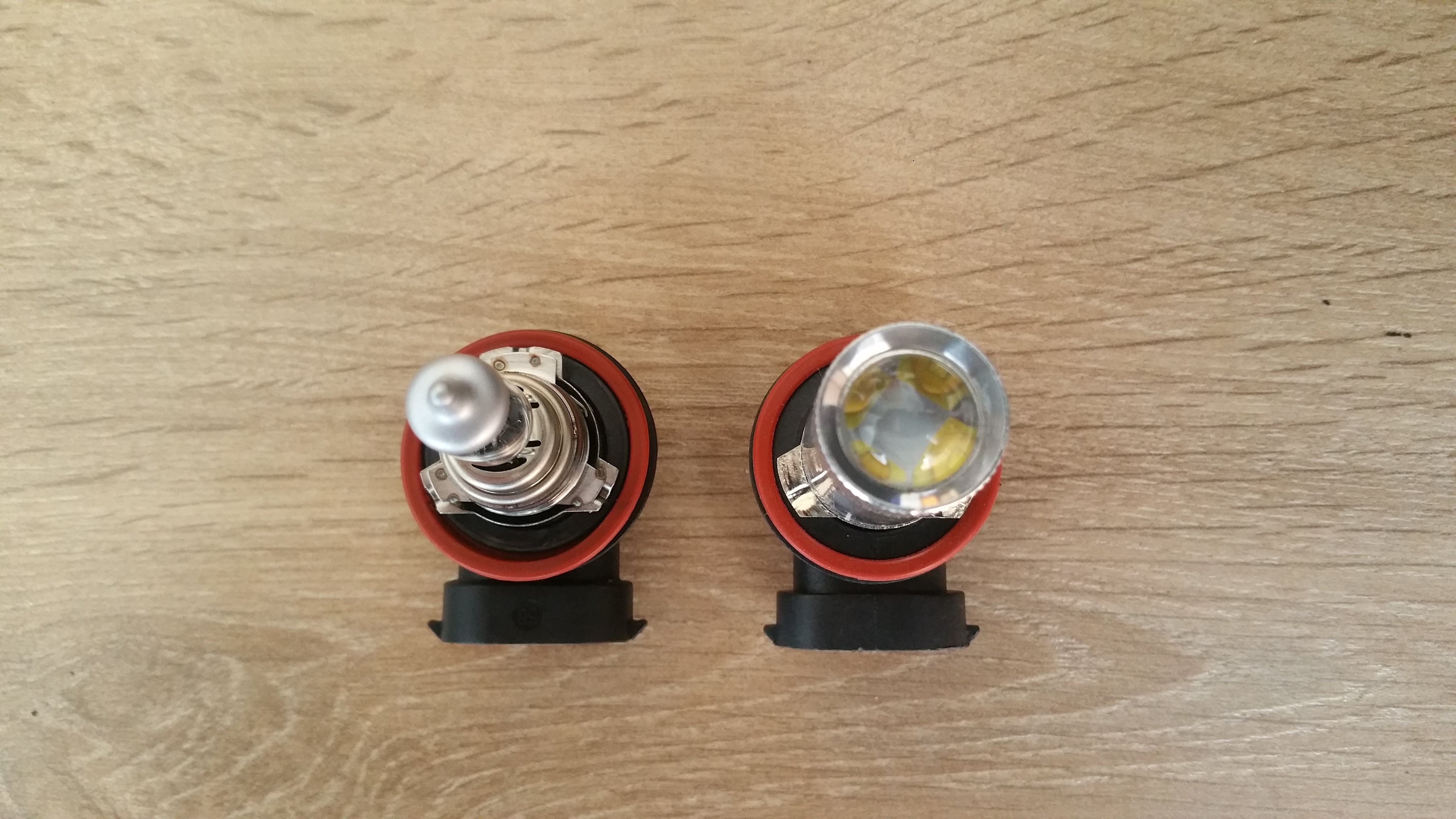

Yep. H8 bulb butchered to be turned into a h16 bulb. I say butchered loosely, just a case of trimming the positioning mounts.

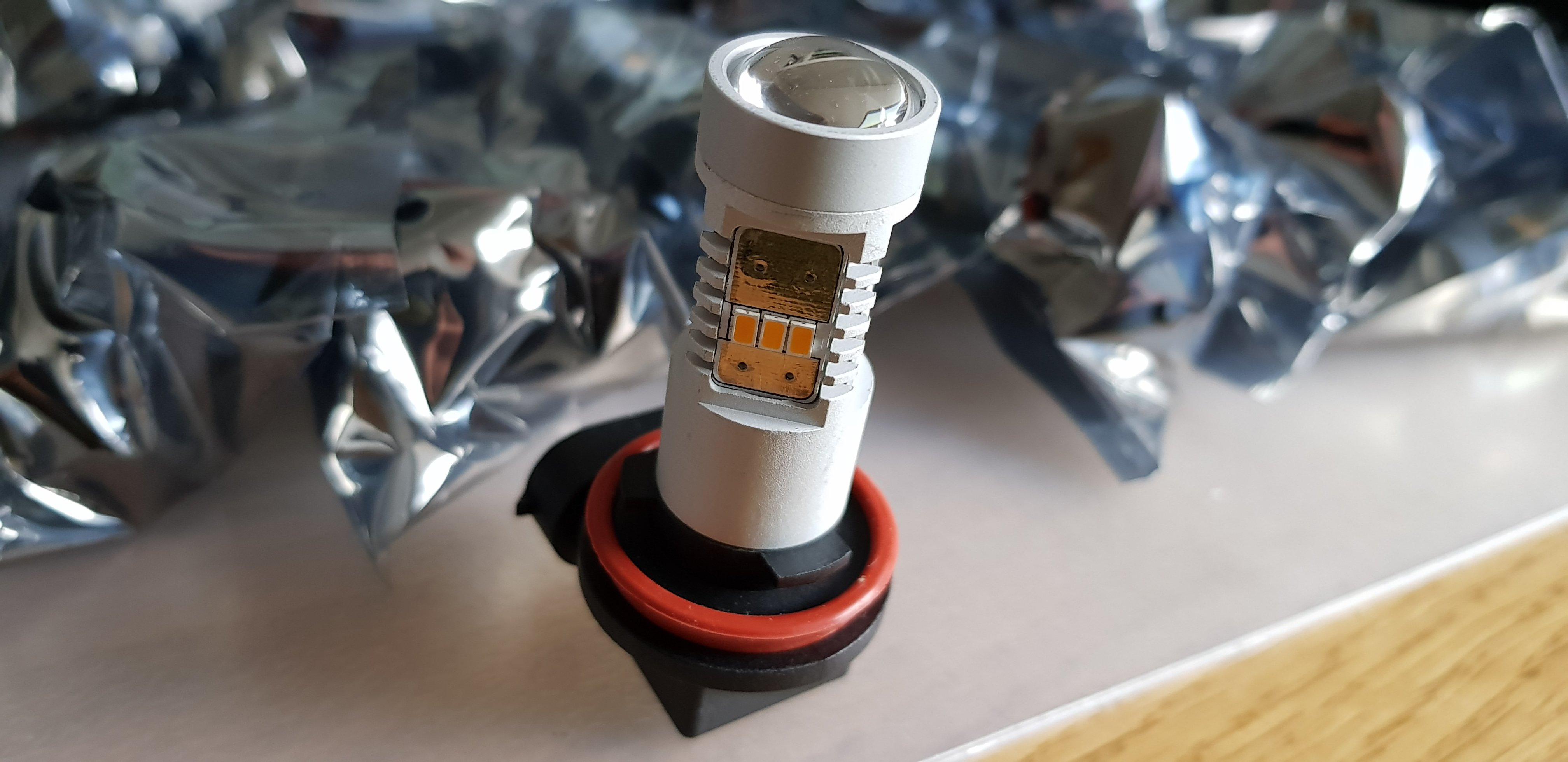

Picture has a h16 bulb on the left and h8 on the right. You can see the slightly larger mounts.
Edited by tunedude
