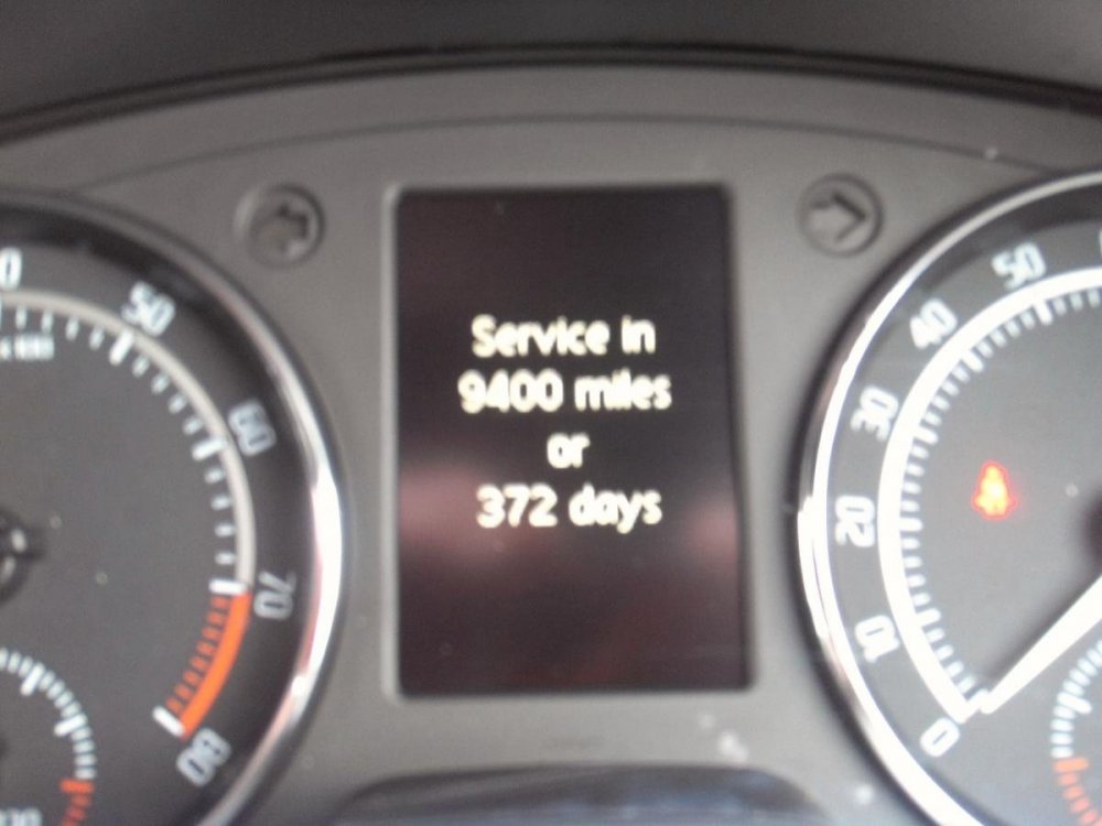

Well they've done something wrong at the service if it really said 6500 miles straight away.  It should say 9300 miles on fixed or on variable it says 18600 or shows "---" for a few days while it thinks about it.
In the UK
Fixed interval is 9300 miles (15k km) or 372 days
Variable interval is up to 18600 miles or 744 days, but could go lower as low as 9000 miles if the computer decides you driving it wrong or the oil is rubbish.
The service reminder nag iirc comes on about 900 miles before its due so about 8400 miles on a fixed interval. Changing eventually to "Oil Service now" or similar indication (depends on the dash display fitted, MFD or basic) at 9300 miles.
If you run out of time (1 yr on fixed) the service indicator comes on then .
Edited by xman
Should be 9,400 miles / 372 days when set for fixed servicing, but what is 100 miles between friends.
So basically the Service Interval needs correctly resetting at services.
My guess is that originally it was on Variable / Flexible Servicing and the attempt to change that to Fixed on the car has failed.
Hey, thanks for calling me a friend ski!! :biggrin::biggrin:
But to annoy everyone with pedantic trivia..
It's actually 15,000 km which is 9320.5679 miles. So depending on whether Skoda rounds up or down. Which might depend on the car, or whether the service guy took it for a 21 mile test drive.... that's my excuse anyway!
:nerd::emo::toivo:
Edited by xman
Are there Maxidot that come up showing 9,300 miles if you reset the fixed servicing?  i have not seen any, but not seen all so just wondering.
Does it matter? I was just making up excuses....:clap:
