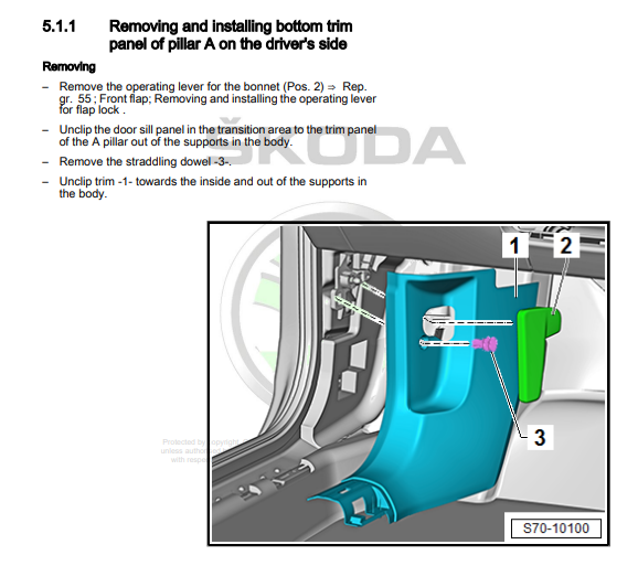

i want to remove this , handle in order to expose the RED anf Brown big plugs , and start installin the harness. its a slow procedure i have to tell!
acording to the manual , what do you understand?
i tried with a plastic tool to remove the handle first , but it doesnt pops out
EDIT : TO answer my own Question
