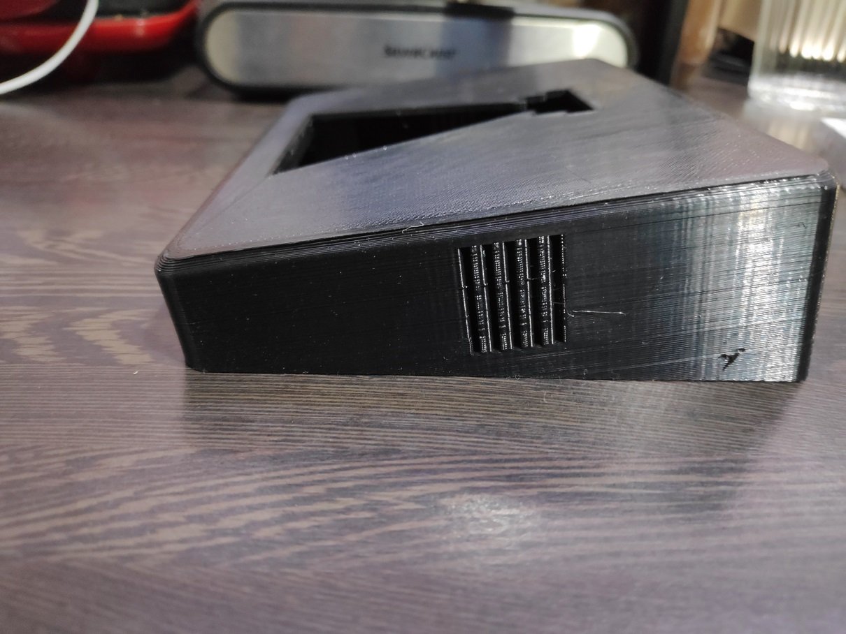

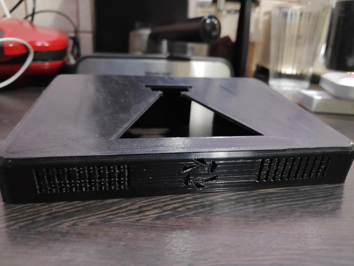

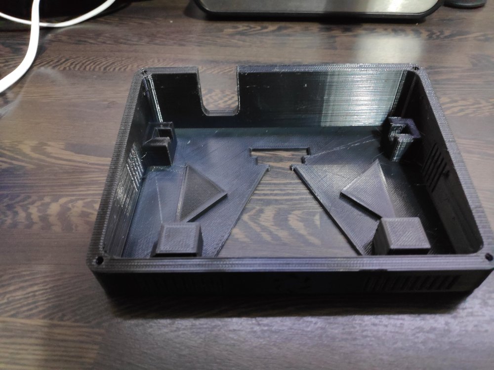

hmm i cant find the CAN gateway ...  everything else is there!
Where did they hide it ,, Anyone knows??
Edited by Tezaman

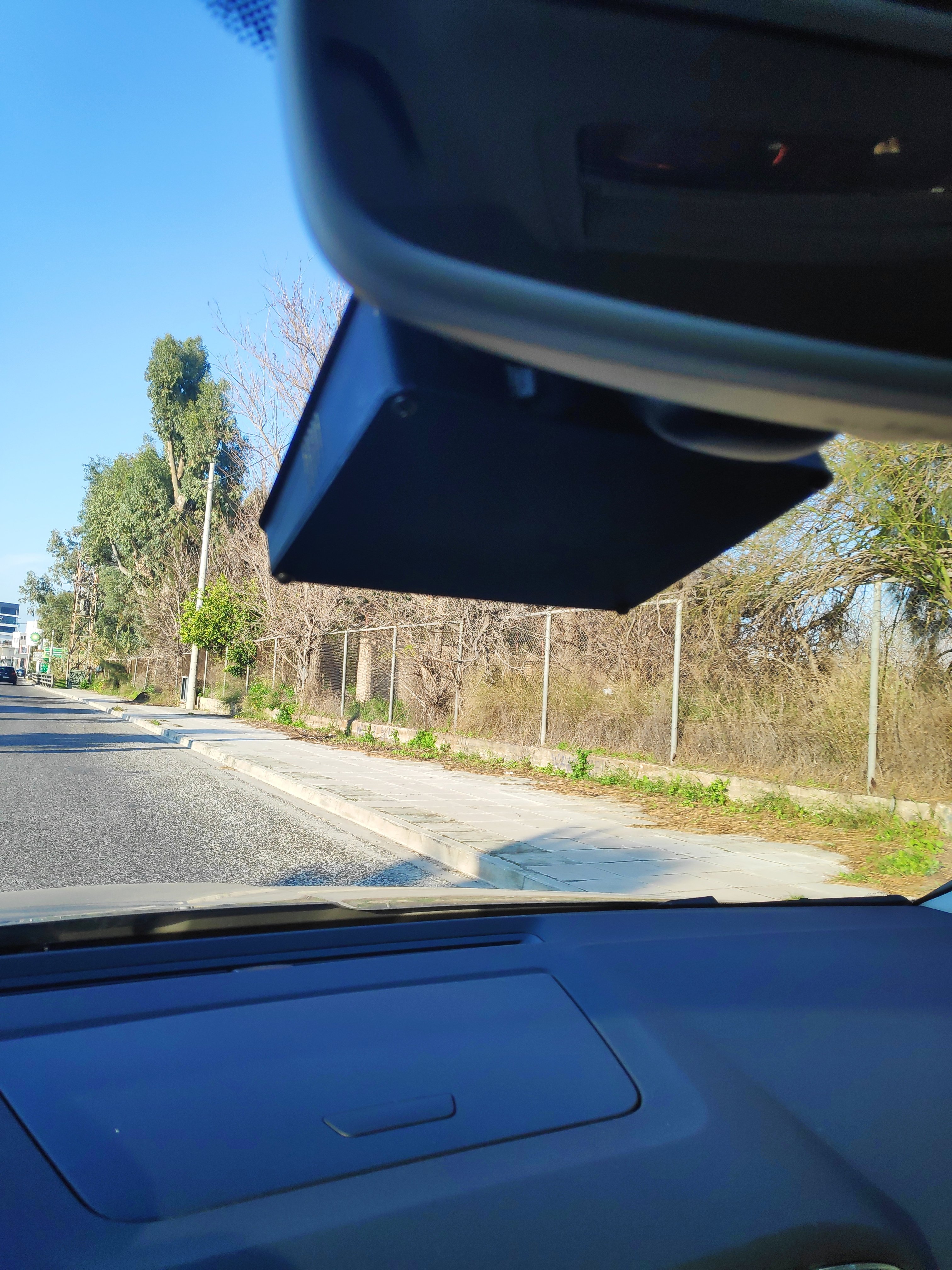

The bracket is installed. There are two pieces of dark tints in front of the camera so there is a dark border outside, So no paint in the glass
Edited by Tezaman

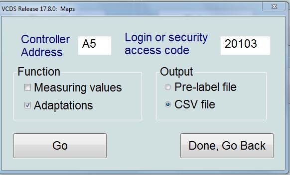

Hi, I have a request to owner with the Factory fitted Lane Assistant in Octavia 3 vRS FL for a VCDS scan of the control A5 driver adaptation channel (3Q0980654). It is necessary for me to calibrate the camera.
I would be very grateful for your help.
If anyone would like to help but don't know how to do it, I attach a photo.
