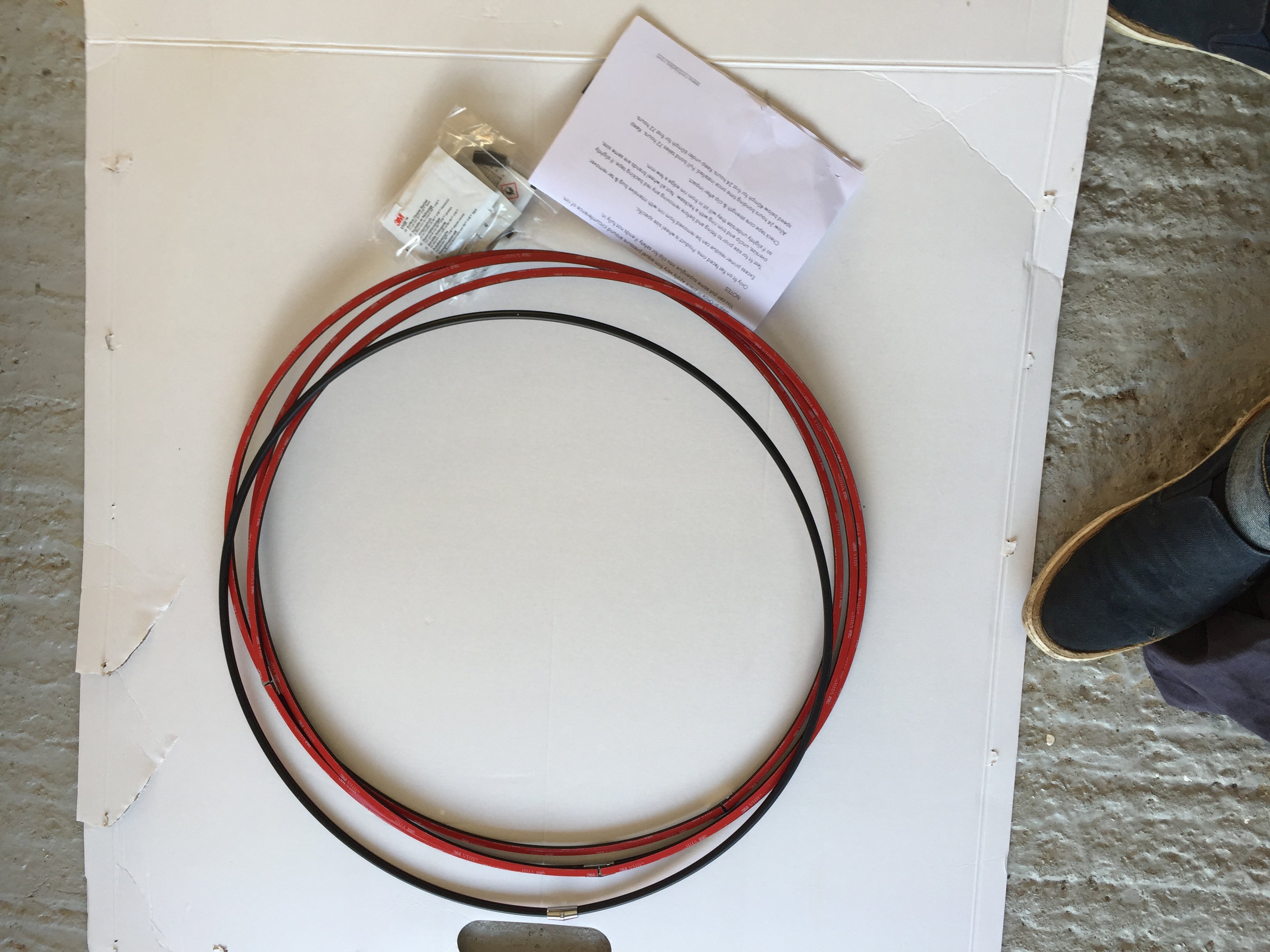

These seem to be harder material, cut to size and already rim shaped. So I thought I’d give them a go and do a write up:

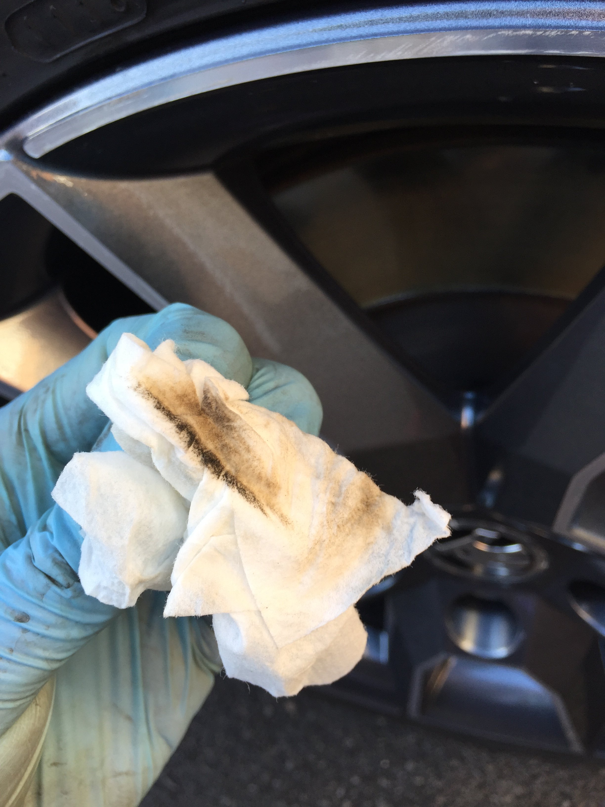

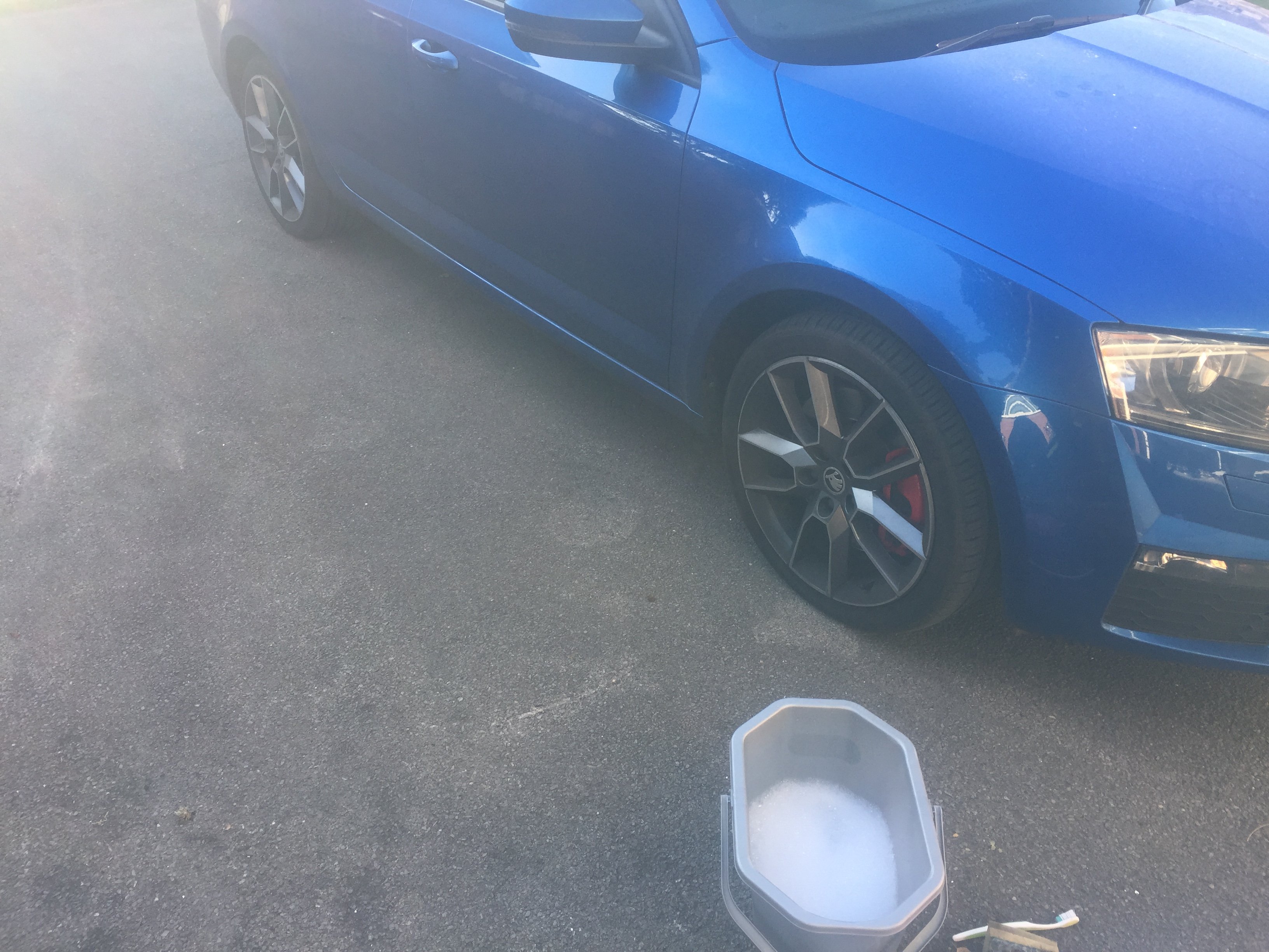

step 1 - wash the alloys really well!

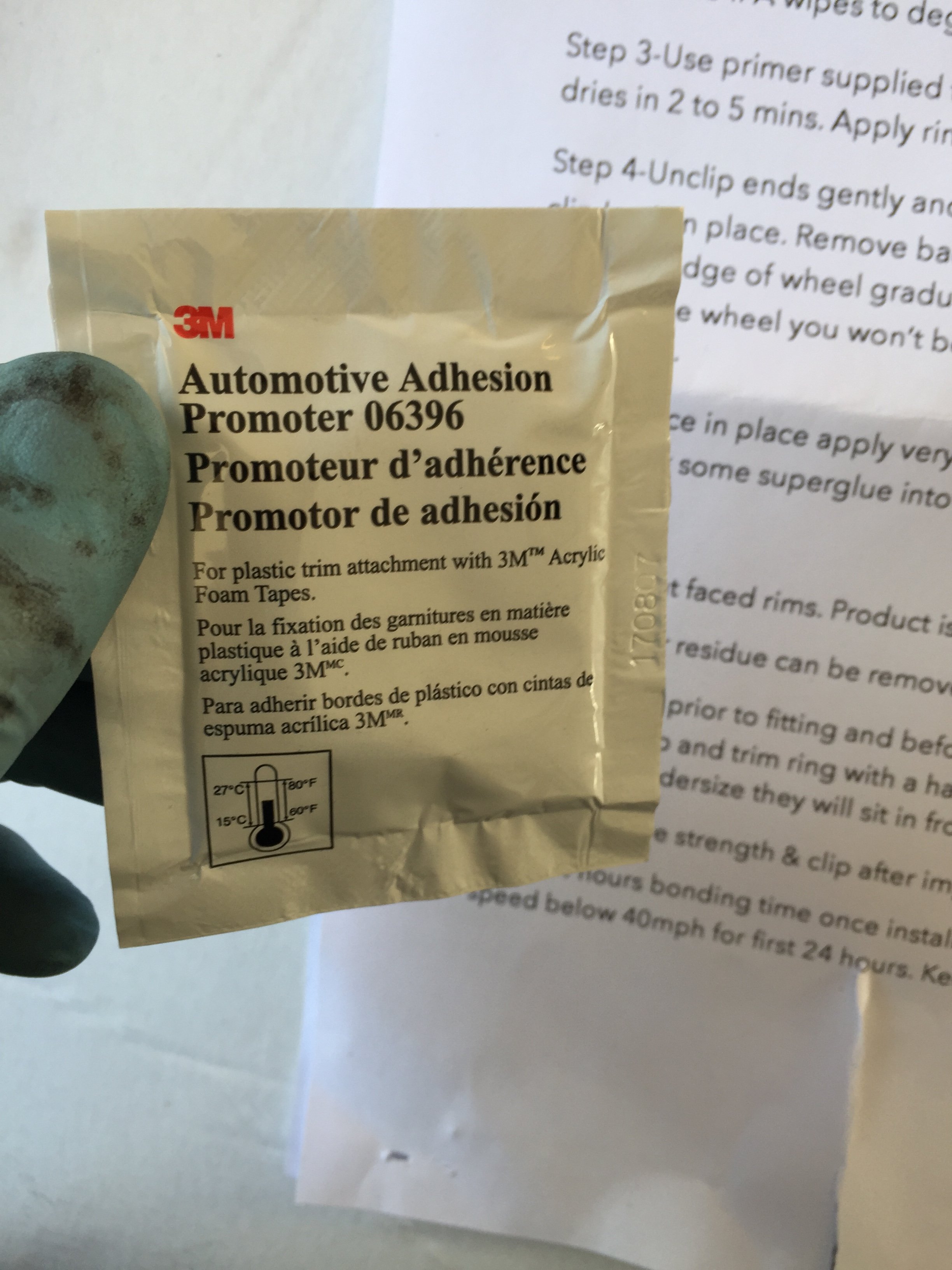

step 2 - open up pack and use the alcohol wipes to remove any final debris
C20980FB-D347-44F0-97C5-390BABA1A527.thumb.jpeg.d4d9848576998d27d24e40b7425b3205.jpeg852E6151-A4BE-41D9-9CB8-FD8CA7CE4699.thumb.jpeg.2b5c305f2f014ad73c039b24debd5b21.jpeg

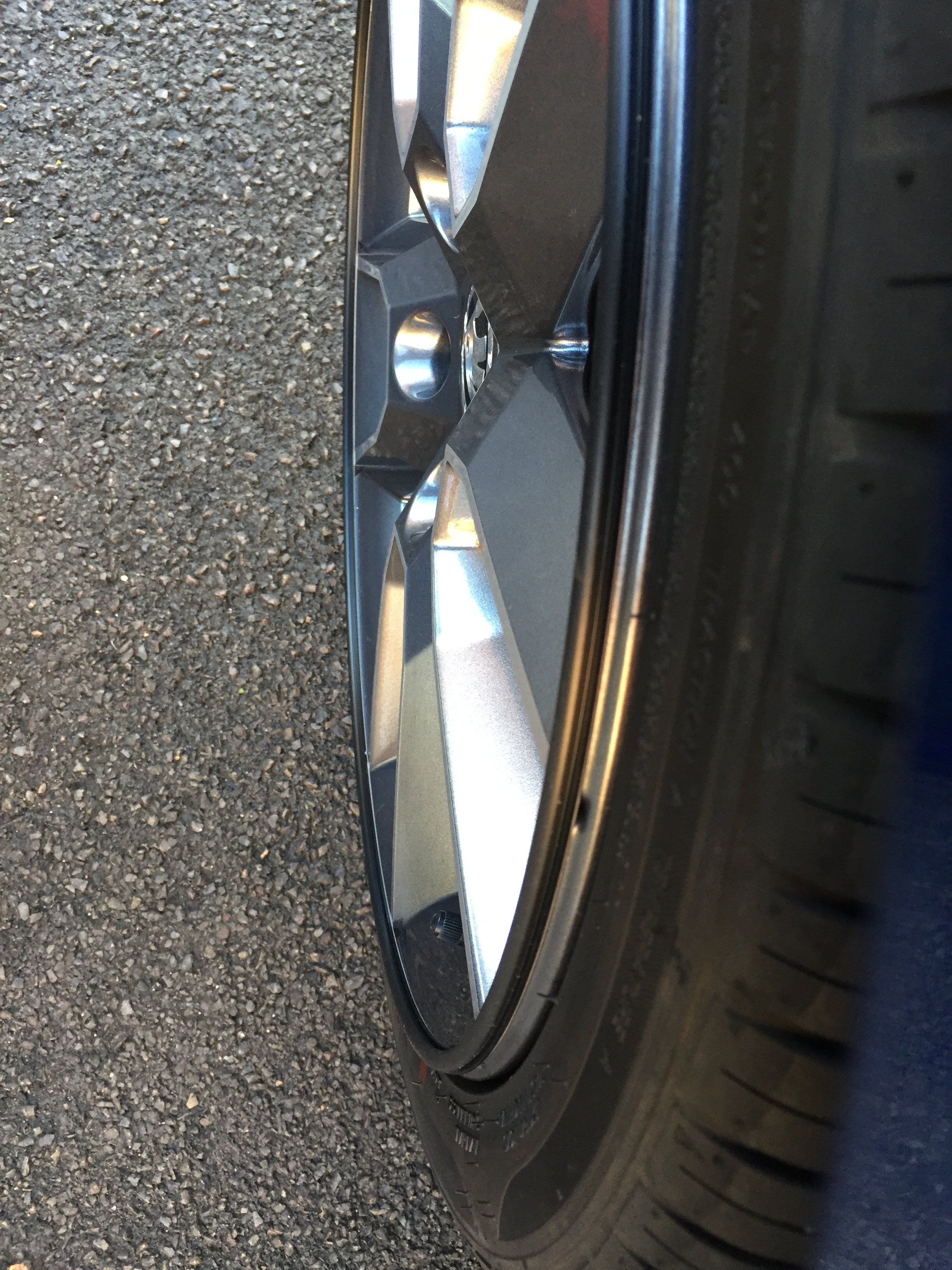

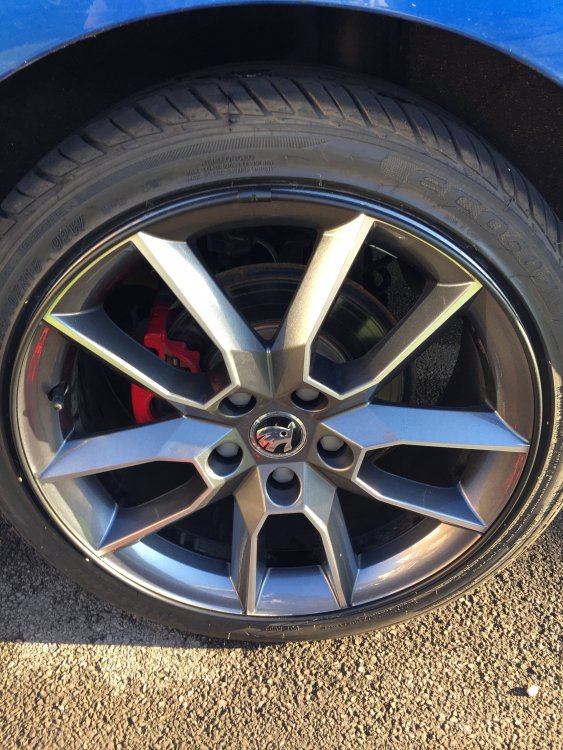

step 3 - apply the bonding agent they supply and leave for 2-5 minutes. The peel off the adhesive backing from the rim protector and accurately apply to the rim. Finally make sure you insert the rim protector back into the clip they supply to close the circle off.
Finished product above.
leave for 24 hrs and not drive above 40mph and then fully bonded after 72hrs.
so far so good. Plastic is bery hard and the bonding agent seems good.
