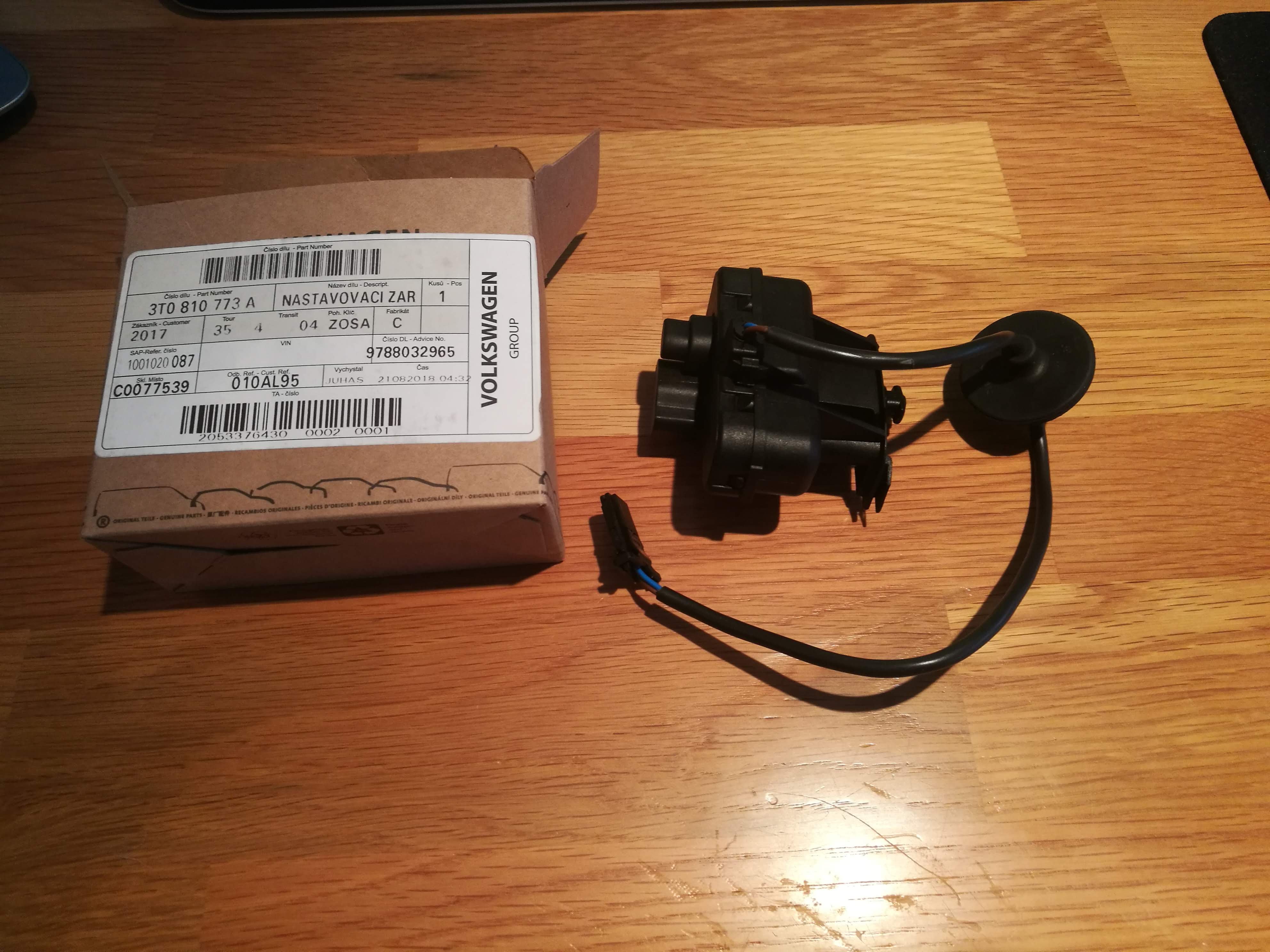

I have had the well described problem on here of the fuel lock sticking and needing to be encouraged to open for a couple of months now, so I bit the bullet and ordered the part to replace it....this has arrived today..question I have is the connector through the rubber bung is connected in the boot behind the carpeted carboard sections and I cannot see a way of getting to it....any ideas? I cannot pull it through enough to do it through the hole..so its looks like I need to take the carpeted boot lining off the fill side of the boot which does not look straight forward...I found the 3 hooks with the hidden screws in the middle  that hold it in place but it looks like the boot twindoor hinge and the audio box on the shelf in the boot may also be holding it all inplace too.....any ideas?

Don't say that...aahhh...thought this was the easy solution...unplug the old one and plug in the new one....removing it is easy..its just getting to the connector at the end...I tried the lubricating it option and it worked for a short time...so its defo just sticking but replacing it seemed the best long term fix....just need to get to that connector at the weekend.
