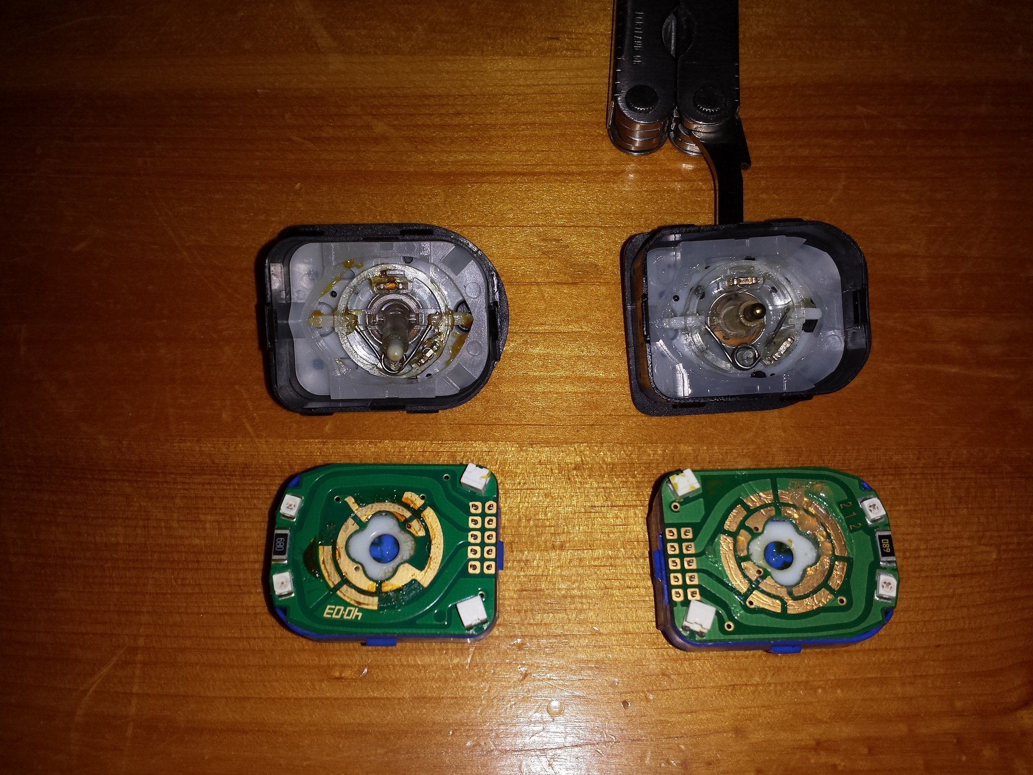

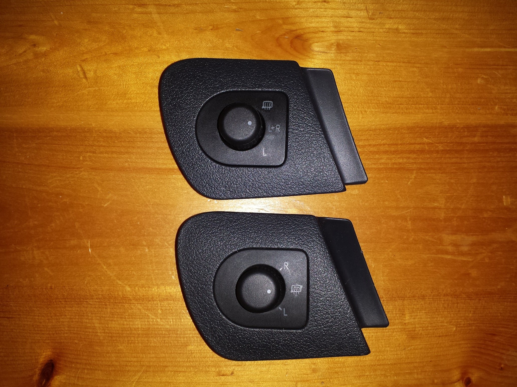

Bit late to the party now, but might be of use to someone else in future (can't find old thread on it). I had same issue but had a non UK standard part in mine as it was a parallel import when new from ROI so had the EU style one (heated top, middle L+R and L bottom) found it impossible to find a replacement due to being RHD very rare, so bought a normal one and stripped both down and used the clear stalk bit. Easy done, bloody tight though.
