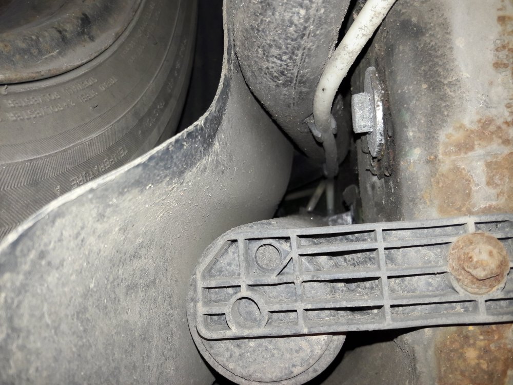

Strangely enough half an hour ago I was sitting by the roadside with the charcoal cannister in my hands in my ongoing quest to find an 'airleak'.

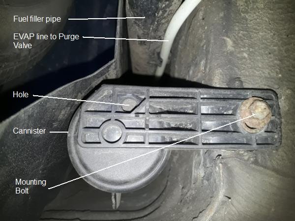

For the 1.4 16v car and I'm guessing all the petrol Fabs there are two bayonet connectors on top of the cannister, one going to the filler pipe and one going to the purge valve in the engine bay. Only valve in the system is the purge valve. (On my car its closed when the ignition is off). No solenoid or valve on the cannister, just a 5+mm hole in the bottom of it, next to the mounting bolt. No Valve in this hole on mine. I can suck and blow through it! Seems that the fuel tank vapour space is sealed at the filler cap but can passively suck and blow through this hole in the bottom of the charcoal cannister at will. So leaves the petrol fumes in the charcoal when blowing out and clears them back into the system when fresh air is sucked in with the purge valve open.
I was going to ask on here if this was normal. But two of the highly regarded posters above don't seem to have come across this. Certainly a significant airflow if you bypass the pipes round the purge valve.

Next time you have a chance can you look and see if yours is the same. Easily visible without any dismantling.

This is my Polo, but looks identical as I'd expect:
