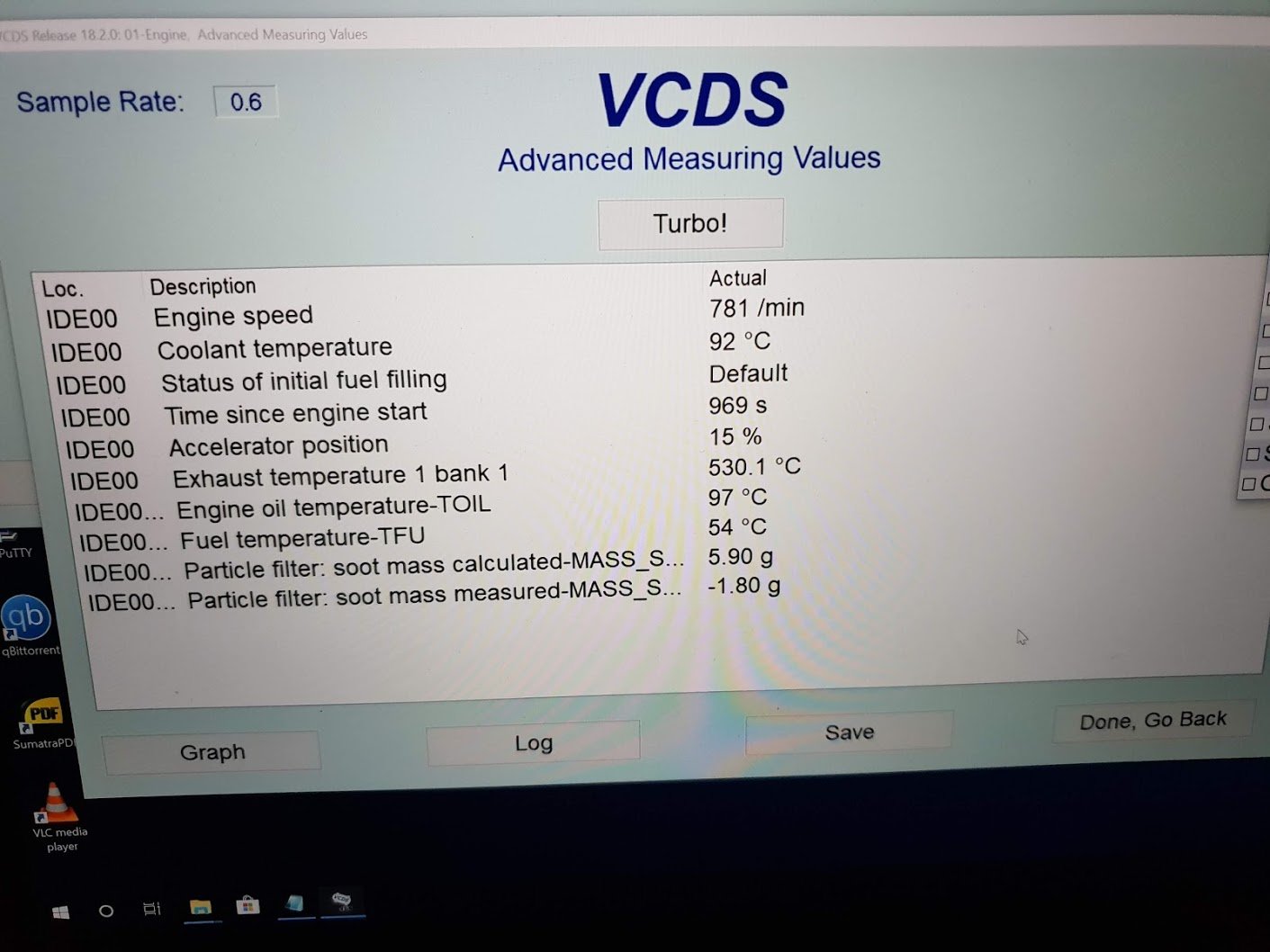

Do you have any idea what could be wrong with mine? Or maybe this is normal? My car was idling at 1000rpm no matter if still or moving /AC off/. I cleaned the DPF and now I noticed that it keeps 1000 rpm only when the car is still moving /neutral gear/, but once I stop / still neutral gear/ it drops down to 770rpm. The sound of the engine changes too, so I know it's real. This is happening with AC turned off, no matter if the engine is hot or cold. In VCDS I can see the temperatures of the engine oil, engine coolant, fuel, air and I don't think there is anything wrong with these sensors.  I can't see any leaks from the engine or any other place too. This is a photo from the sensors when I did the DPF cleaning /10 days ago/.

I notice from the VCDS screen shot, the throttle is at 15%. Can someone who frequently uses VCDS confirm whether this is normal for an idling car?
Accelerator pedal sensor with a problem?
