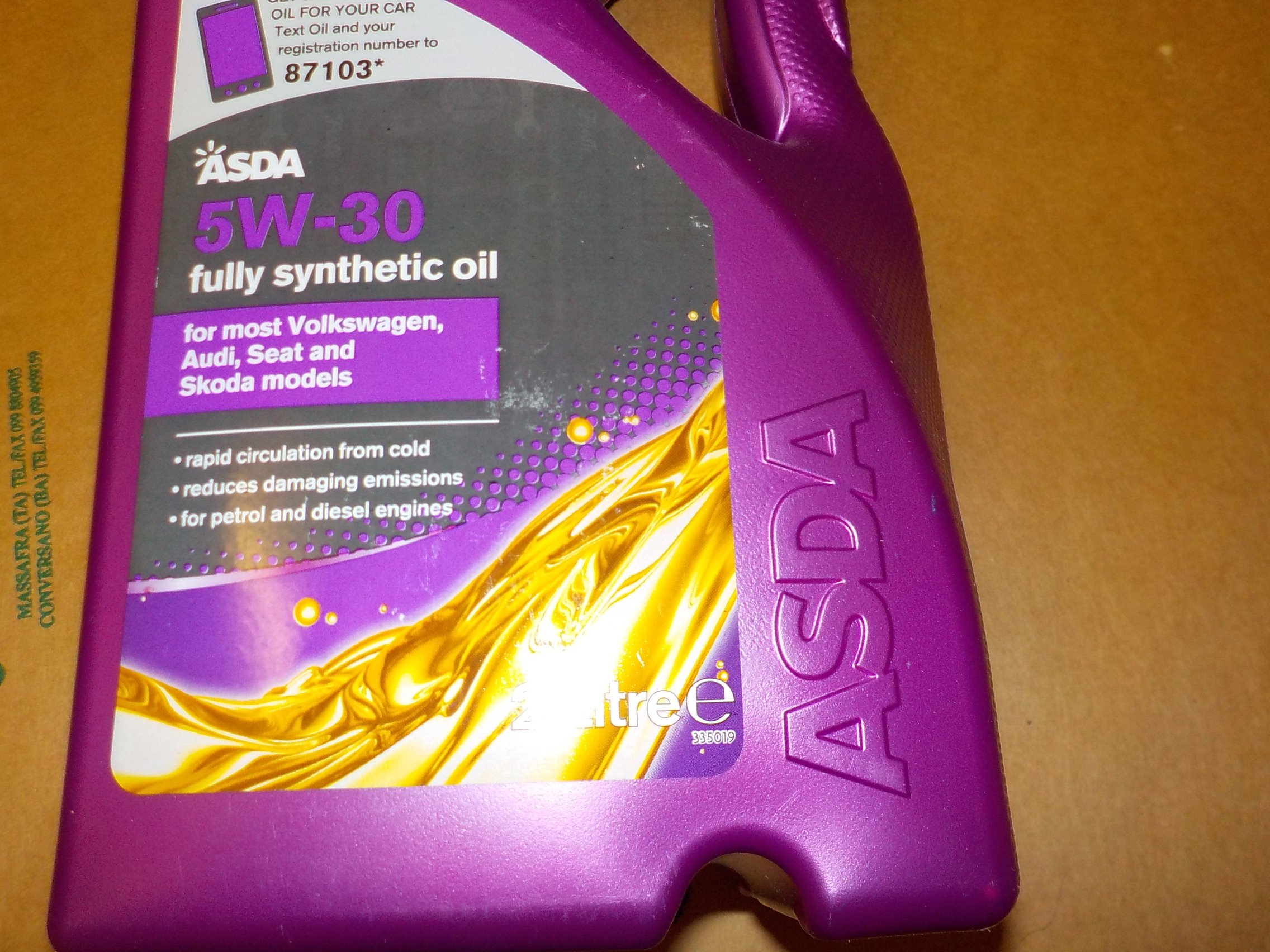

The VW507 you use in the Yeti is  VW504 / 507.   so just fine where it shows VW502 for Fixed Servicing in Petrols and  VW504 for Fixed or Variable.
Asda have to VW504 / 507,  5w 30 FS LL,
not much more cost then the VW502 00 so 5w 40 FS.  Proper oil from an Oil Manufacturer.

Thanks chaps for all the information. Will purchase some oil that can be used for the diesel 110 Yeti and the Fabia 1.2 litre engine. Trip to my local Asda next week to save some money on 5W-30 synthetic oil.
