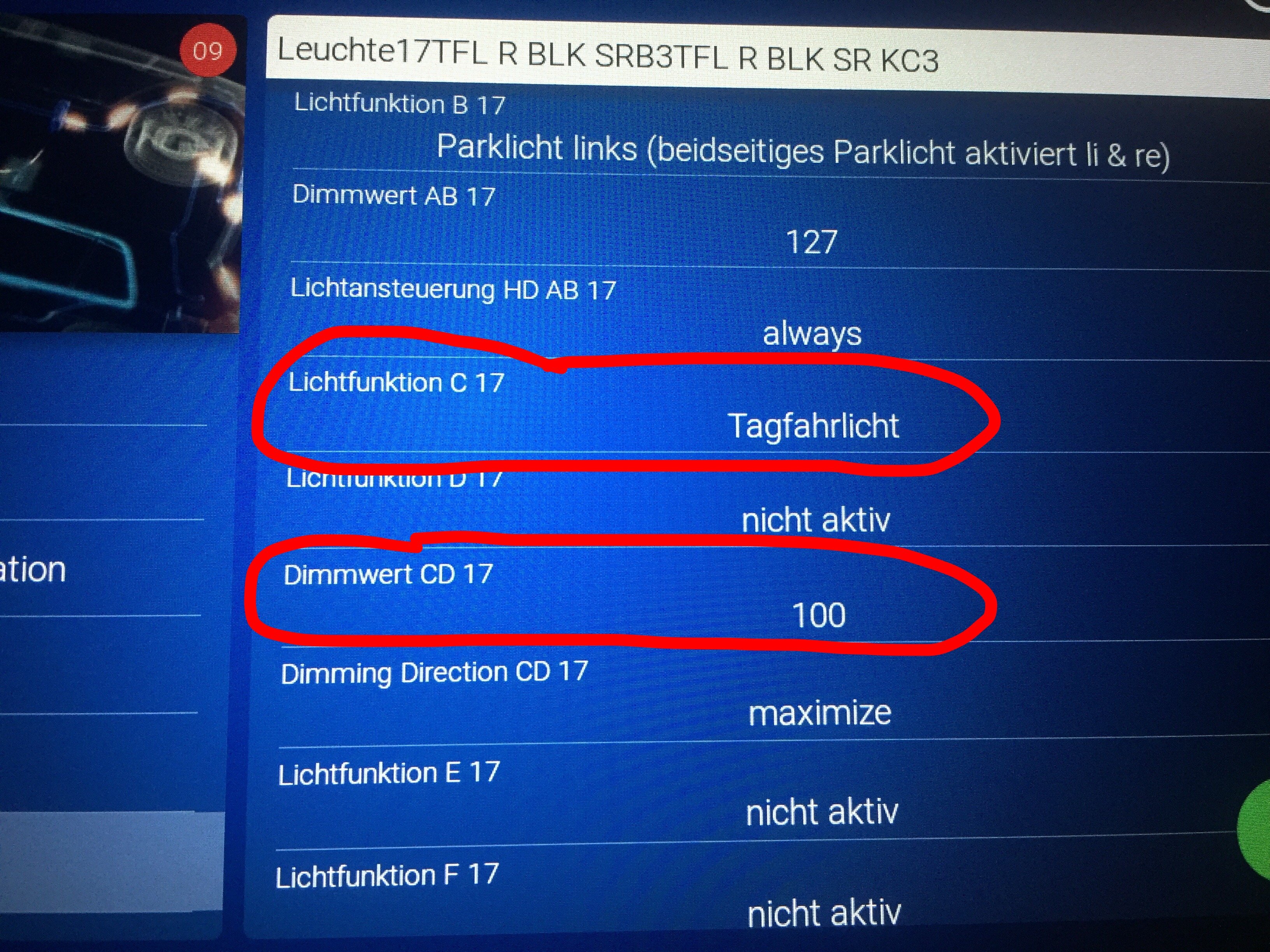

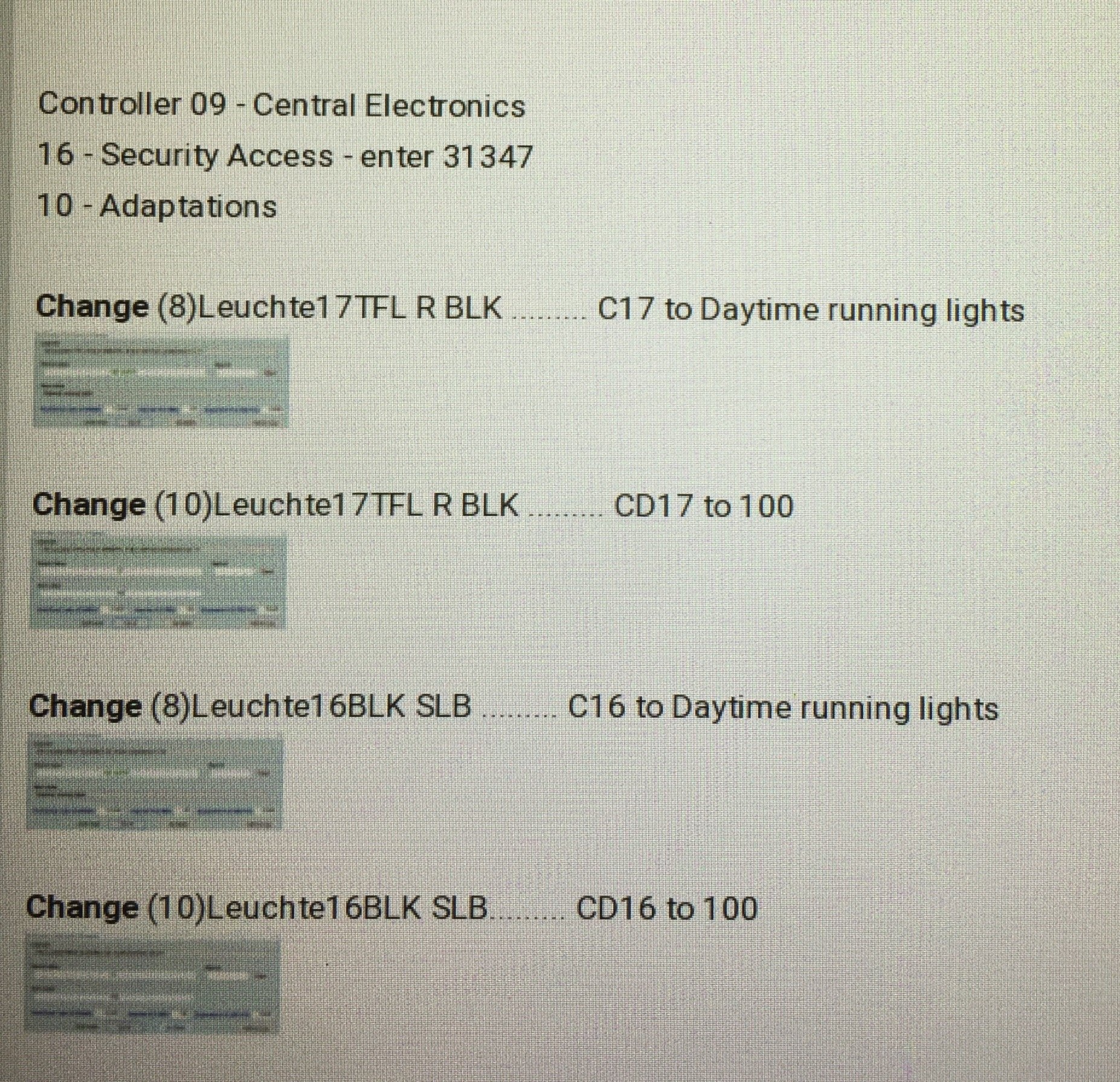

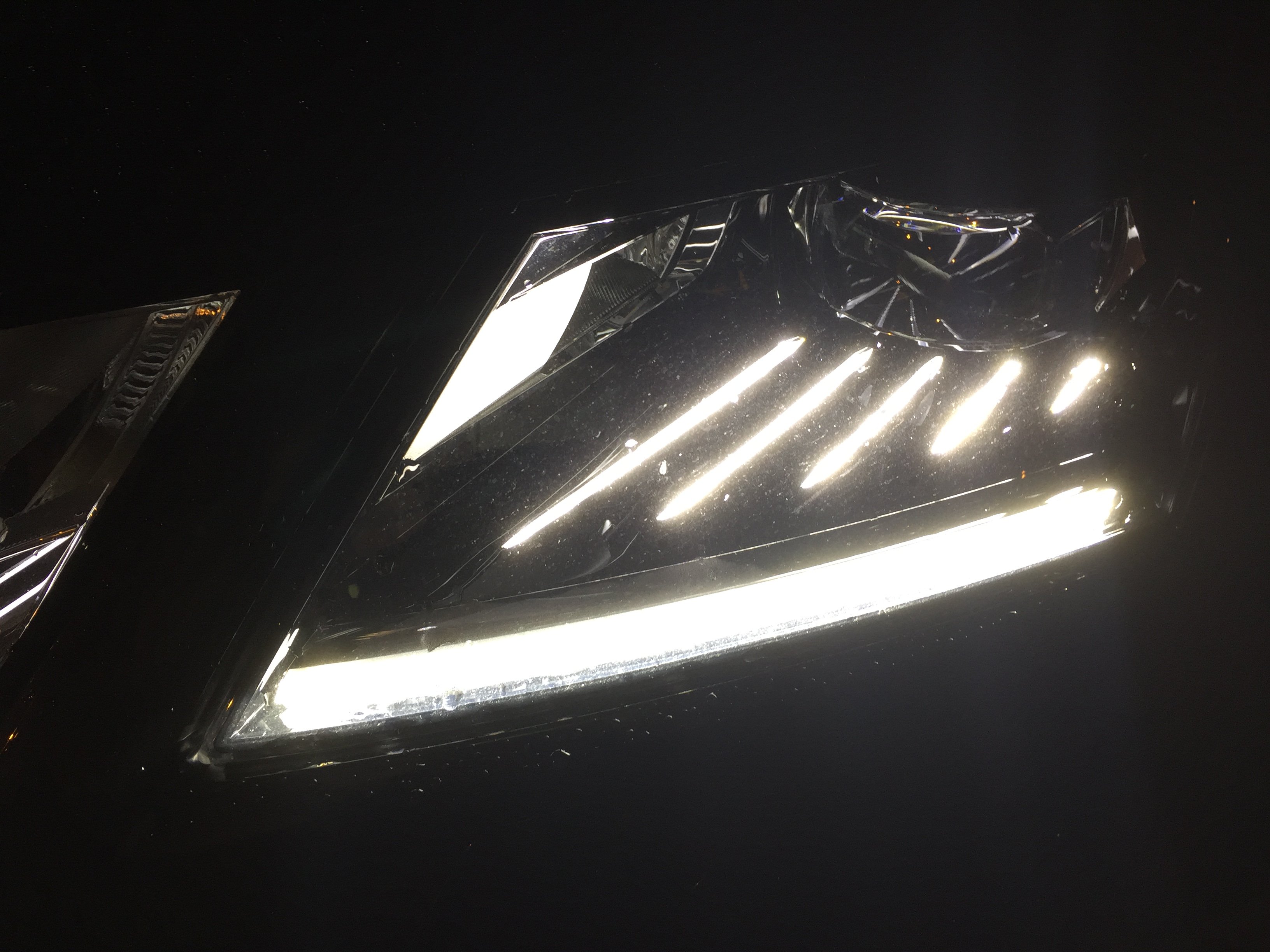

Added ‘eyelashes’ to Daytime Running Lights. Trawled through Superb Forum and found instructions for VCDS. Basically follow those instructions but when you change C17 from ‘Nicht Aktiv’ you need to scroll down to ‘Tagfahrlicht’ and tick that box for Daytime Running Lights. Then change Dimmvert CD17 from 0 to 100. Then press the green tick circle to accept the changes. Repeat this for the other light C16/CD16.
I think this is already in the obdeleven thread. With that said, good effort in just making a clear set of instructions. It’ s a nice mod IMO.  Did it the day I got my facelift back last year.
I want eyelashes on mine but have a pre-facelift, might have to go for some of these instead...
