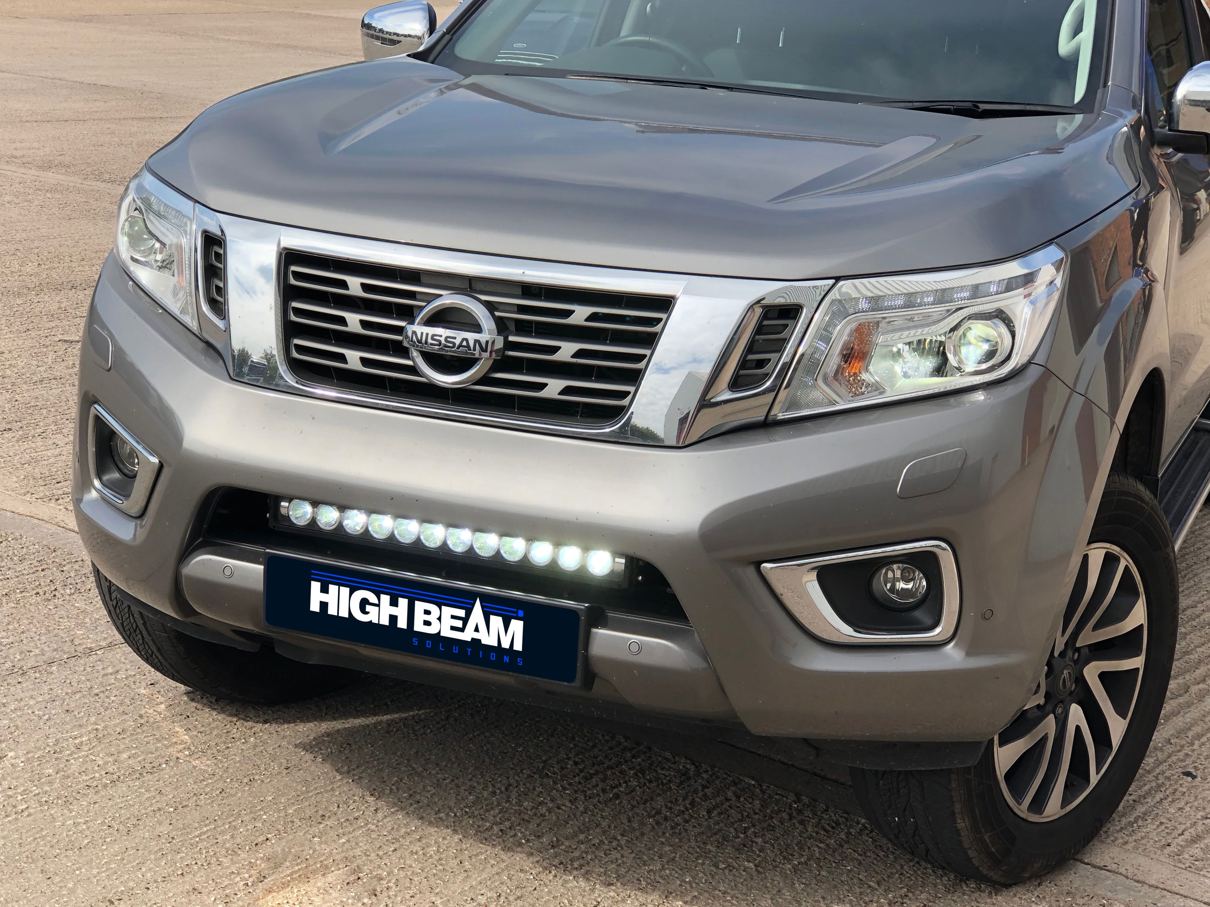

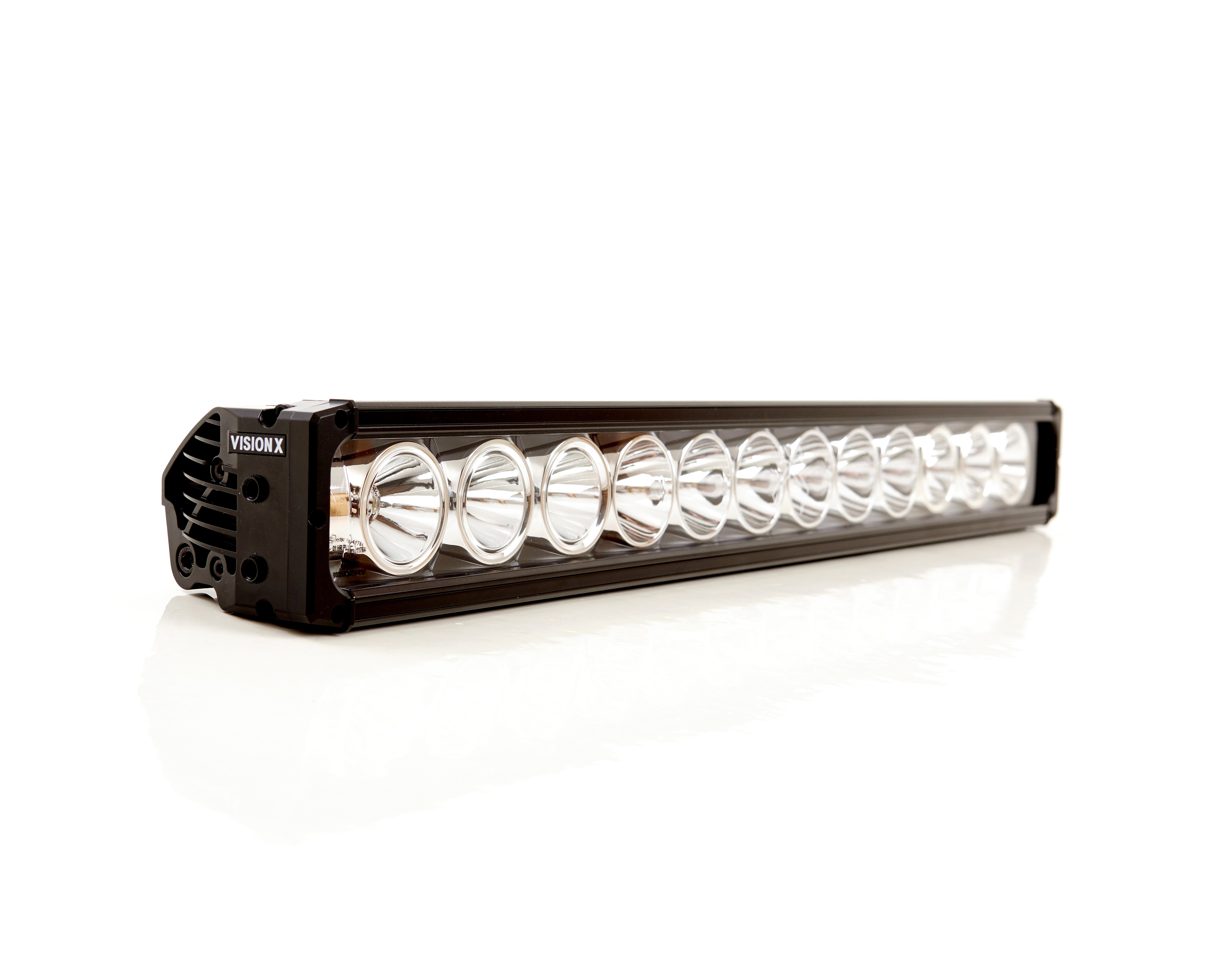

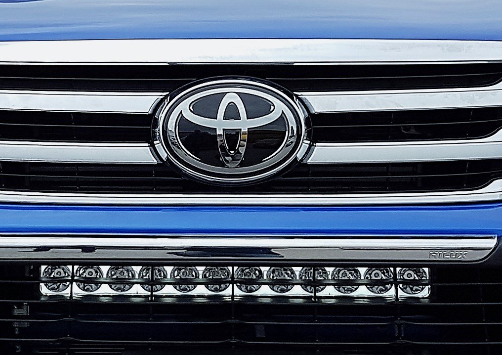

I guess you'll be wanting something as discreet as possible, in which case slimline LED light bars are getting more popular. They're designed more for pick-up trucks and are generally roof mounted, but there are more and more coming on to the market that can be fitted to front bumpers and grills etc.
They're still not what you'd you'd call aesthetically pleasing, but if the OEM set-up isn't enough then ultimately you're going to have to stick something on to the front of your car.
Most are wired up the main beam function, or a separate aftermarket switch mounted inside the car somewhere...
https://www.highbeamsolutions.com/product/vision-x-xpr-12m-custom-grille-kit/
