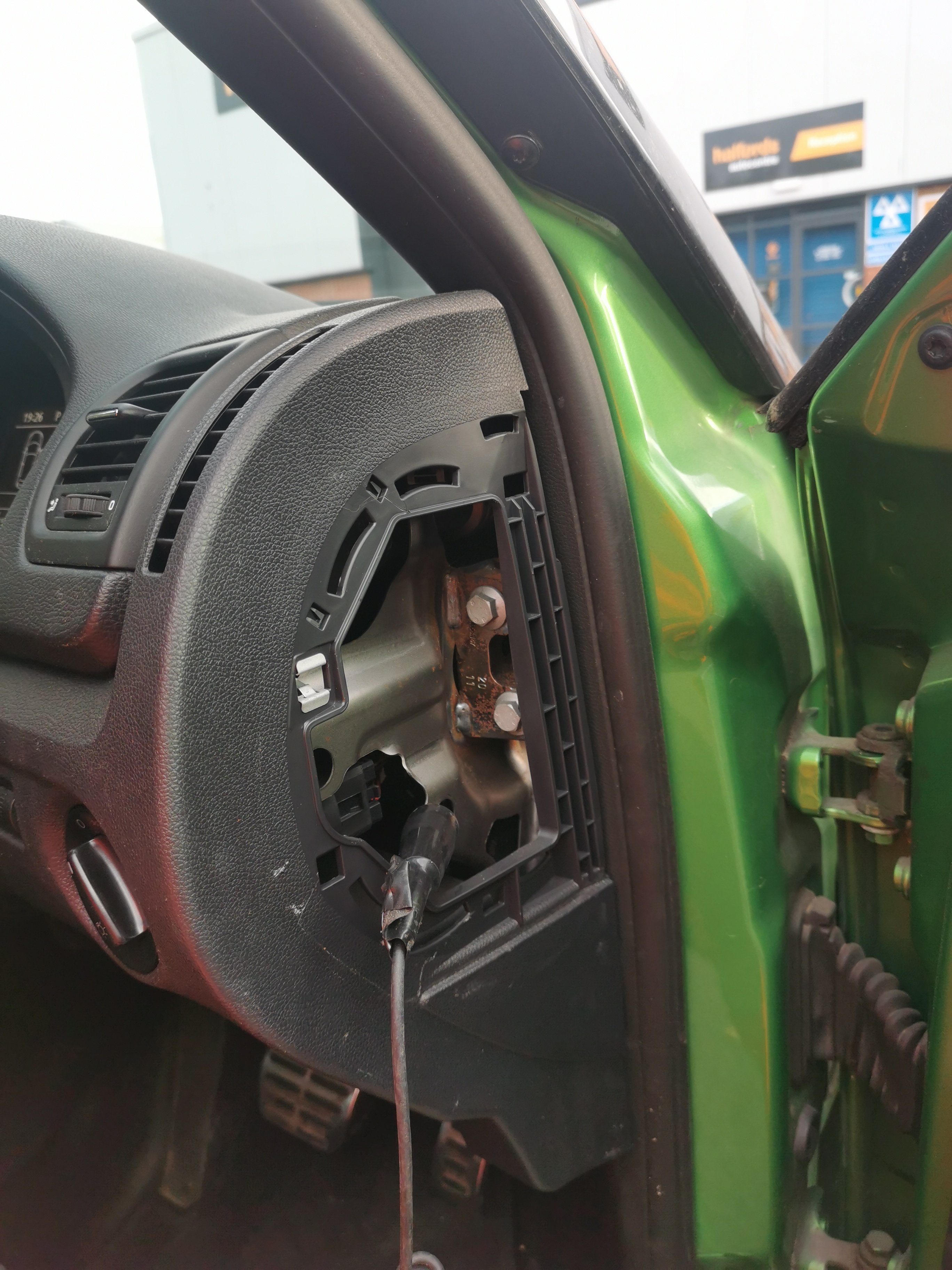

If you take the side panel off to the right of the fuse box there is the main dash / car structure support. I believe there is a grounding spot in there.

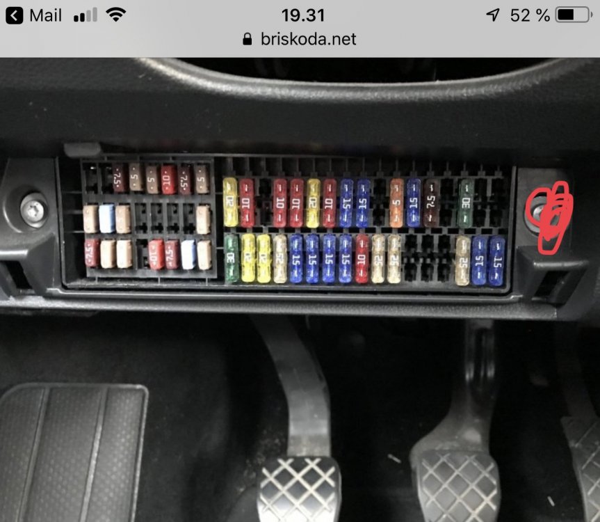

Are you sure, it dont see like the right panel is easy to get off.
I have see some pictures from Rapid, here it seems like panel/fuse box i much longer, and earth is just right to the fuse box.
You could use the side panel but mine is earthed to that torx screw on the right.
You mean this one ?
3 hours ago, Lahan said:
You mean this one ?
Yep that one
THats the one I use as well.  Just get a trim took in and prise it from the front first.

Hard too get off but there you go
