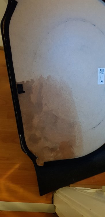

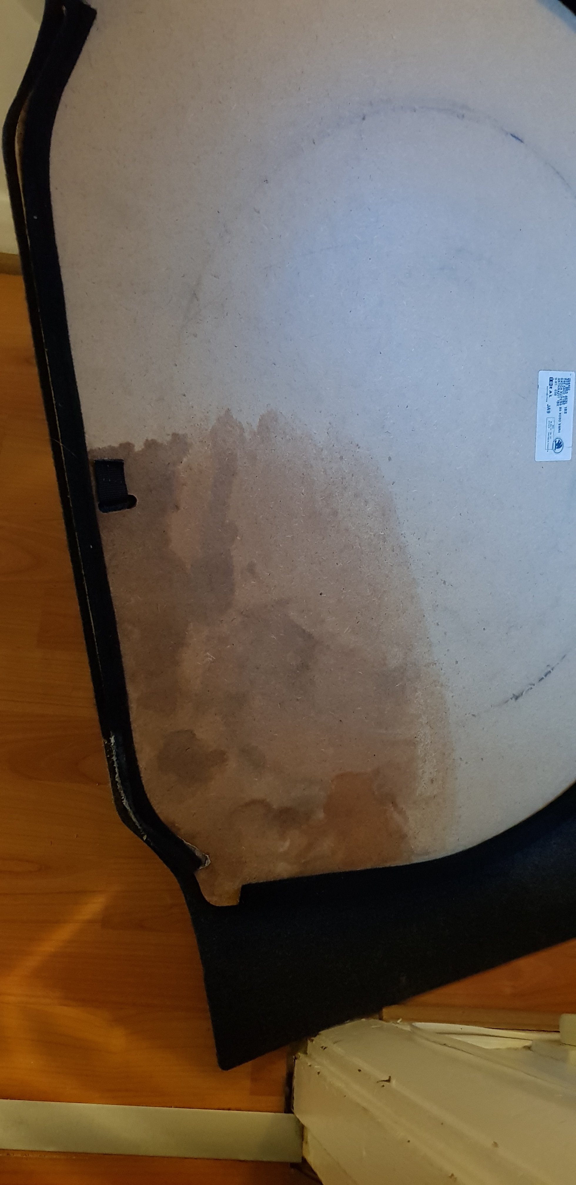

A few weeks ago I added a post stating that I had noted a little bit of water in the spare wheel well, which resulted in a very awful smell in the car.  For the life of me I couldn't locate how the water was getting in.  Now I have and I need some advice!

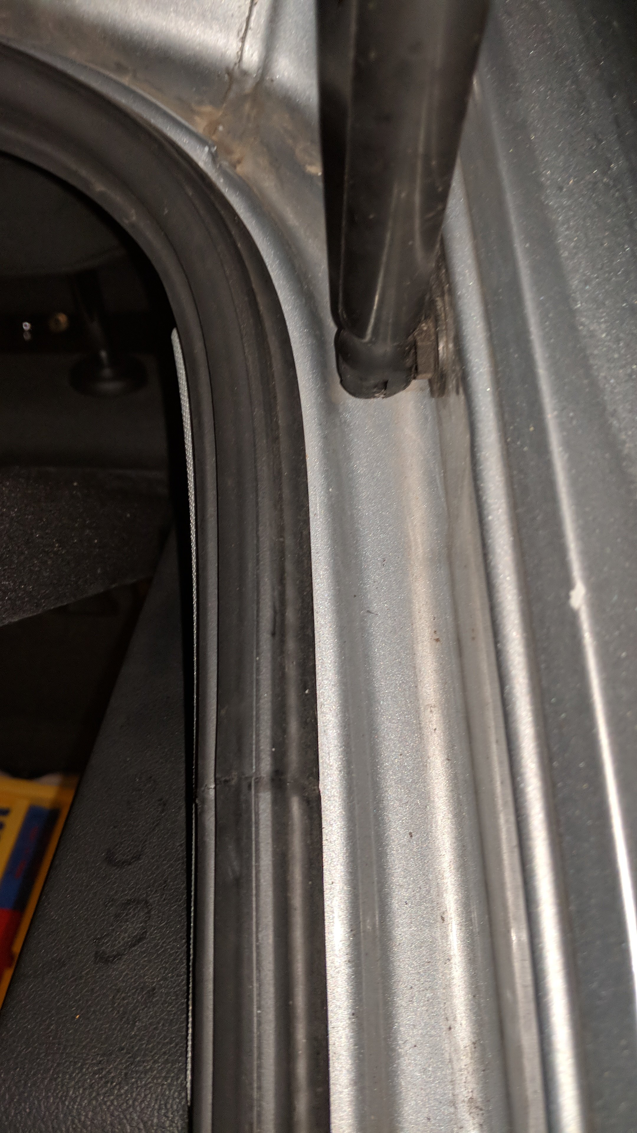

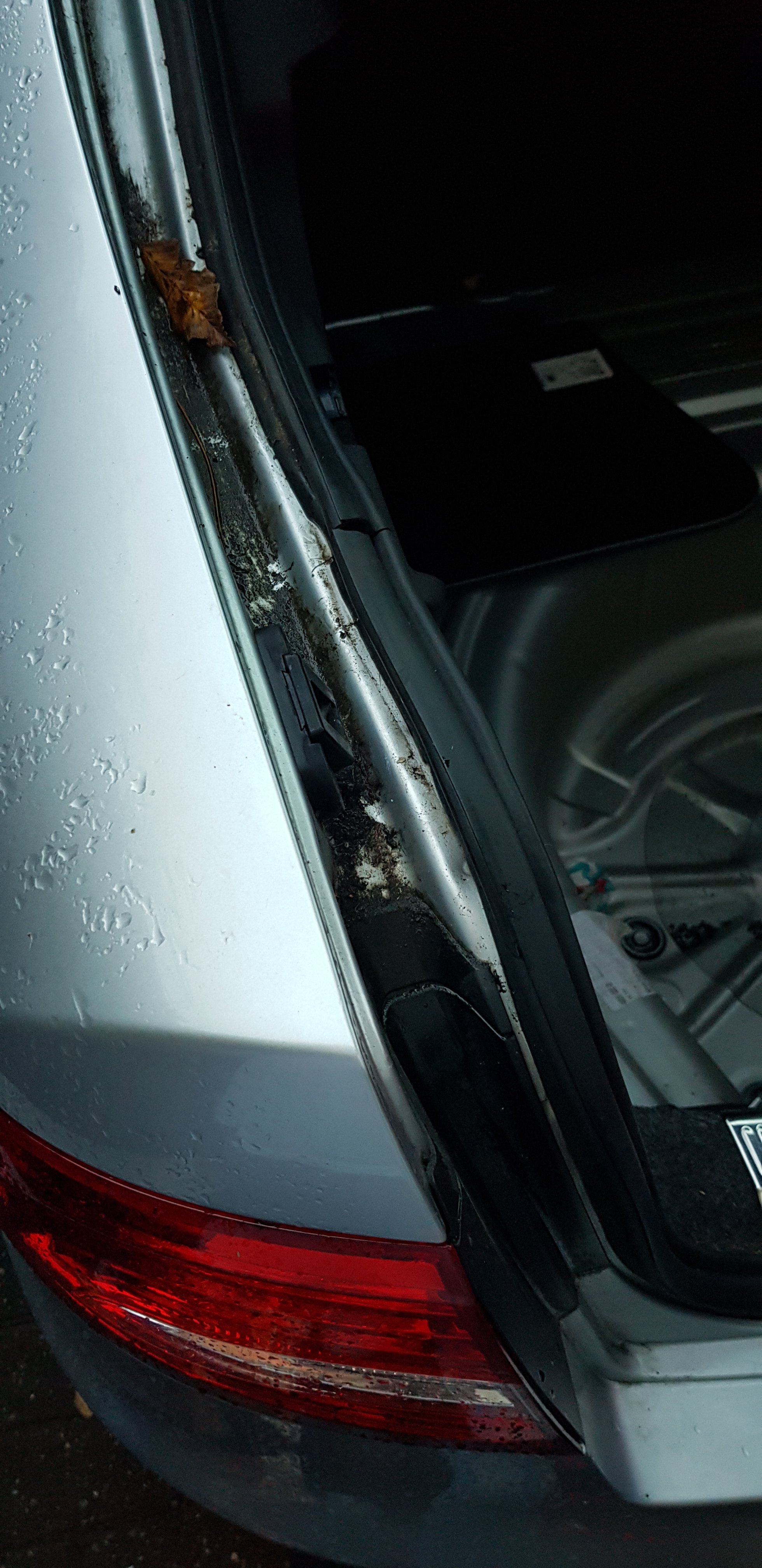

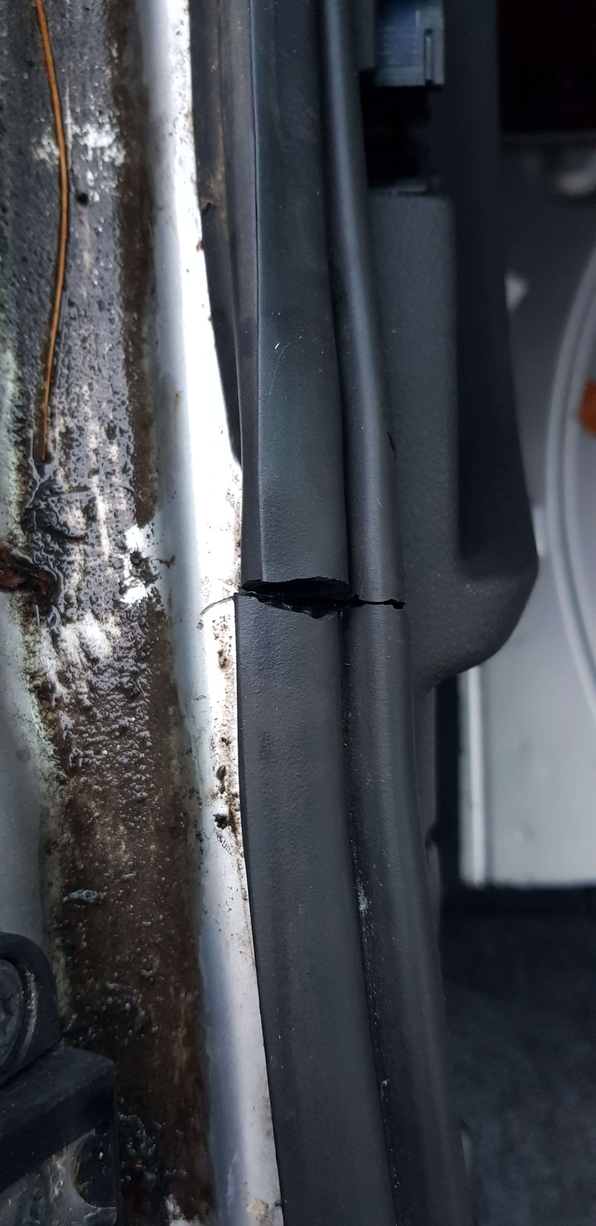

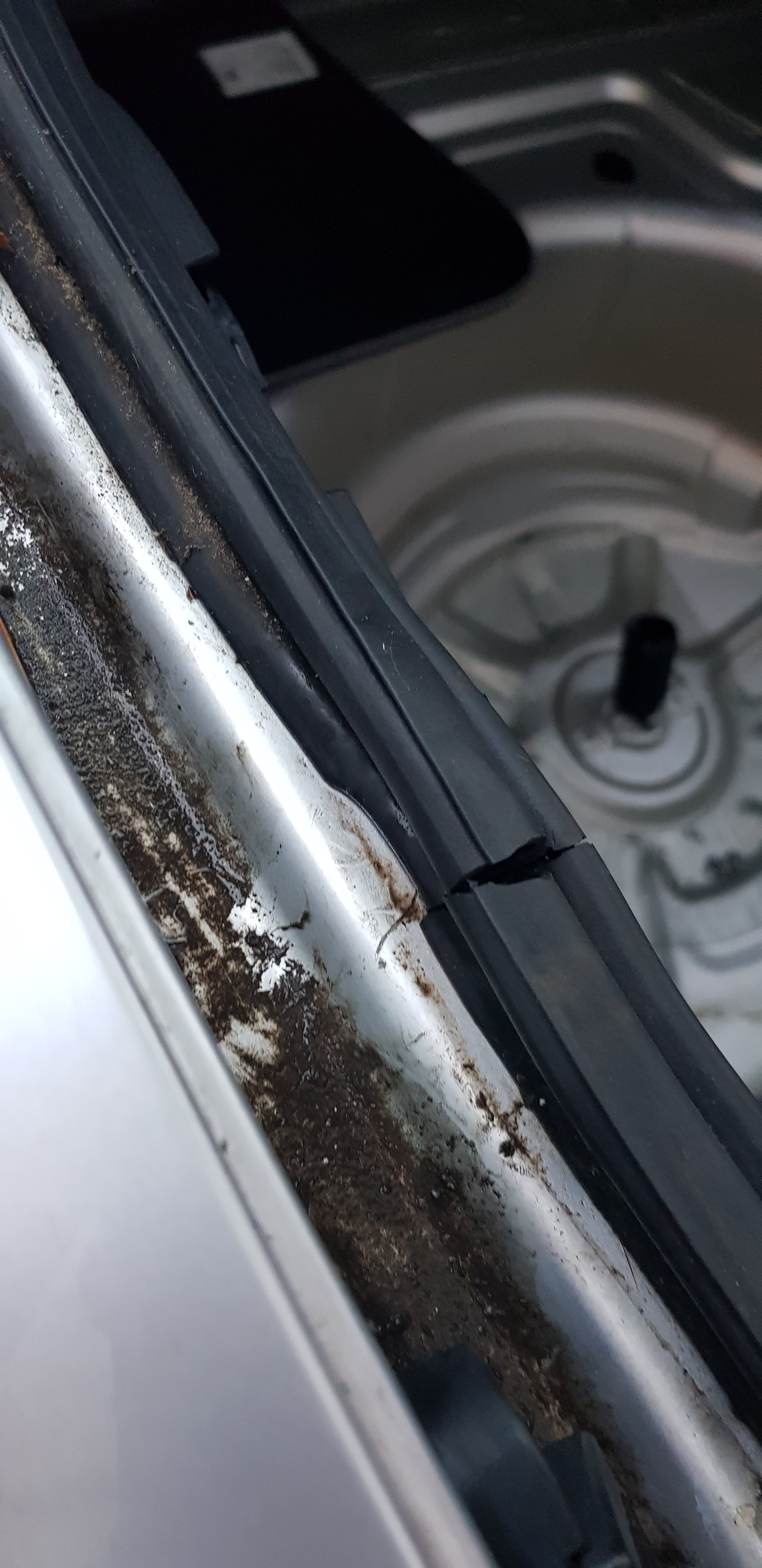

As you can see from the attached photos, water is trickling down the side channel, as it should, on the LHS of the boot however it now appears that some of the water is getting through that cut/tear in the seal
I cant tell if the seal is purposely or accidentally split or if this is the actual design.  Regardless of this the water is going through this gap dripping down the inside of the boot wall, onto the carpet and through into the wheel well.
I seemed to have caught this in time before it did any real damage.  The only damage is the smell, which I can get rid off, and some staining/mould to the wooden base of the boot carpet.  Again I can clean this.
My question and request for advice is - can I use a sealant to seal this gap and seal the rubber to the metal so that the water continues on the right path?  If so what do you recommend.  Is there anything else that can help seal up this gap?  Also would the seal be covered by warranty?  Its a 64 Plate.
You help would be greatly appreciated!

It looks as if the seal has been removed at some point and the "join" has been split.
Mine (suspect same age, model and colour!)  has a join at high level on the right which looks as though it was glued (hard to spot). Other that that it's a continuous seal all the way round. See photo attached.
On yours is it possible to partially pull off the seal, neaten the ends and glue it together - and then carefully push back when glue has dried/cured?
Edited by bigjohn
What glue would you suggest? Is it worth running some sealant along the dipped in side to make it flush and allow the water to by pass?
Edited by thekaratekid
Seals wont be covered by warranty at 4 years.
It would help if you simply cleaned out all that muck in the channels to allow the water to flow down quickly and check it drains away at the bottom. The seal looks as its partly pulled off and not fitted properly. Do as bigjohn suggests.
If you're feeling brave you could pull the seal off completely and refit so any joints/breaks are at the bottom.

Thanks for that!  I'll certainly clean the channels and shall glue the current seal. I may at some point replace it but don't feel brave enough to try and do it myself! Can't understand why the seal would have been removed?  It was only 2 years old when we purchased it.
Any suggestions on type of glue or sealant I should use?
Superglue?

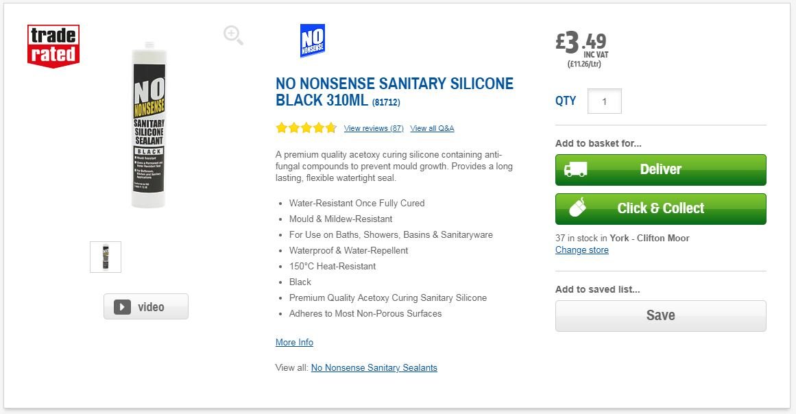

Silicone sealant will be best, that's a big gap to fill.
Push the boat out and pay the extra 50p for the sanitary version, it's black too...
https://www.screwfix.com/p/no-nonsense-sanitary-silicone-black-310ml/81712?tc=ET7&ds_kid=92700023141676082&ds_rl=1249416&ds_rl=1241687&ds_rl=1245250&ds_rl=1247848&ds_rl=1245250&gclid=EAIaIQobChMIybvj58eP3gIVAUwNCh00Qww9EAQYASABEgIvpfD_BwE&gclsrc=aw.ds&dclid=CIXymuvHj94CFZqA3godz9cCOw
You'll need a caulk gun too though, if you don't have one already...

As mentioned, the immediate fix is to get some hot soapy water and a sponge and clean out the channels, they really shouldn't be left to get in that state. If the water can't flow without being impeded it will back up, overflow and fill the seals, spill over into the interior and overtime result in a higher chance of rust.
Whilst your hands are dirty, do the same with the scuttle tray (where the front windscreen wipers live), this area is a magnet for leaves and debris and the drain holes are easily blocked. If the scuttle tray is overwhelmed the water can enter the cars interior through the pollen filter and/or bulk head and there are a lot of electrical components round that area that you don't want to get wet.
If you did feel brave and wanted to renew the seal (this is what I would do), it is a really simple job, it is literally a push fit, no tools or expertise needed, and the best longer term solution.
Edited by silver1011
Silicone sealant a good idea to fill any gaps - but i'd still try and use something to glue/hold/support it together.
My fear with superglue is that'll it'll simply run through the cavernous crack and disappear inside the seal. Silicone sealant will fill the gap and remain flexible enough to move with the seal. It won't look pretty though.
Unless you're able to glue it and then hold it together in situ for a few minutes it'll simply open back up again as soon as you let go, or when the seal is compressed when the boot is shut.
Both are temporary fixes, the only proper long term solution, or a guaranteed water tight solution, is a new seal at £36 plus ten minutes of pulling the old one off and pushing the new one on.
Yep agree for what its worth a new seal isnt too expensive and it will sort it long term. Plus once u pull old seal off area will be easier to clean.  As others have mentioned seals just pull off and push on. They normally give you a piece that connects the 2 ends together that you push into each end of the seal, to help it hold the 2 joining ends down
