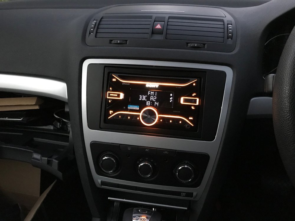

From here you can go two ways, either buy a module to enable the Bolero to use Bluetooth or an aftermarket stereo and fascia plate to get it to fit.  We found the modules a bit expensive so bought a stereo and wiring loom from Halfords and the fascia plate from a website called In Car Tec.  Here’s a picture of how it looks after fitting.  It was challenging to find the fascia plate, I think In Car Tec was our third purchase attempt!
Looks good.:cool:
That looks a very professional fit, it came out all right in the end didn’t it. I had a feeling blue tooth and hands free was probably buried in the new car optional extra list. I think I will eventually go with your idea or one of those double din head units off eBay with possible built in navigation. But it will have to go on my Christmas list. Thanks for your advice.
If you do make sure the faceplate is the 25.5cm width, anything else won’t fit.
