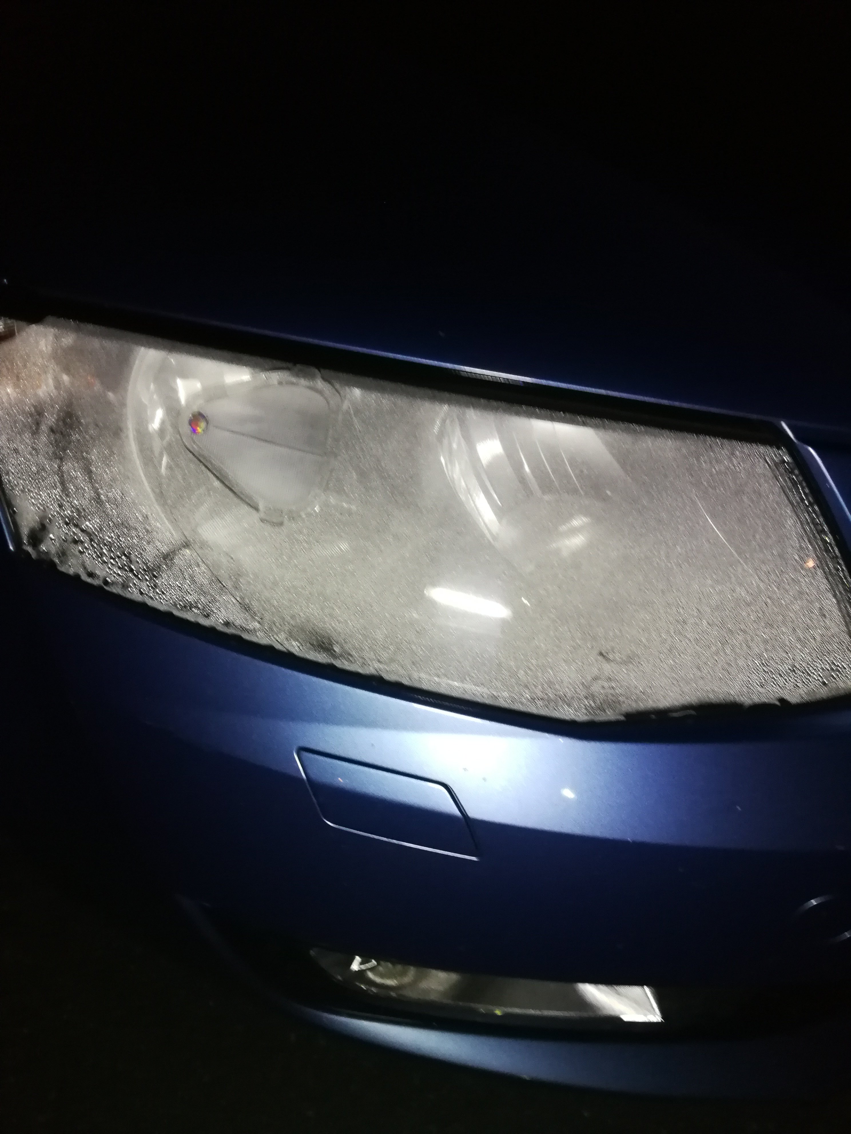

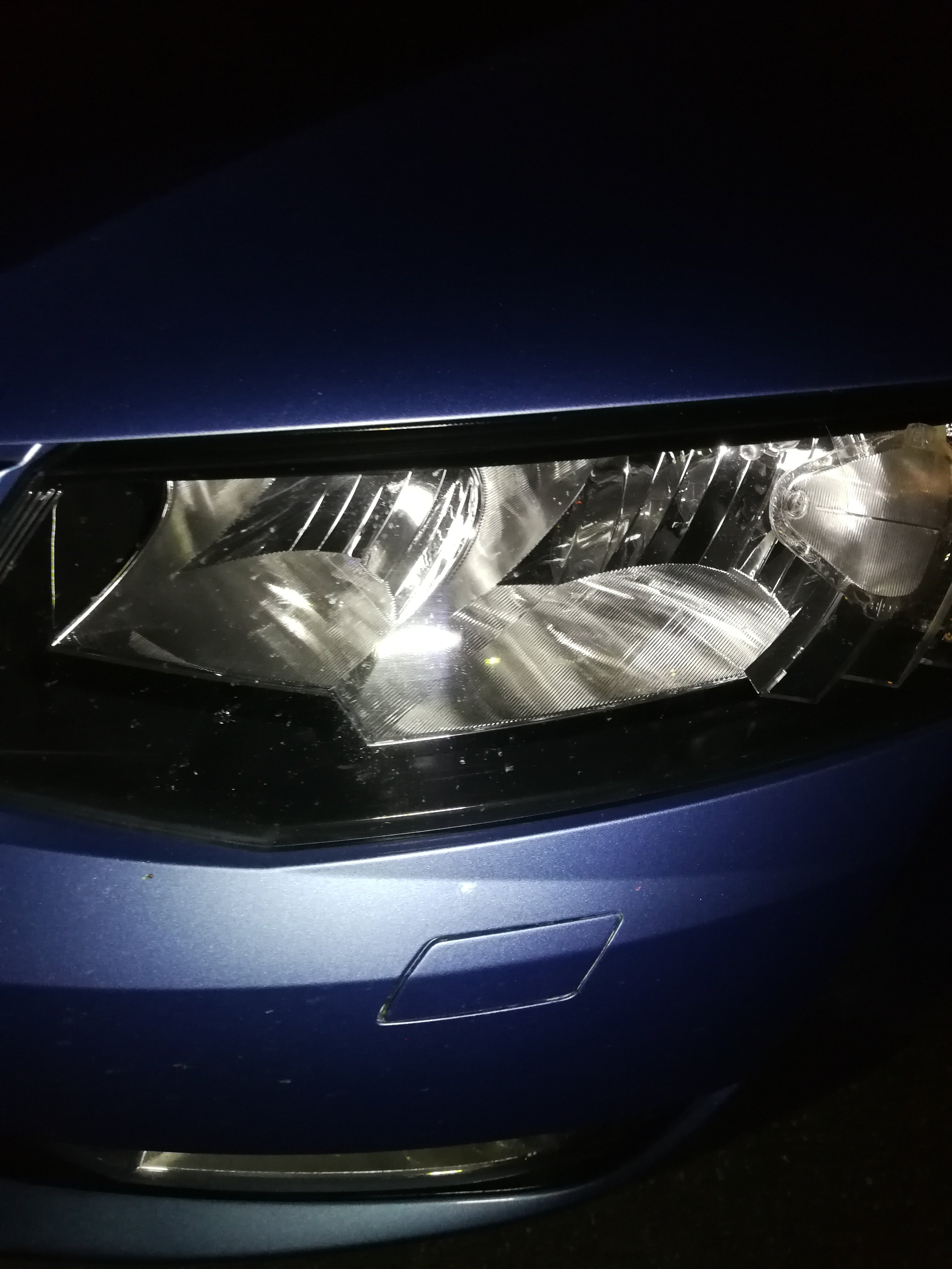

Thanks ahenners...that's  a good piece of advice. Look at the two pictures of my headlamps..it seems lots of water went in.
KevC_derby..the water disappeared when the headlughts are on. But once the lamp is cool..they come back..
guys,do you think my headlamp is damaged...i had it washed  again...and seen the difference inside..did anyone ever repair their headlamp..who does this kind of job! I didnt do any accident, so how come it should have a leak.
