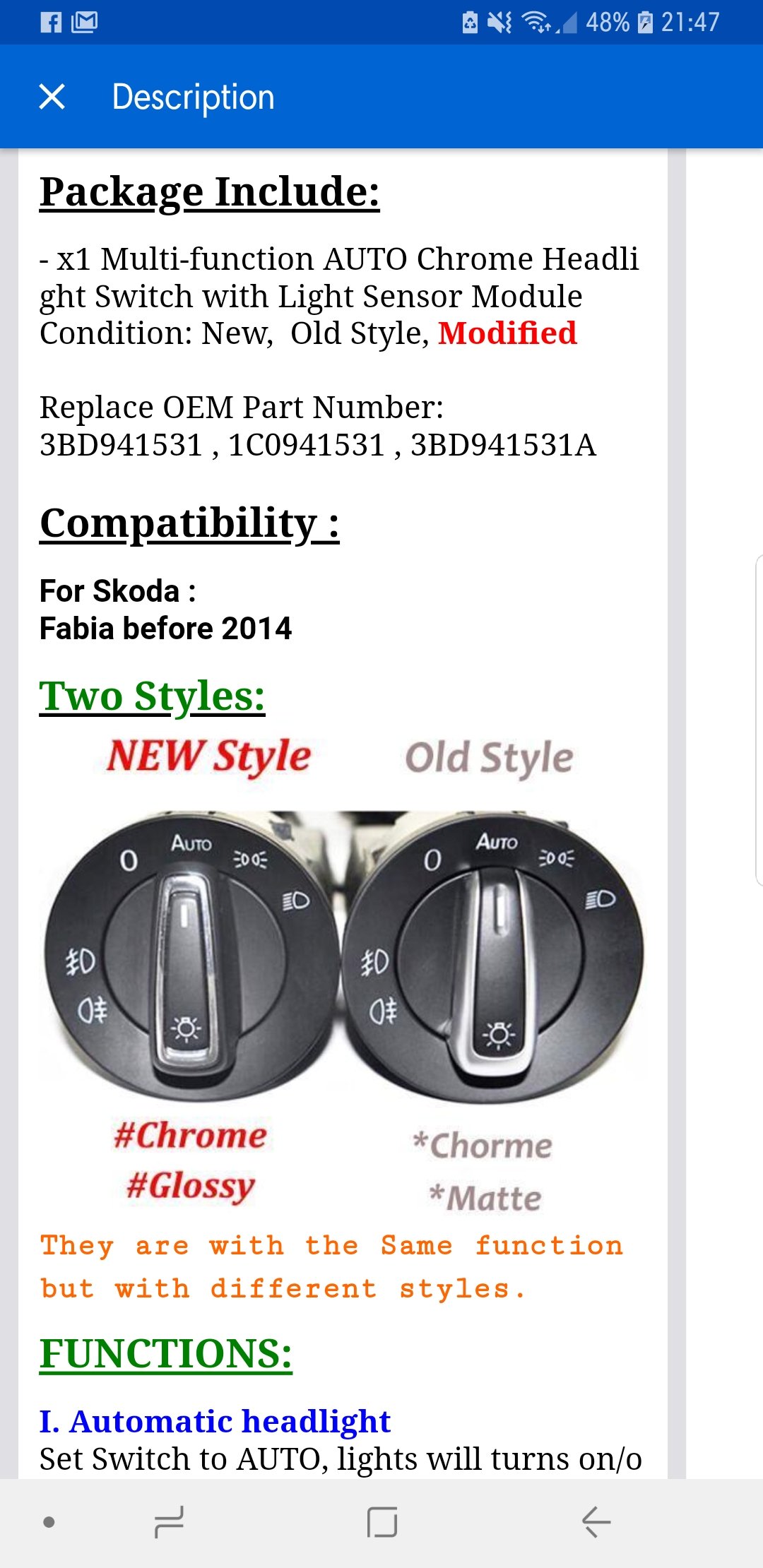

I ordered one off eBay with the standard fitting with a sensor built in but I don't know the serial number of the switch
Edited by Rhys_1994
Got a link
I got it through the app but it does say it's compatible, I just don't know how to activate it
Do you have the link

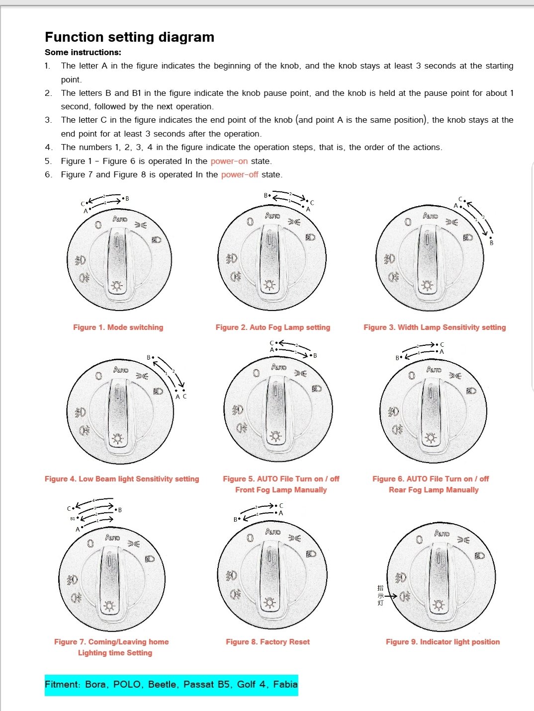

Did you get this sorted? I will have a look at my versions instructions for you if not.
Still no luck I even have a manual and it's not activating it :(
To get mine working I had to do the leaving home setting with the ignition OFF, which I took as no key in or anything:
- Start with it pointing 0 then after a few seconds
- move it to AUTO, leave it for one second
-Move it to 0, leave for one second
-back to AUTO for one second
-then back to 0 for a few seconds, and that supposedly turns it on.
Factory reset might help it too again with the power OFF:
- Leave at AUTO for a few seconds
- Move to 0 for one second
- Back to AUTO for a few seconds.

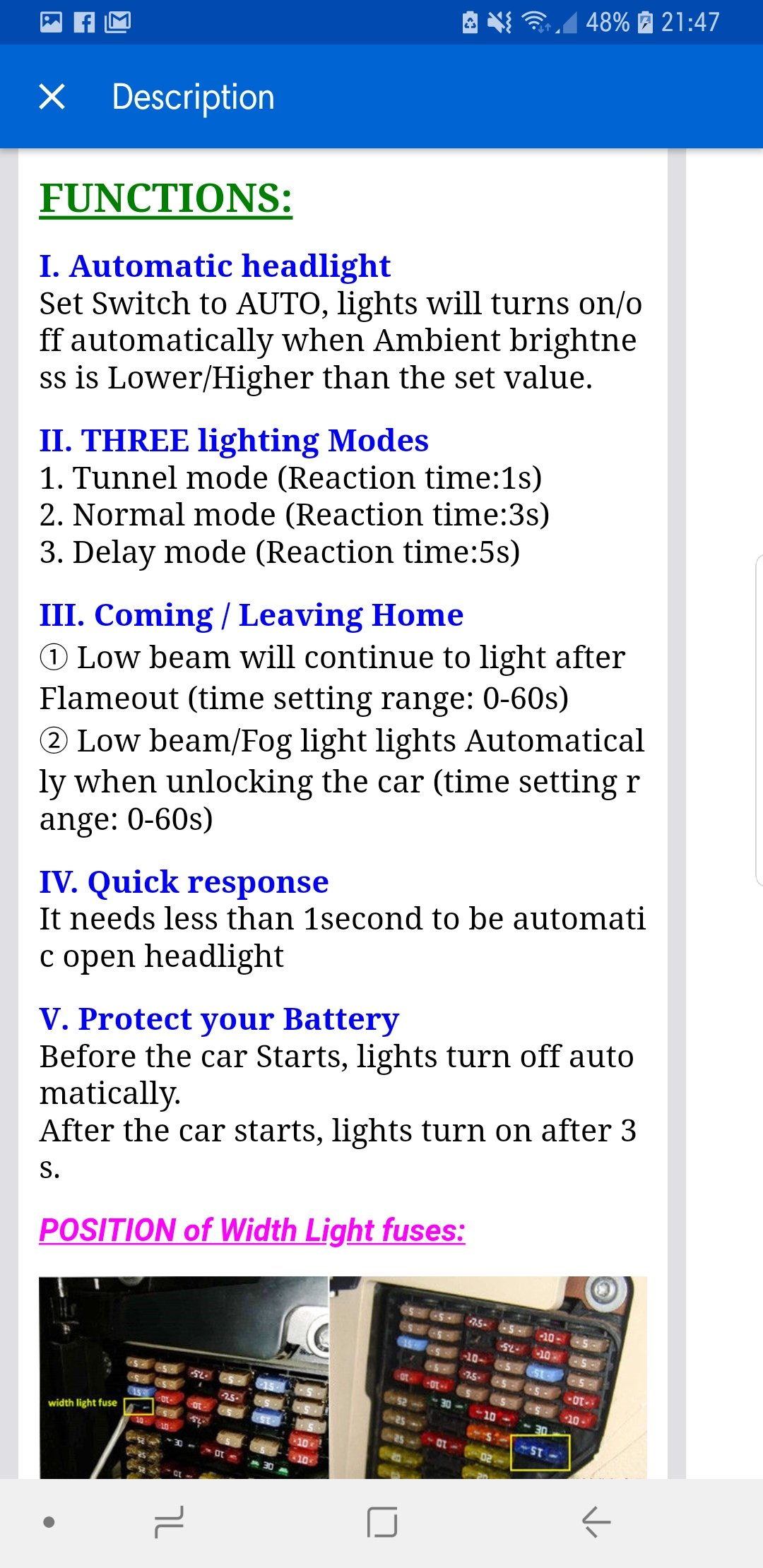

Another Issue I had might be worth checking is fuse 17 had blown when I first installed it, and killed the side lights, this seemed to stop me being able to set the leaving coming home lights. I installed a 7.5amp instead of the 5amp and all started working fine.

youve blew a fuse if they arent working you need to upgrade the fuse to a 7.5

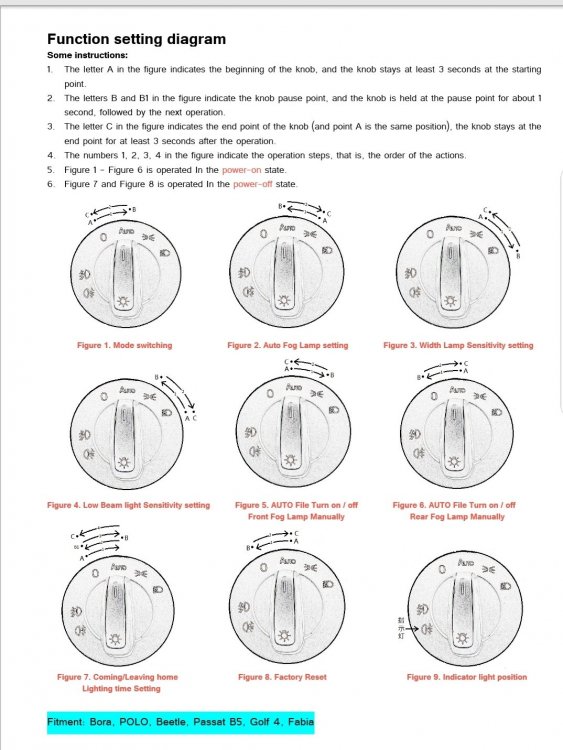

Here is my instruction manual I got from the company.
