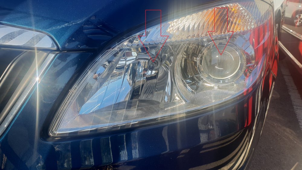

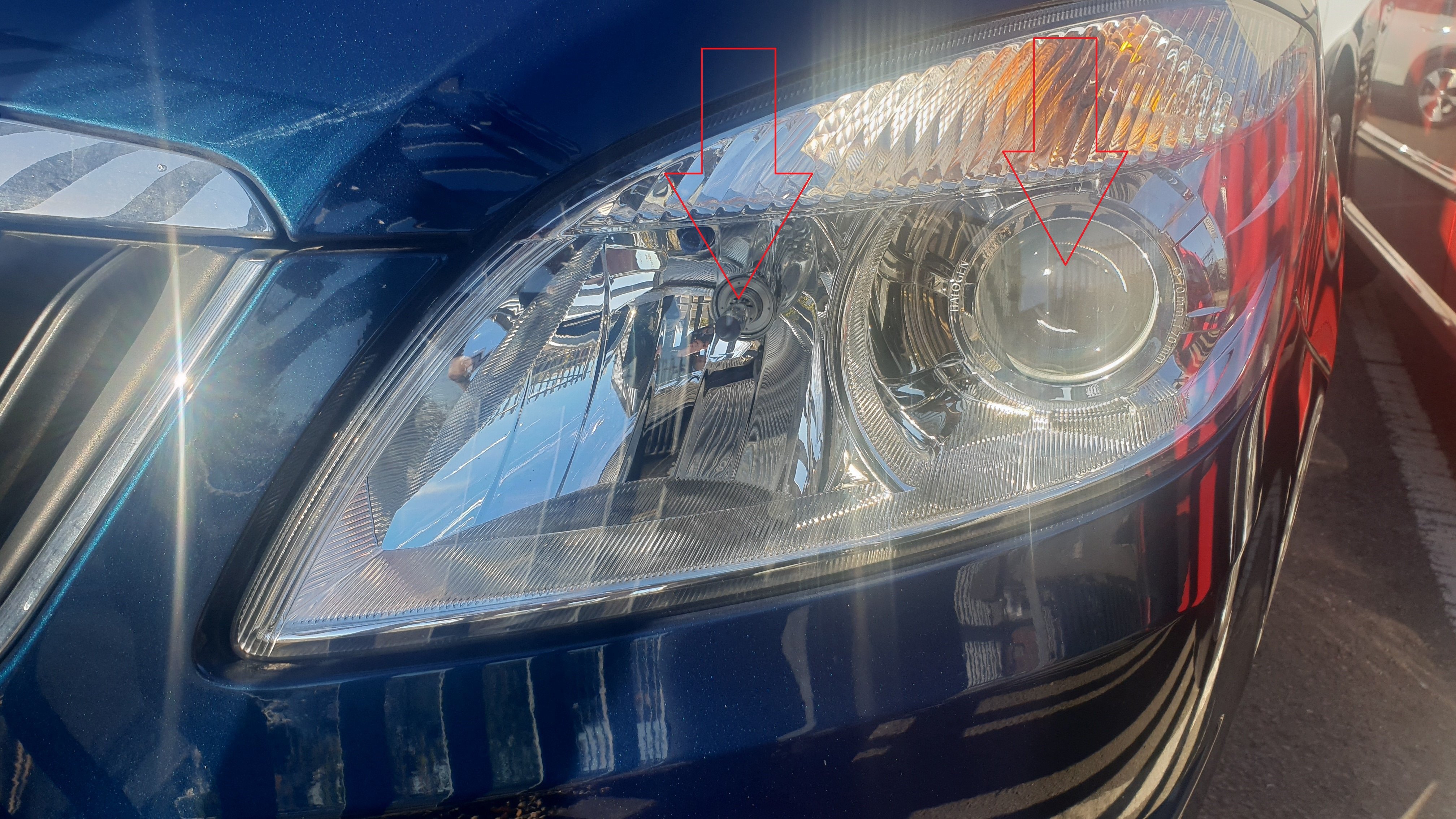

Same bulb for dipped and high? H7 it's the single filament bulb...
Two bulbs per headlamp.
Not all are as pictured above
My Monte Carlo is the same bulb (it's done by a shutter)
Are you sure?
Afaik pre face lift before 2010 had the single bulb/shutter and with the face lift came a wider headlight with two  seperate bulbs, h7 projector dip and h7 reflector main as photo. I would be surprised if a 2014 monte carlo had the old pathetic light output shutter system.
Edited by xman
13 hours ago, xman said:
Are you sure?
Monte Carlo came with black headlight housing as standard, it's a H7 single bulb projector with shutter (and is why the lights are shocking).
Dependent on model
Edited by Kgod1991
