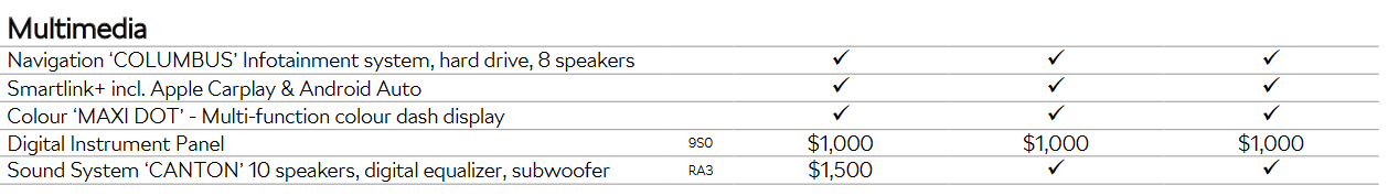

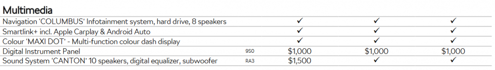

If anyone could help or advise what the requirements would be, that would be greatly appreciated. I have attached the screenshot of the options list showing what Multimedia comes standard. Look at the 2nd Column as thats the Manual option.
