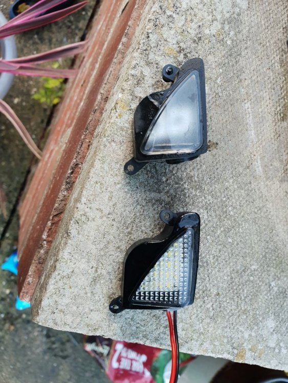

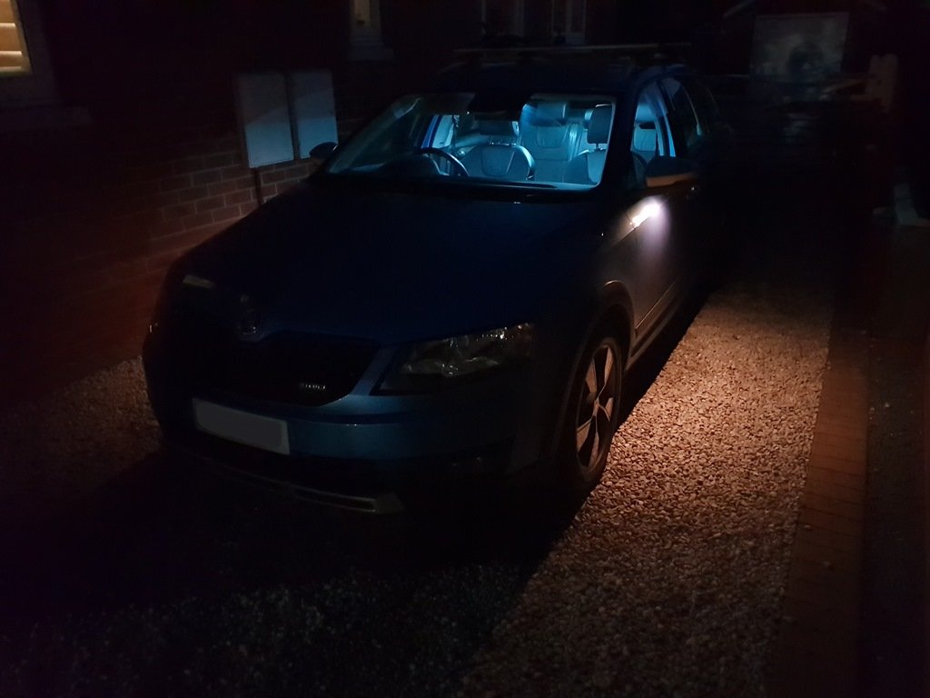

Before (halogen)

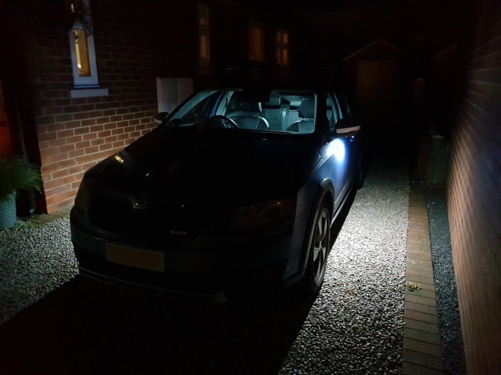

After (LED)

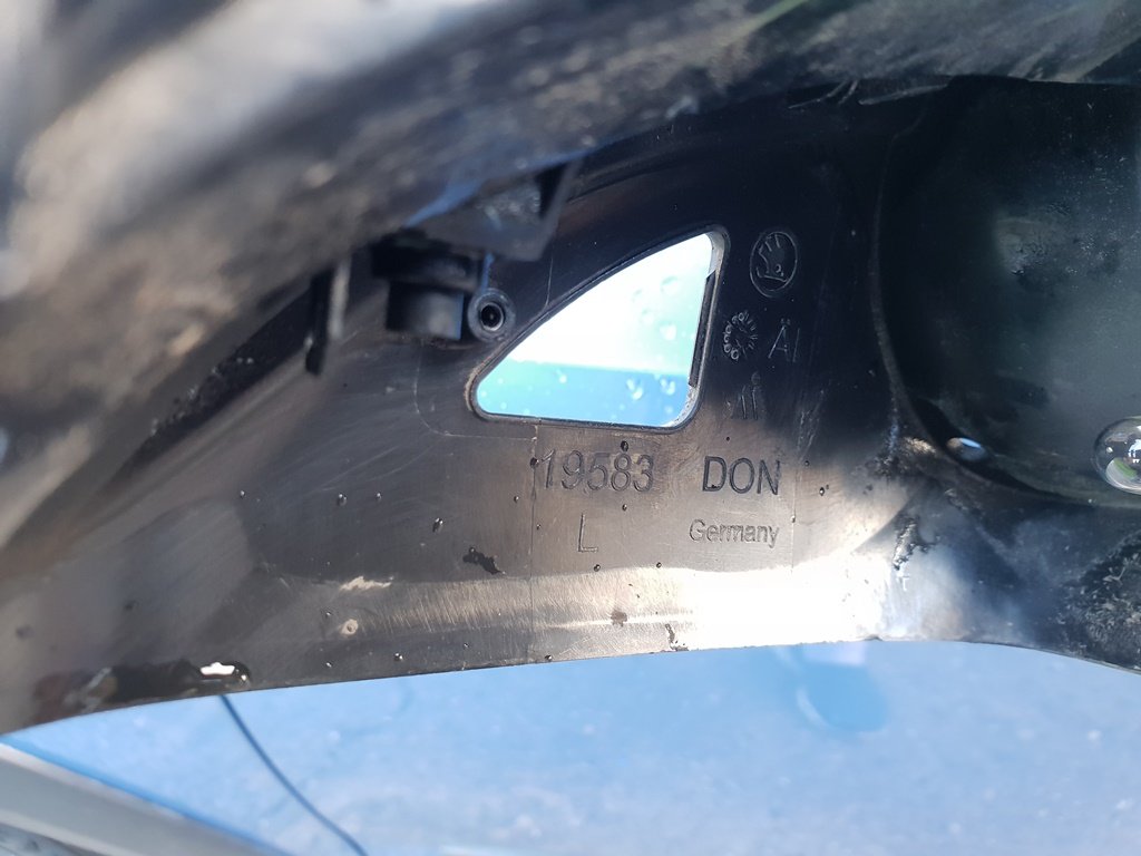

Plastic lip that needed removing (on the right )

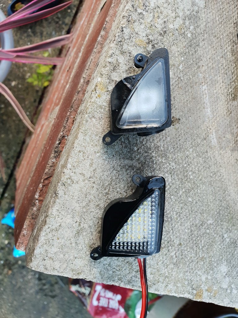

New unit surround painted black like the OEM one

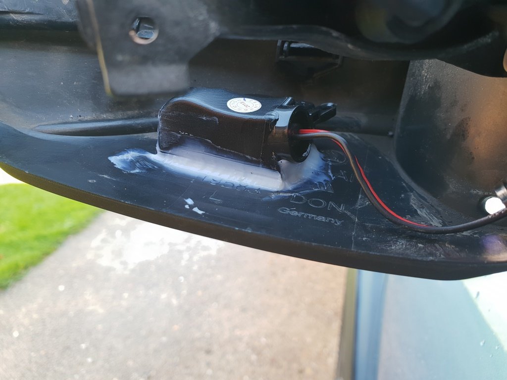

Glued in place as well as single Torx screw
