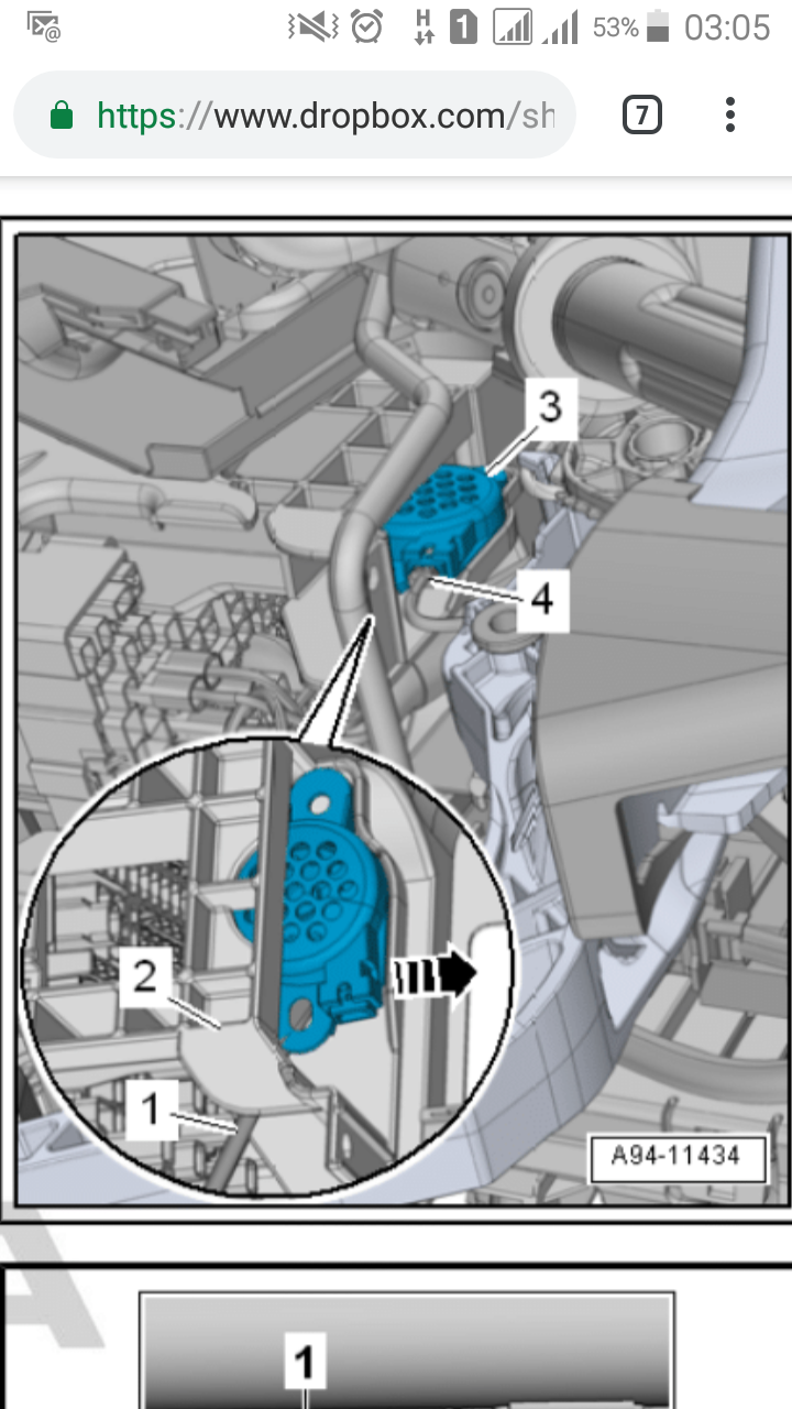

Well, I found in an online workshop manual for Skoda Octavia III 2014 the attached picture, it shows a hidden buzzer in the proximity of the fusebox, now I cannot find that specific place on my car as I don't know if that workshop manual still applies for cars made in 2018. For what it's worth, in that picture, the buzzer has the code H22.
That long, light blue item looks like a foot pedal. So the item in dark blue is going to be right up underneath dashboard. Very hard to get a look at without some kind of inspection tool.
I highly doubt anyone has removed a buzzer and if it just fell out, it would be sat in the drivers footwell. More likely it wasn't plugged in properly from the factory and vibrations have just worked the plug loose.
