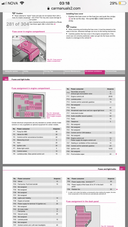

this is tha fuse box in the hood i dont know much about cars so are you talking about number 11 engine control unit
  • Sponsor
Yes, that one.

Dear all,
I am having what seems to an electical issue that seems to fit here.
Fan 1 Control circuit short to ground
Motor for Intake Manifold Flap  Open or Short to Ground
I have replaced both but issue still present, seem to be a wirering issue or a problem with the relay J271.
Can someone help me locate it, is it any of the relays show in the picture?
Skoda Octavia Mk2 2005 BKD
Thanks Martin
