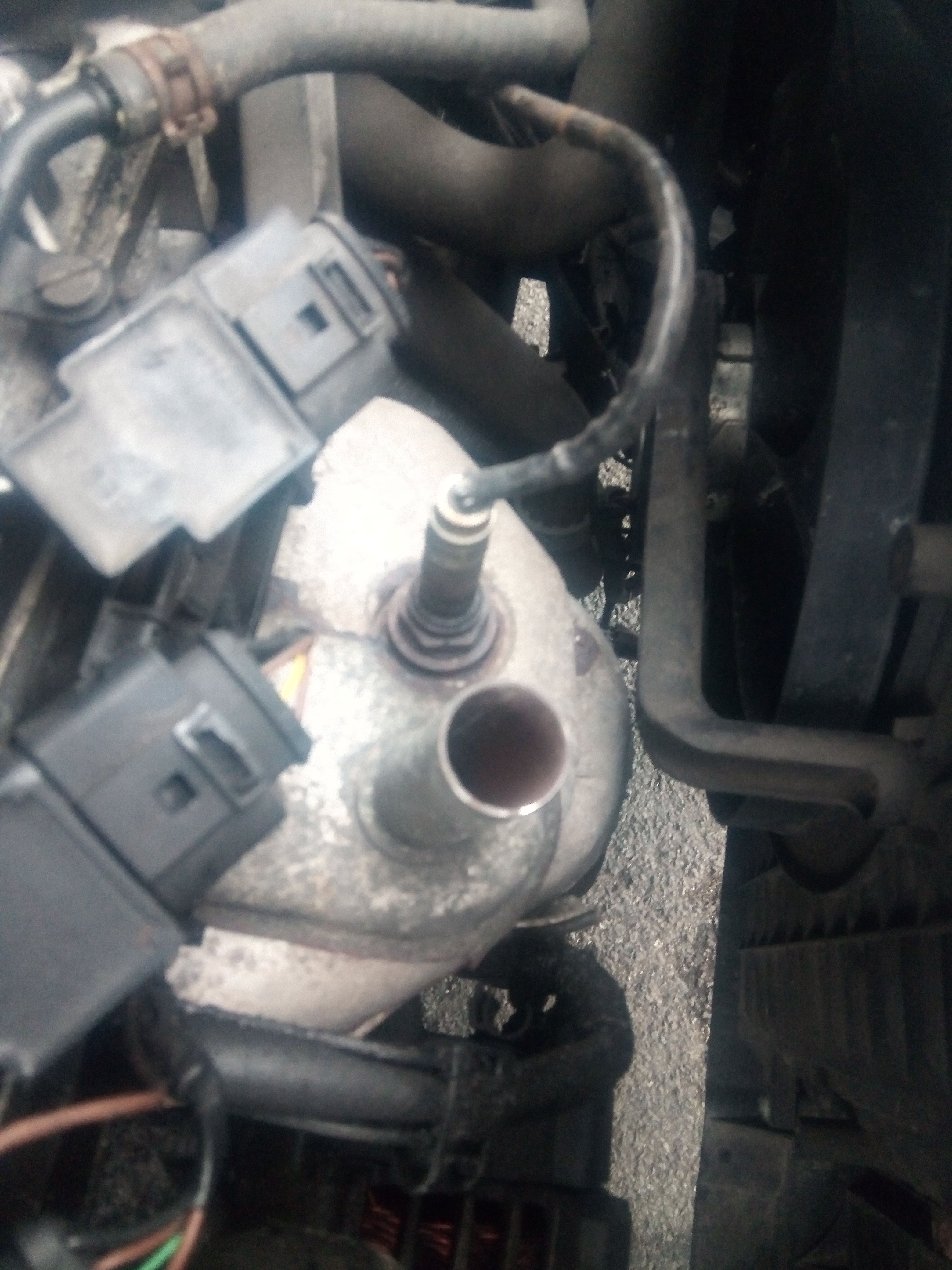

Can anyone tell me what sensor this is please

Right in the middle of that picture is your pre-cat oxygen sensor.
Not sure what the relevance of the title is? Are you looking for the (intake) Manifold Absolute Pressure sensor?
What car are we talking about? Mk1 Fabia 1.2?
Yeah it's the MK 1 fella, the barometric pressure was an error code, I've changed lambda sensor and cam shaft sensor and the cars still got  o power and will only rev to 3000 , would replacement of the pre cat fix my issues do you think.ps many thanks for the speedy reply.

Presumably when you say you've changed lambda sensor you mean the post-cat one?  Why did you change that?
