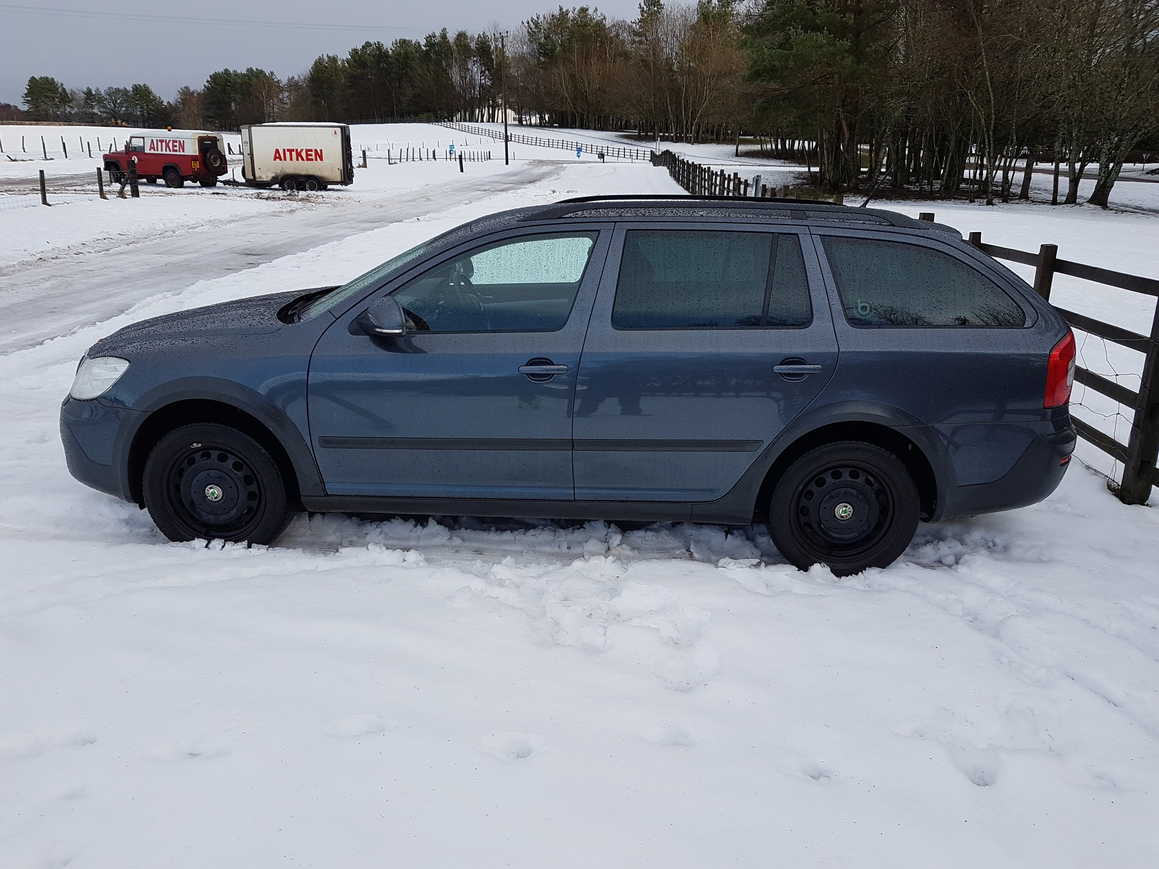

First set of Nokian Cold Weather tyres were 17 on original Proteus alloys. Very good traction, but found in really deep snow the wheel arches would get filled with snow and then freeze solid.
Since 2012 I've been using 16 Nokian on steel wheels and never experienced the above. I also found there was a far greater choice in tyres at a far lower price than I got with 17.
This was taken earlier this year and will give you an idea if you could live with the 'gap' over 17.

As fitted in the phot above.
