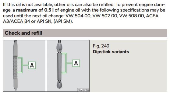

From the manual...

Either way you need 5W-30, but it is important to ensure than the oil conforms to one of the VW specifications as detailed in the manual, as pictured above.
The VW 502 00, VW 504 00, VW 508 00 specifications will be on the back of the bottle.
