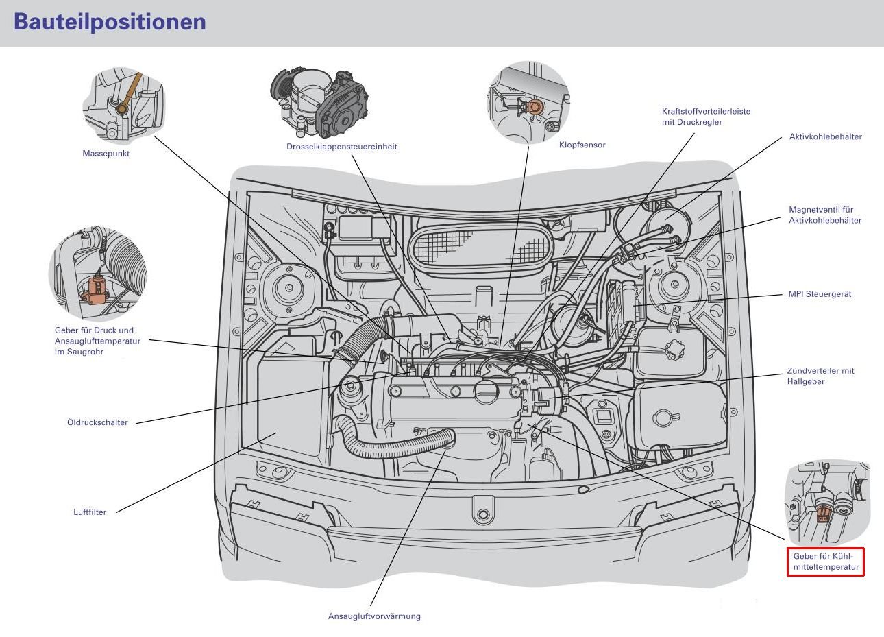

Check the temperature coolant sensor.
Thanks. Do you know where this sensor is located? I'm not the owner of the car, but I ask for a friend's behalf. We live in Sweden, so if you think my english is a little weird it depends on google translation.

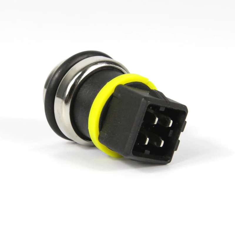

The sensor is located on the thermostat housing. It has a yellow collar.
Water-Coolant-Temp-Temperature-Sensor-Se
Thank You very much. We will check out asap!

Thanks for any help. The sensor has changed and now the car starts without any problems!
