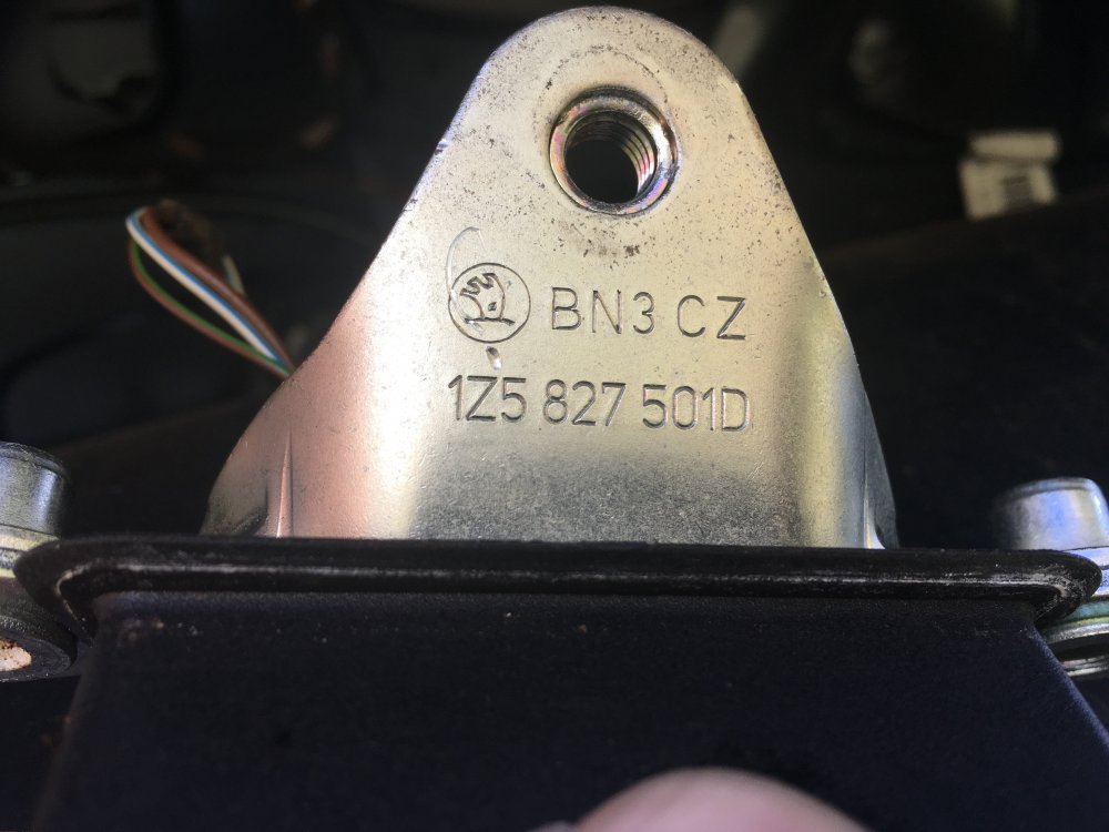

Strangely, I have a problem with mine too and only this morning I have taken mine apart to find the pins that the electrical connector plugs into are all corroded. It's a sealed unit so therefore, whole new catch required. Part number is 1Z5827501D
