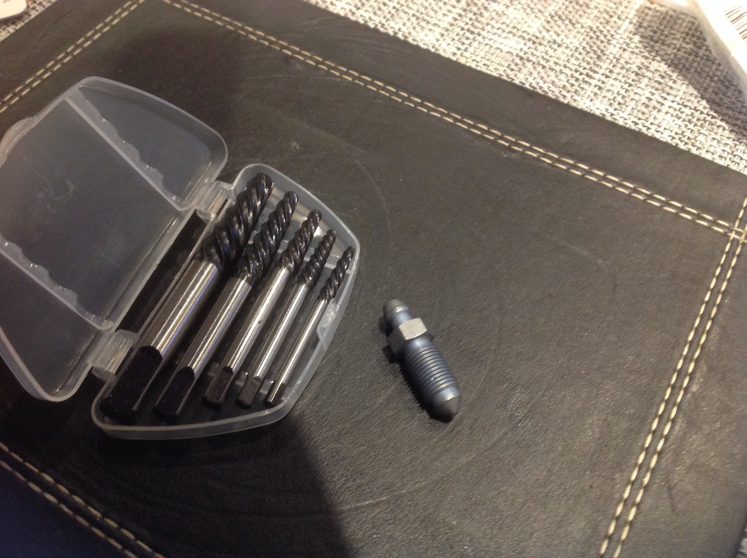

Got the grease nipple at the weekend, so will measure prior to drilling for guide.

after finishing installing both rear drum brake assembly, I was bleeding off the last piston, and with a gentle twisting the bleed valve snapped off. After 10 min of a deep depression, I decided to buy a screw extractor set and made things a lot worse as the extractor snapped off. since it's not leaking I left it like that.
Yes too easy a mistake to make, the usual plan is to buy high quality extractors and use the correct drill size, it is just too easy to buy crap extractors and then finish your luck off by using too small a drill and so use too small/weak an extractor, I think that spartacus68 hinted about that possibility!
Edit:- at least in your case the smart fix for this problem is just a new cylinder - as long as the brake pipe comes off.

Was it a decent extractor tool? Only reason I ask, is that I bought genuine Draper screw extractor tool for £22, but there were generic own-brand ones for sale for £8.

It was a cheap one from Halfords. In fact I took it back and asked for a refund :)
