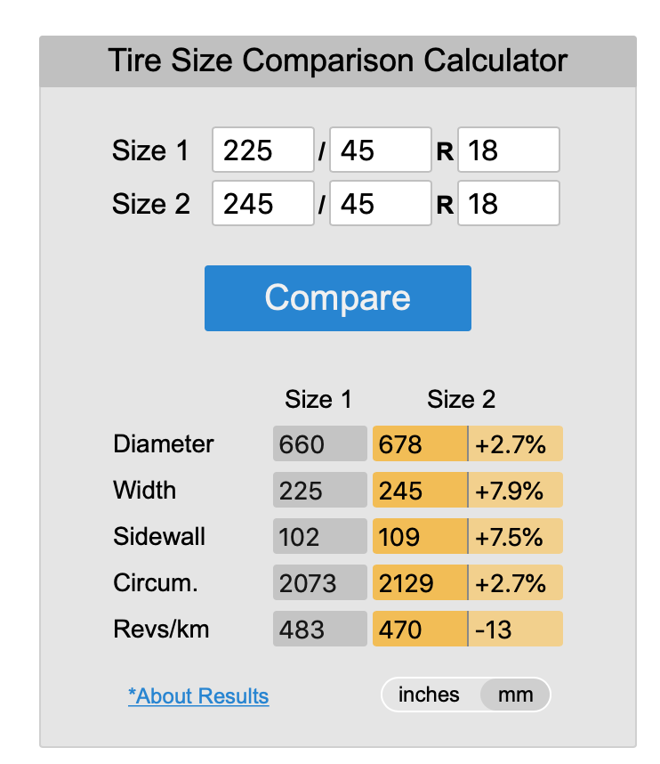

Standard tyre size for Octavia vRS mkII preFL is 225/40-18. Your 225/45-18 has 3.5% bigger circumference (22 mm increased diameter).
Compared to the standard tyre: If you fit 245/45-18, the circumference will be 6.3% bigger circumference and 40 mm increase in diameter. In addition the tyre is 20 mm wider (10 mm closer to both fender and suspension strut).
I don't know the rims specs, but assuming 7.5 inch wide and ET51 (a common Skoda rim). The 245/45 tyres will fit on the rim, but I don't think it will be wise to install them on your car. The tyres are simply so much bigger, it's a high risk that the tyres will rub. The critical point is towards the suspension strut. I also suspect that they will rub at full lock and/or at suspension compression.

Thanks for the feedback guys. I see now that they are a fair bit bigger from the calculators that you posted.
