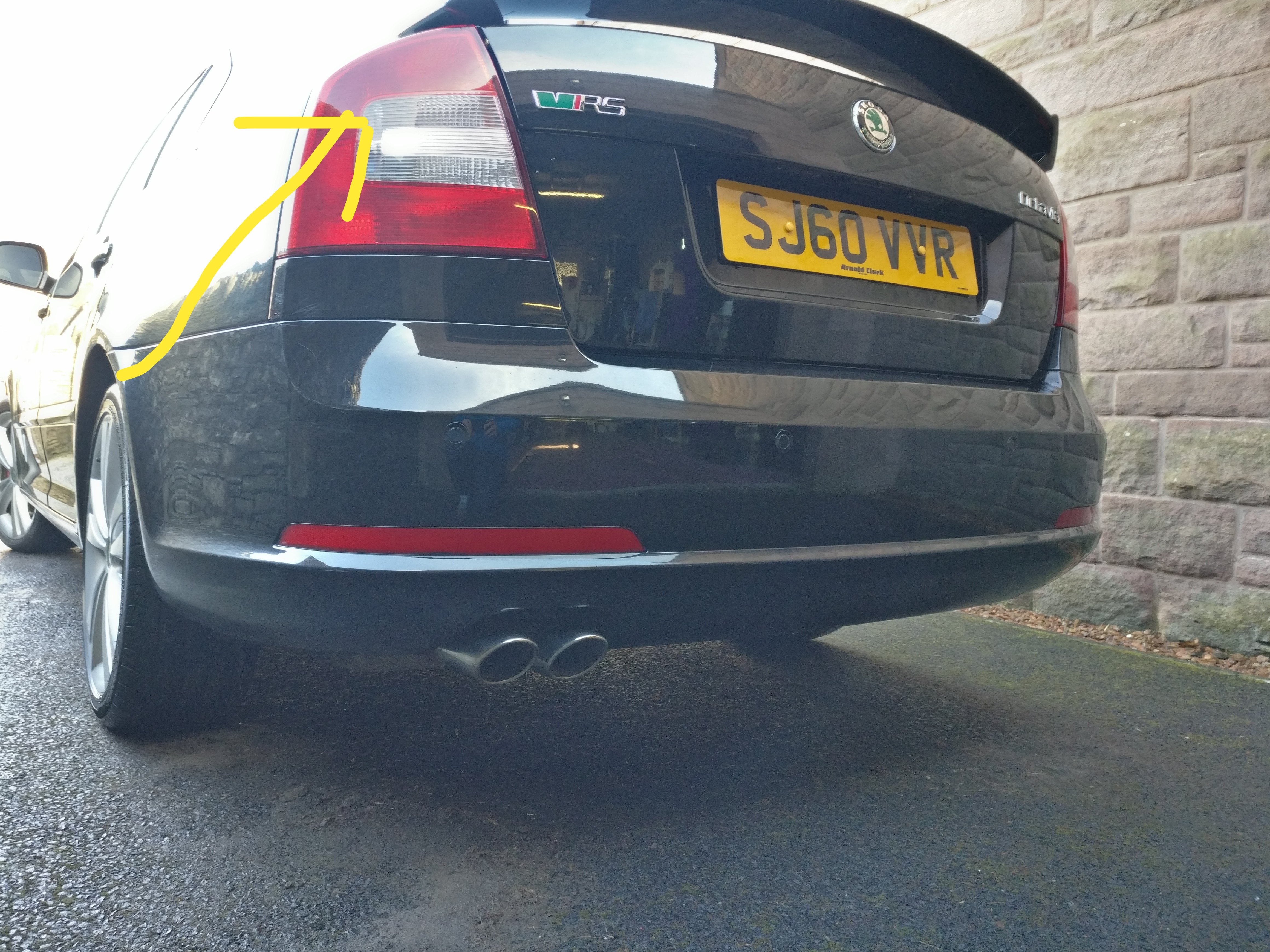

Gonna sound daft but it's not. Honestly. The top left bulb has gone in my passenger side cluster and that bulb doesn't come out with the 4 others. Anyone know how to replace the bulb?

The middle 2 r the indicator and reversing light. It's one of the bulbs on the curve of the 'C' if u know what I mean.
Yes that what I meant - the top and bottom red bulbs are in the main holder, the 2 middle bulbs ( in the C)  are in individual 501 style holders.  They are a funny wattage from memory as when one of mine went the replacement I put in was brighter than the rest.

That's the ones I think. How did u remove the bulb? They don't seem to be that easily accessible.
Right folks. Feeling like a right plum. Went out and had a look at the rear cluster in the daylight and my god that was easy.

Bulbs you need for the parking lights are W3W which are 3 Watt. Your cheap emergency set are probably 5 Watt.
Correct bulbs are readily available from motor factors as well as Amazon.

Cheers. I'm gonna keep the one I have in just now then replace the lot when I get a chance.
