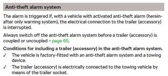

Do you have:
1) Factory fitted tow bar
2) Factory fitted tow bar preparation
3) Aftermarket tow bar
The only reference I can see in the manual on the effects of LED trailer lights is related to the operation of the anti-theft alarm...
