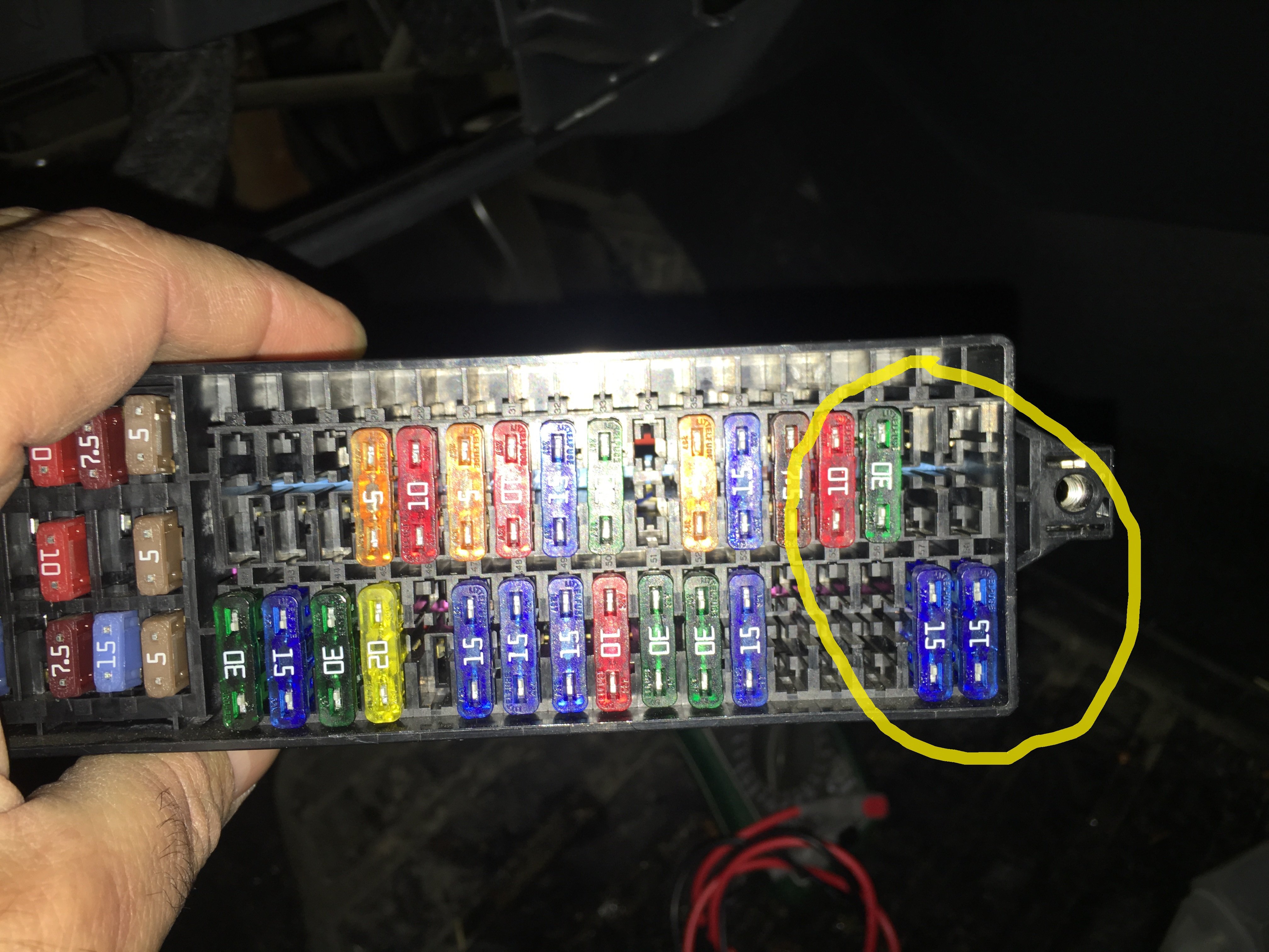

I have a problem with the front lights on the car, all the lights of the position have stopped working, neither daylight, no short or long light. Rear lights work. I found that the fuses that are rounded up in the picture have no voltage,
when someone would help, or instructed where to find a scheme

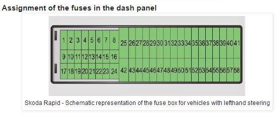

Try looking at fuse 14 ( Headlight beam control )
36 Main beam
38 Fog lights
and that all the feeds into the fuse panel are firmly connected. This feels like a supply issue to the fuse panel rather than a combination of light circuits suddenly being faulty.
If searching for similar problems, short light = dipped beam, long light = main beam.
57 and 58 are dipped beam left and right.  Srećno!

I did not write well, there are no problems with the fuses, today I checked the main light switch (which does not get the voltage) and the Ignition lock, and there are still nothing. Something is a problem either with relays or some contact. today I noticed that the fan in the cabin does not work
From the first wiring diagram I have found, it looks like the fuse box is supplied by a 73 pin connector (T73c)  from J519 (Onboard supply control unit). These have been known to fail in other VW group cars. But start with a check of the connectors at the J519 and the fusebox.
As well as the fan in the cabin, you may well find other electrical circuits are now not working. If you go through all the electrical functions in your car, a list of all of the circuits which are now not working will help the auto electrician find the point of failure.
