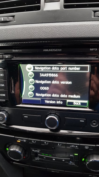

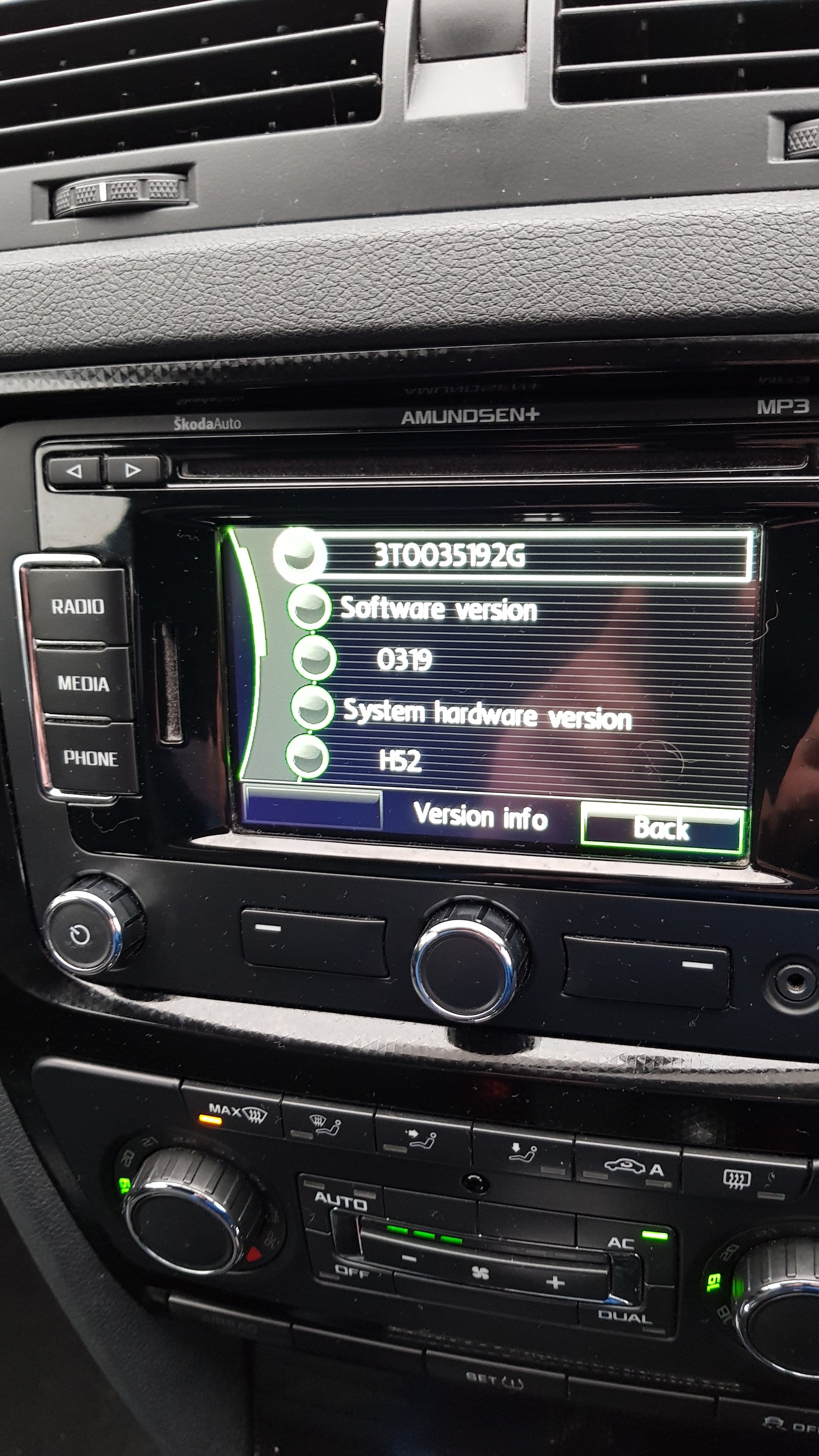

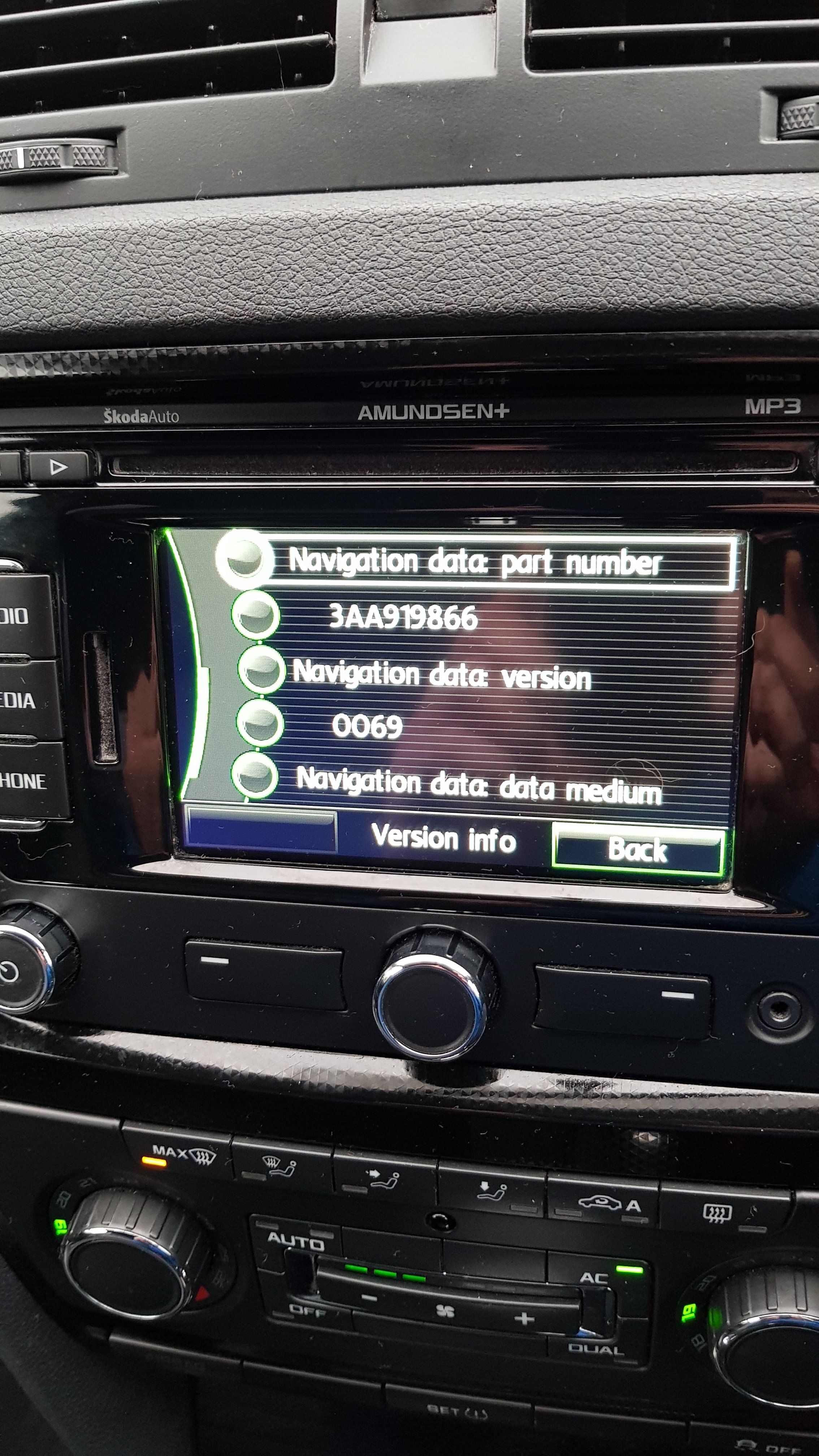

When I put sd card in, it took about an hour to download, I did hold down the set up button and the was 5 different lines.
Versions
These pictures are after the download after pressing the version buttton
That all seems correct as V9 maps are 0069.
