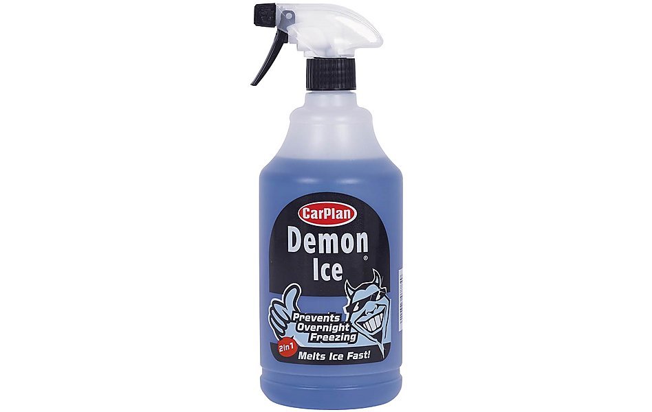

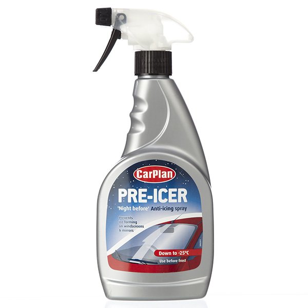

Night before de-icer on the glass, or clear the ice / frost before starting car and putting on the rear heated screen or front one.
