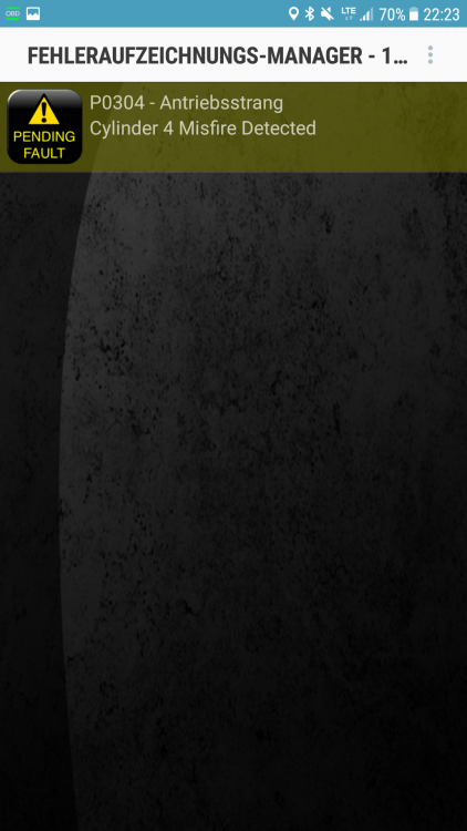

Then I read out the error with Torque - see attachment.
I found all sorts of horror messages. No compression, burned exhaust valves, etc.
There was also a post saying that injectors could be misplaced. Would be plausible because it justament occurred after the almost-empty-running.

Further finding: The error does not migrate with, if I replace the spark plug 4 with SP 3, or if I replace the ignition coil 4 with the number 3. So with every combination the error of Posting 1 P0304 Missfire Zyl. 4th

It's really as if in Cyl. 4 simply no mixture is generated. There is nothing injected. Not even if I delete the error and start again.
