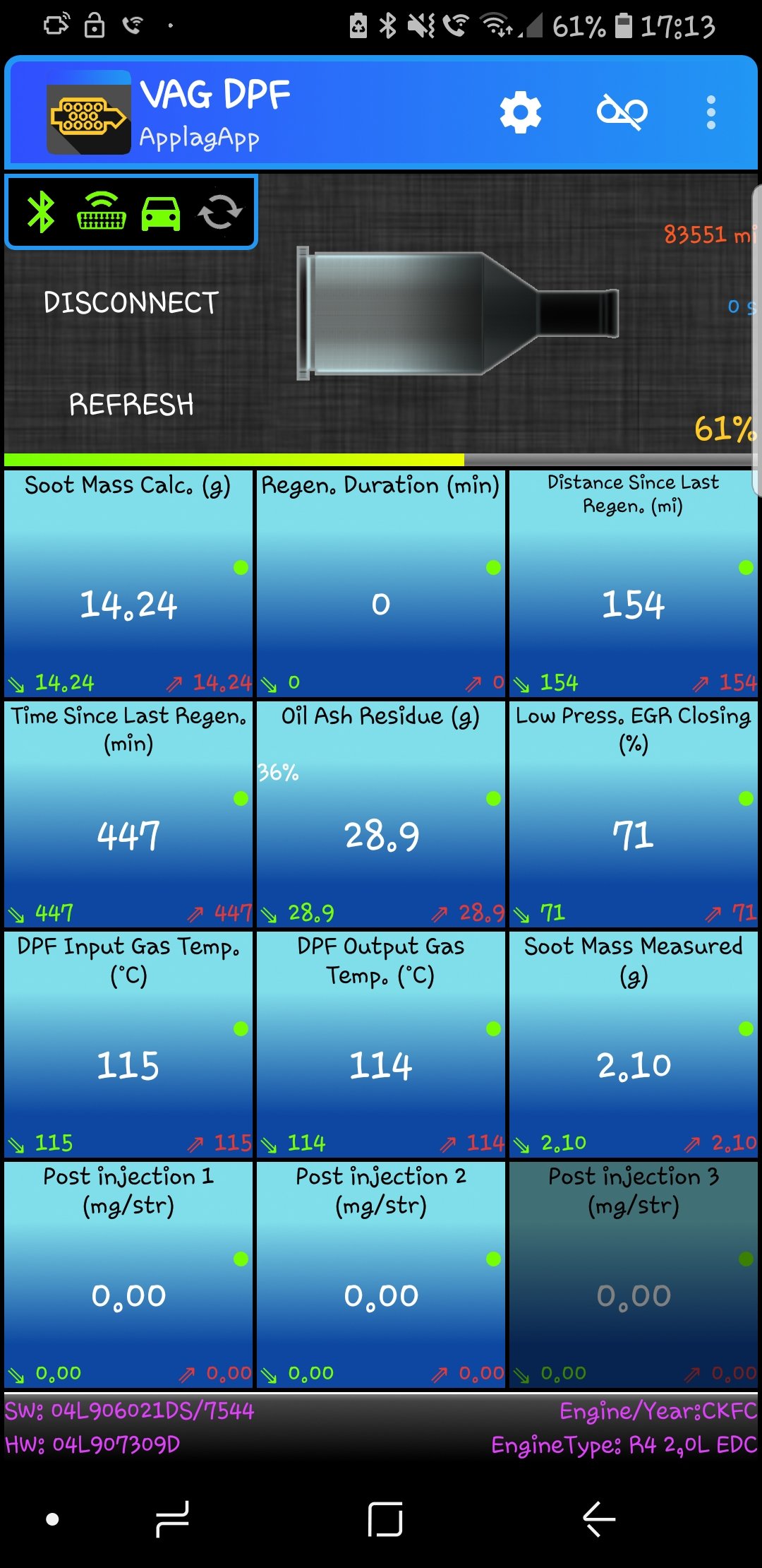

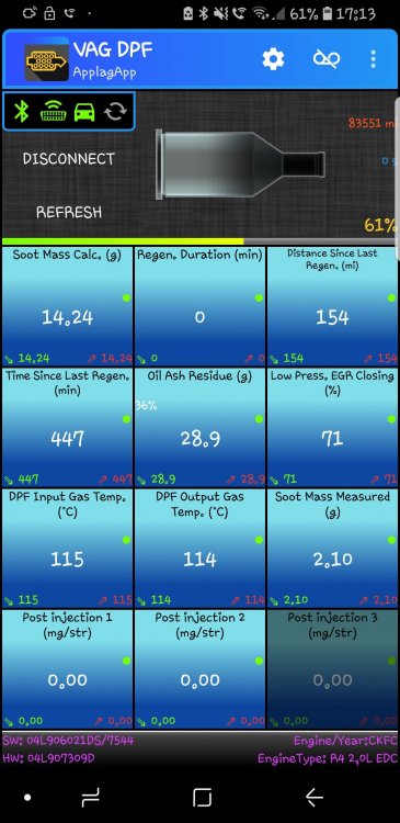

I know this subject gets done to death but after having to replace the water pump last week I'd lost a little confidence in my car and then started to doubt other things like what condition the DPF is in.
Got myself a dongle and paid for the vag dpf app to see what's what. Only read it whilst stationary but from what I can see it looks reasonably healthy?
36% after 83k miles looks pretty much normal compared to mine and others I've seen

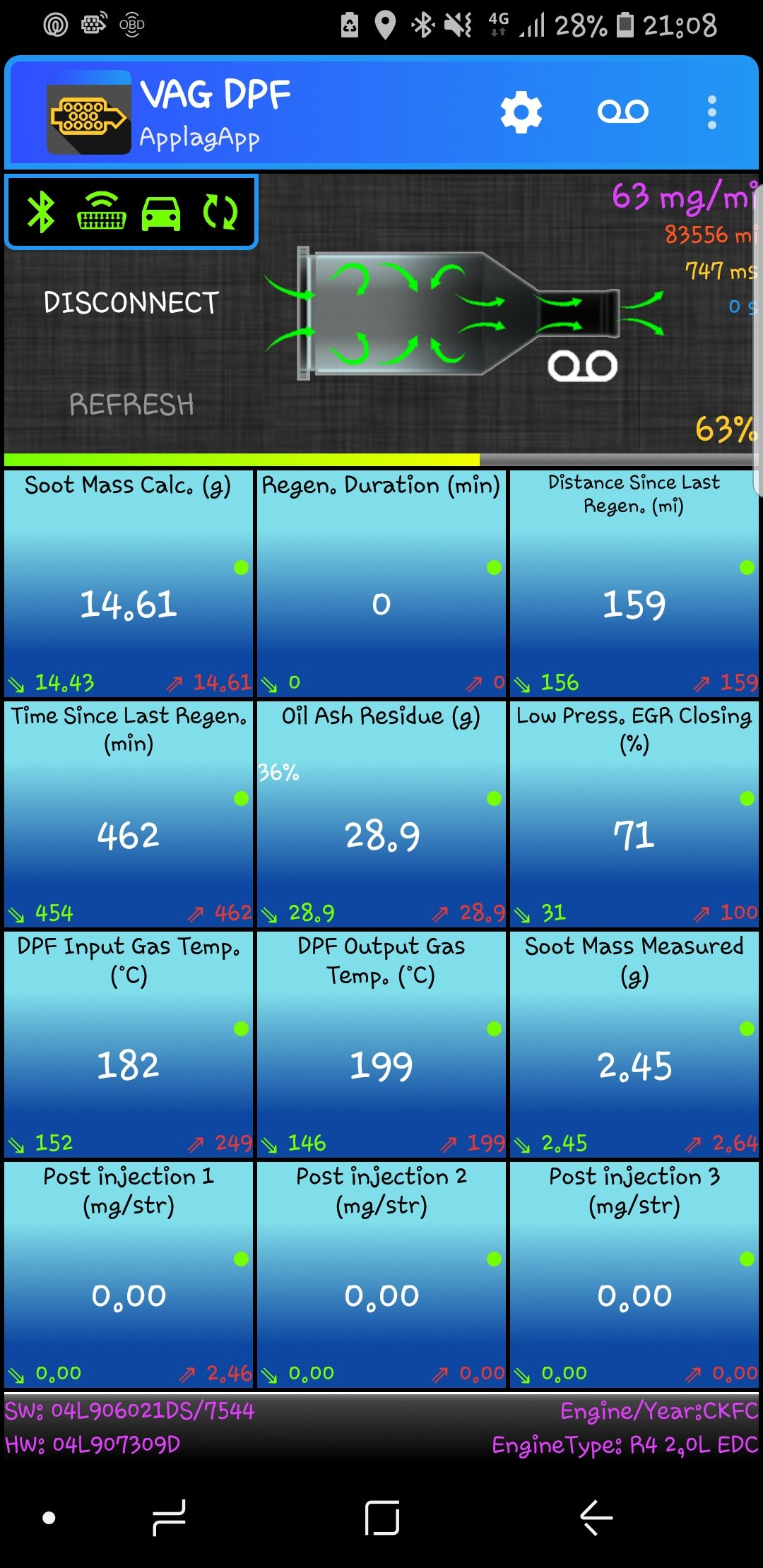

Also got this one once I'd had a little drive
That's about right.  If I recall, I'm on 30g oil ash residue at 81k miles driven.
(same engine)
As long as DPF isn't blocked, it is regen correctly. The Oil ash value is most important value, it is essentially the life of DPF before it need to be replaced.

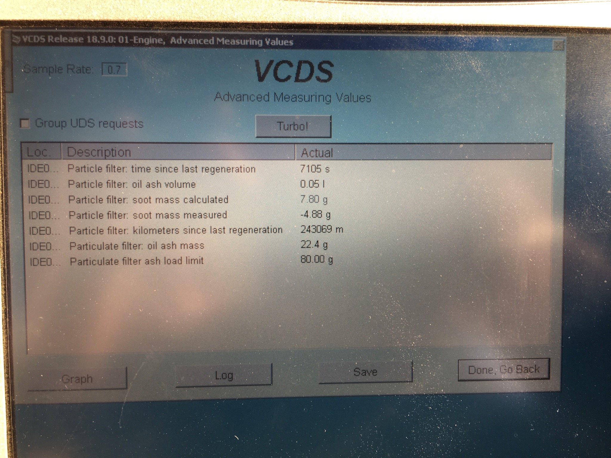

Mine after 94tkm
