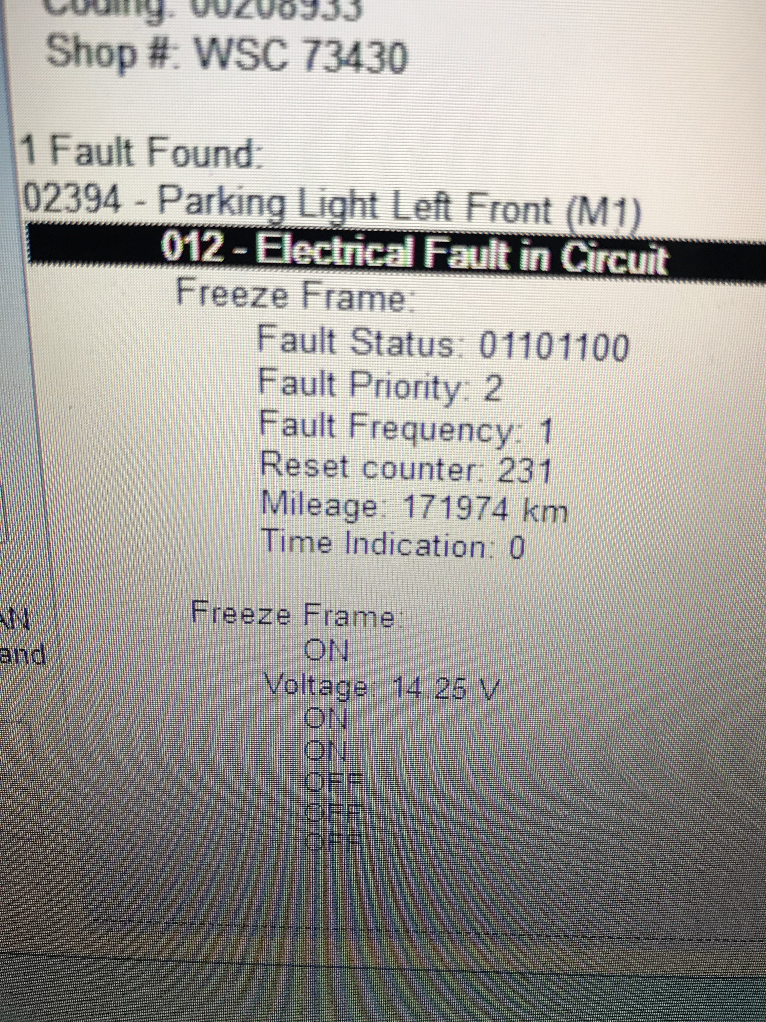

I scanned car with vcds and get this ,
seems fault in circuit ,, anybidea where to common place for falure would be to start looking ? 785203BD-E8A6-4CF8-854A-3E5730CB89F9.thumb.jpeg.3e8ea02fdcc296e2fe6772258555c031.jpeg
Edited by alesypalsy
The fault lists 'Parking Light Left Front' not headlamp bulb?

Just like to update to my problem , it seems the bulbs had both blown and I put a LED bulb in and it’s all good now ,
thanks for the advice
It was my side light, looking at the car from front it was bulb top right corner above the indicator bulb , small little bulb
